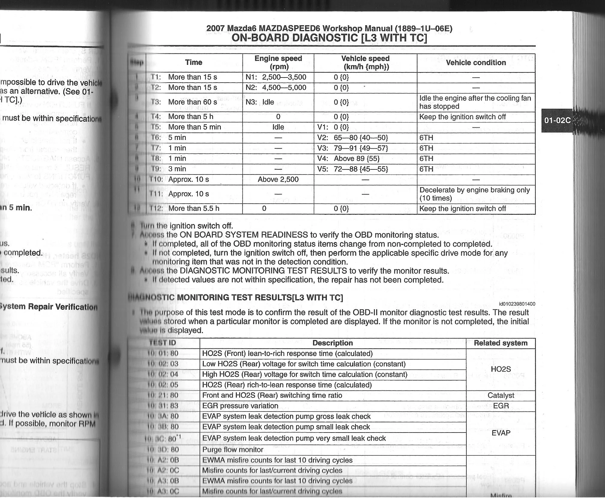

You're all full of s***. THIS is what the ECU needs to see to set all the OBD monitors to "Ready" so it will pass.

Hmmm, the process for completing the drive cycles for the OBD monitors is solidly proven and works for ALL, repeat ALL, OBD monitored cars in the USA, so in your case you likely either didn't complete the process or you have a poorly functioning cat. Note that the MILES traveled has NOTHING to do with the OBD monitors completing...

so what am I focusing on in the picture? 5.5 H of driving or it sitting without being on? i'm not real sure what i'm looking at here man. Thanks for all this input in advance btw, but I need a road trip if i'm going to get 5.5 hours of driving in these less then 2 weeks.

DOH!!!!! Well yeah! LOL You're just messin' with me! (yes) That could have just a little effect on it! The monitor expects a certain response from the cat(rear O2) to determine that it is "ready" to perform. It may indeed not set a code and remain "incomplete" for"ever". :D
You need to read and follow the sequence of timed events for the quickest outcome. Once again, READ the attachment and note that you don't DRIVE for 5+ hours, the car must sit OFF for the period of time.
