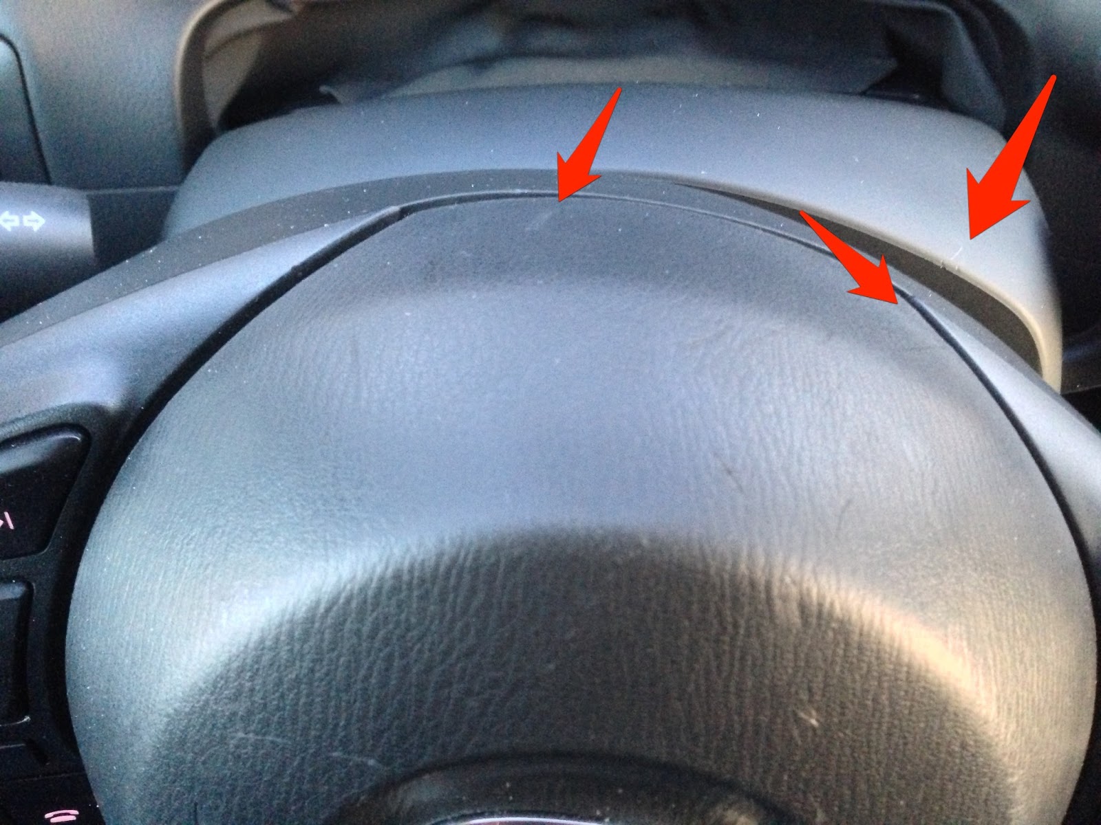

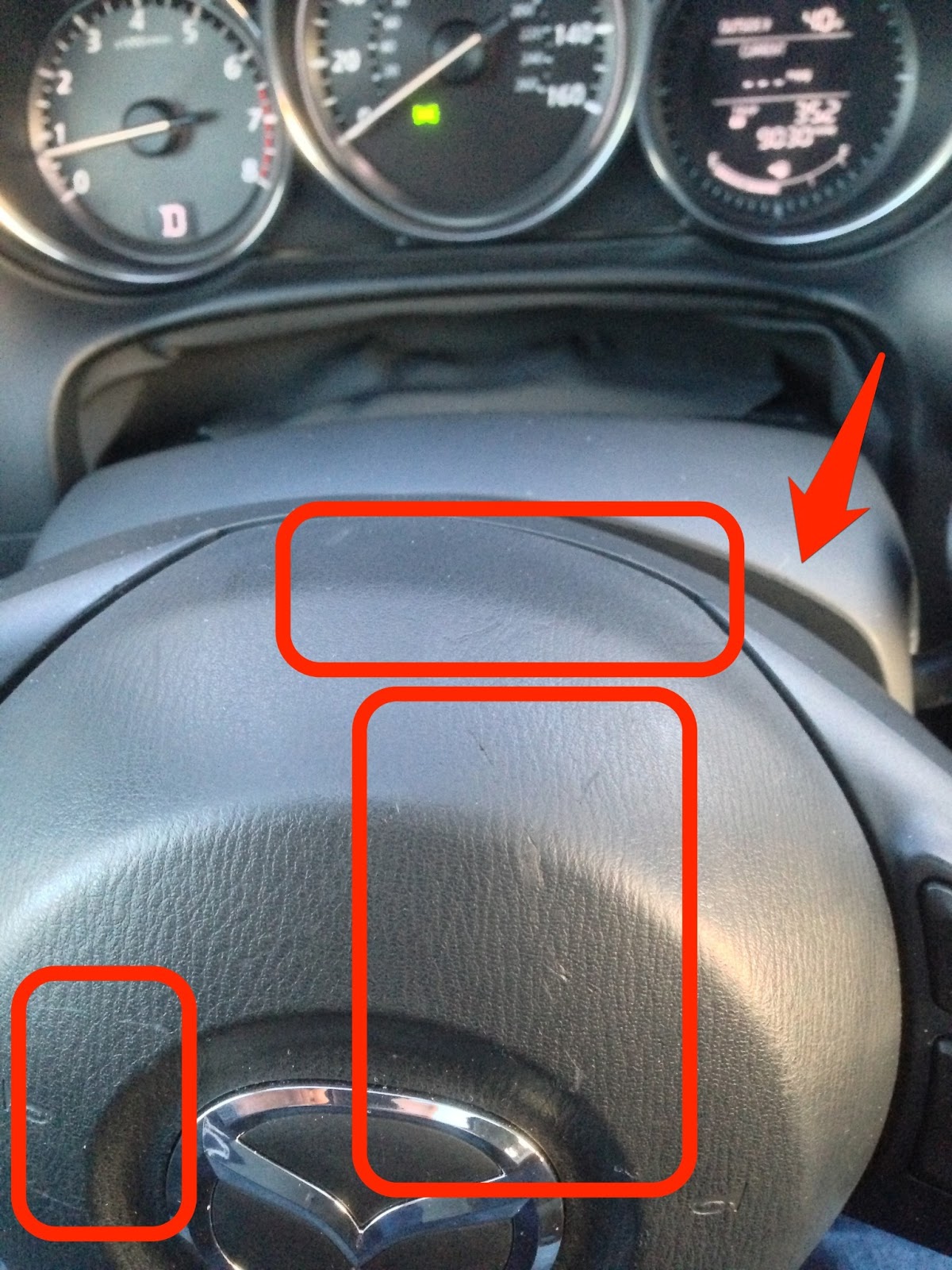

And while it was in the shop, they gouged the hell out of my steering wheel and steering column.
