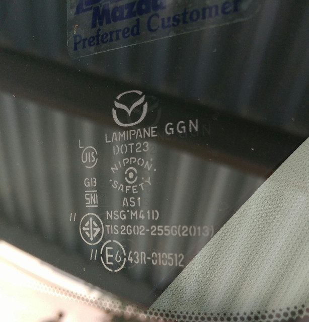

I could use help attaining an image of the label on a windshield that is installed on a 2017 CX-5 with Active Driving Display and the lane assist cameras. If you have this car, could you snap a picture and post it in the thread?

I suspect the Safelite techs didn't specify the windshield with the ADD support and thus it's blurry. I would really like to have evidence of what the factory installed vs what Safelite is installing so I can avoid yet another go around with them.

mine is 2018. hope this helps.
Mine is '17 GT.
It is almost exact the same as the '18 posted above except for the line "TIS ....."
Mine does that show that line.
Other than that, exactly the same.
Just FYI.
mine also has the in-windshield heater elements for the wipers if it matters.
p.s. Ive read another post somewhere for safelite not using Mazda OEM and issues with HUD, etc. they ordered mazda oem and case was solved.
see if this helps.

Yes that helps, thanks for posting that link.
