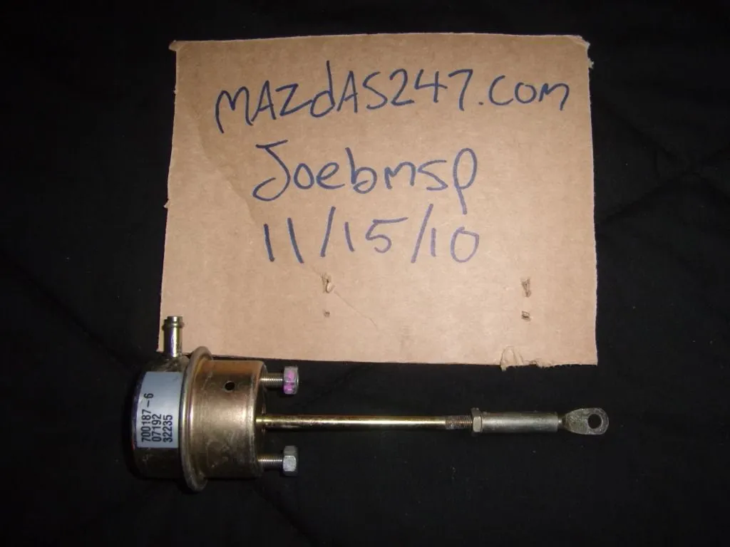

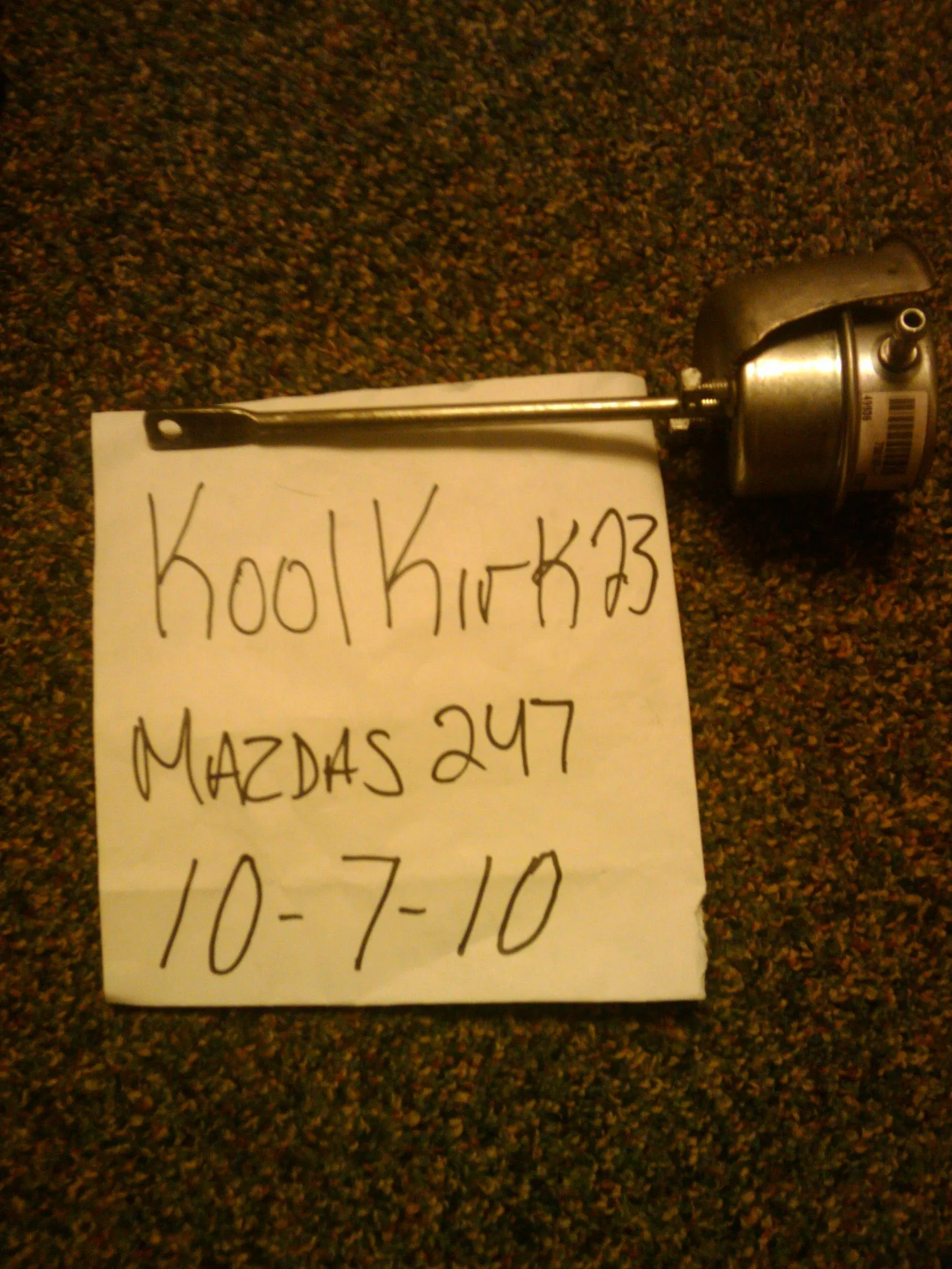

K. so Im tire of my car hitting 8psi n getting fuel cuts b/c of my W.G, Im looking for a W.G but the one that the MSPs bring from factory that boost only 4-5psi. Please tell me how can I identify them incase I see one forsale on the forums like:

But can someone tell from the pics above which of the two is an origal factory W.G or how to identify them?
Can't tell from the 2nd pic but the 1st pic is of a factory WGA. I replaced my stocker with a Forge and I love it because it's adjustable (although it's set to stock). Pull off the vacuum line running to the WGA and blow into it. If it passes any air the wastegate needs to be replaced.
