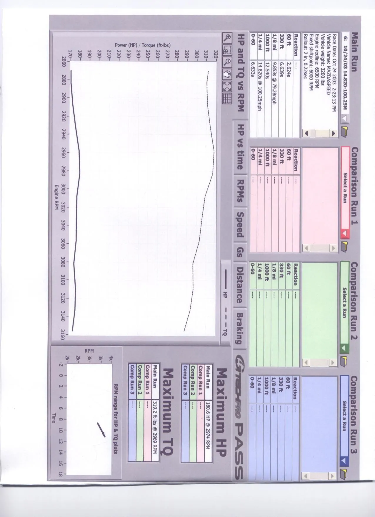

how much was your escort g-timer? looking to buy one for a friend. but can it hook up to a pc with graghs and compare multiple runs like the g-tech pro?
does the gtec come with all the necessary accessories to hook it up to a computer? the cheapest escort I found was $106 on froogle.com and the cheapest bel I found was $144 to get the revisions of these that hook up to the computer, the prices were $179 and $204
