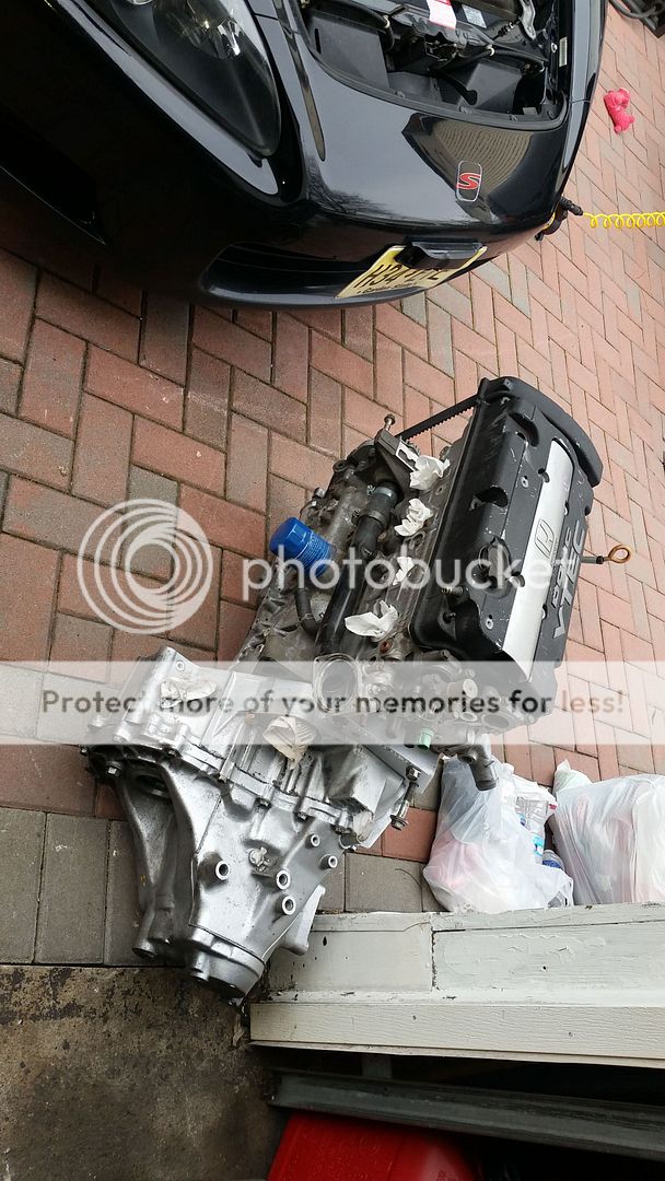

F/h2b plateless
S2k staring down another F
Test fitting the motor

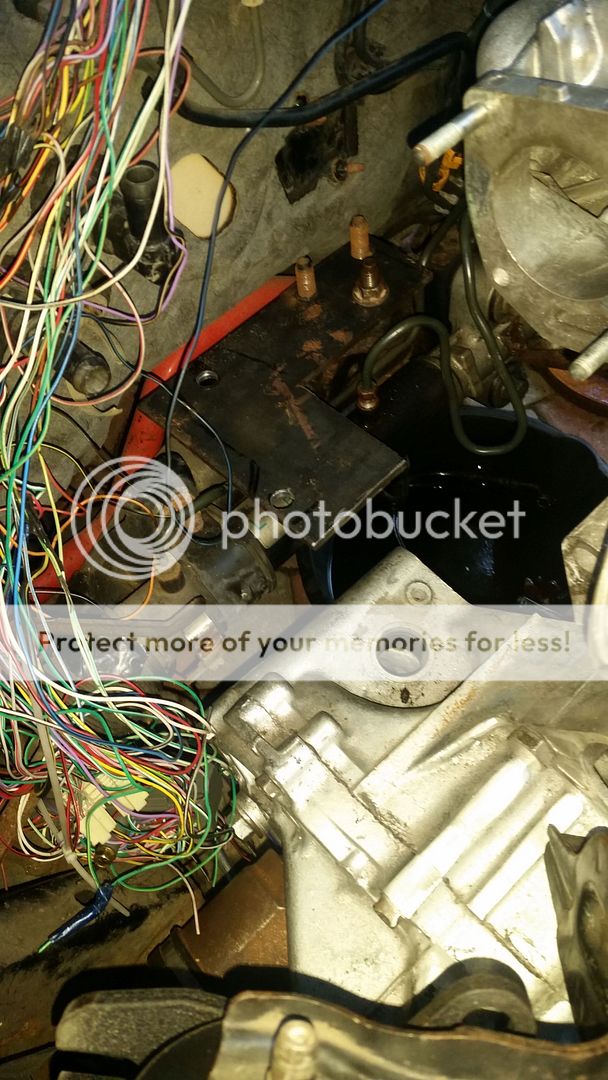

The original engine harness that got cut out.

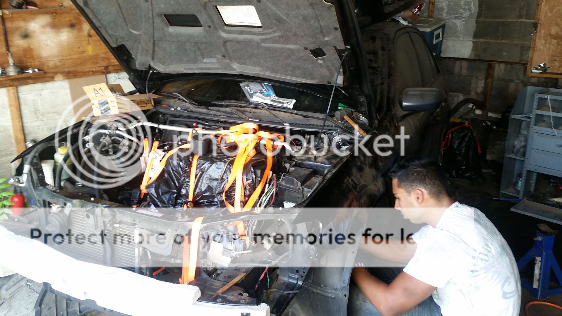

Strapping the motor down. At this point we need to move the car to my home garage for the fab work.

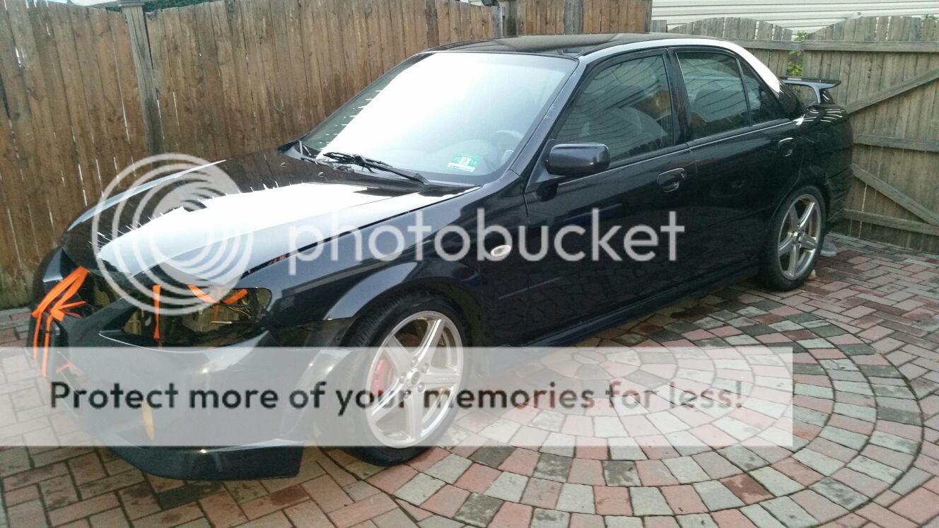

Dirty girl
She looks good with a quick wash after sitting for so long.
More mock up

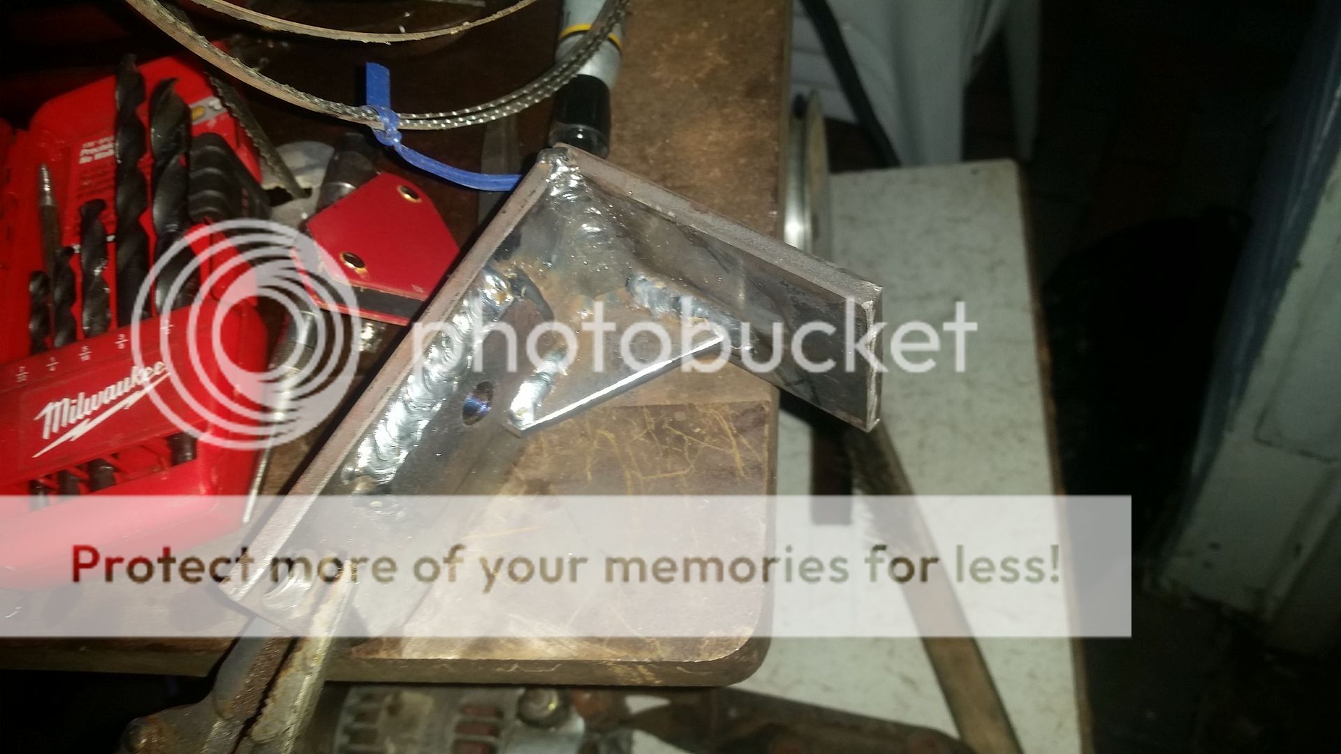

Fab up a new engine bracket.
My approach to building this car has been to treat it like a ek civic. I modified a set of avid steel mounts.

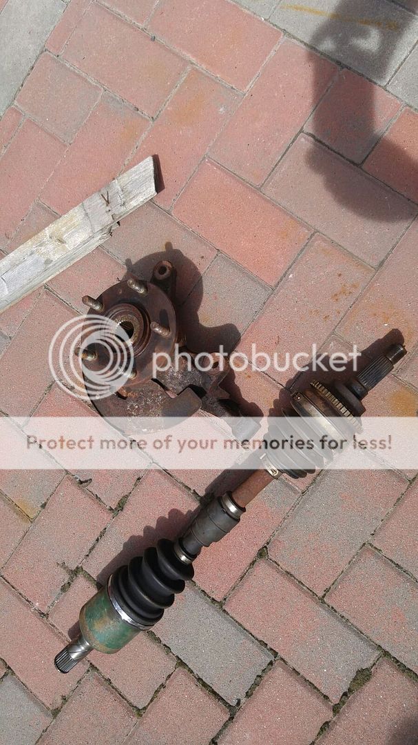

Axle were easier then I could have ever wish for. The other ends are the original MSP and the rest of the axle is oem b-series.
Rear mount needed to be moved over, nothing some 1/4" steel cant solve.
