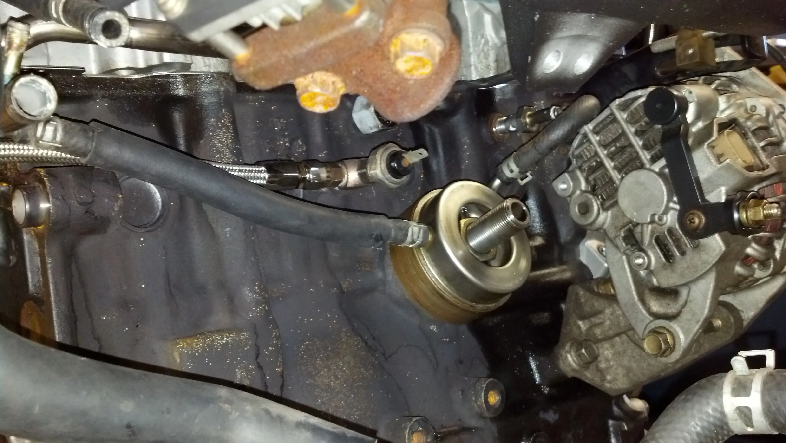

ok my biggest problem at the moment is this, the pipe off the water pump (2 pipes attach to the bas of the water outlet pipe, then run along the front of the block under the head) after it goes around the left side of the motor (drivers side) it splits 3 ways, back, up and right (towards passenger side) now the right face port there is a hose connected that leads right around where the oil filter is, but there is no open connection there, does anyone know where that one hose goes?
would help if you post up pictures also. that way it makes it easier to help
From your description it sounds as if the port you are referring to would attach to the Oil filter cooler. The cooler should have two ports itself. one connecting to a banjo type bolt with an outlet.. the other to the coolant line.
that picture just saved me a lot of problems thanks alot, that is exactly the hose im talking about, i have it all in and could not get a good look back there =) you da man sir
