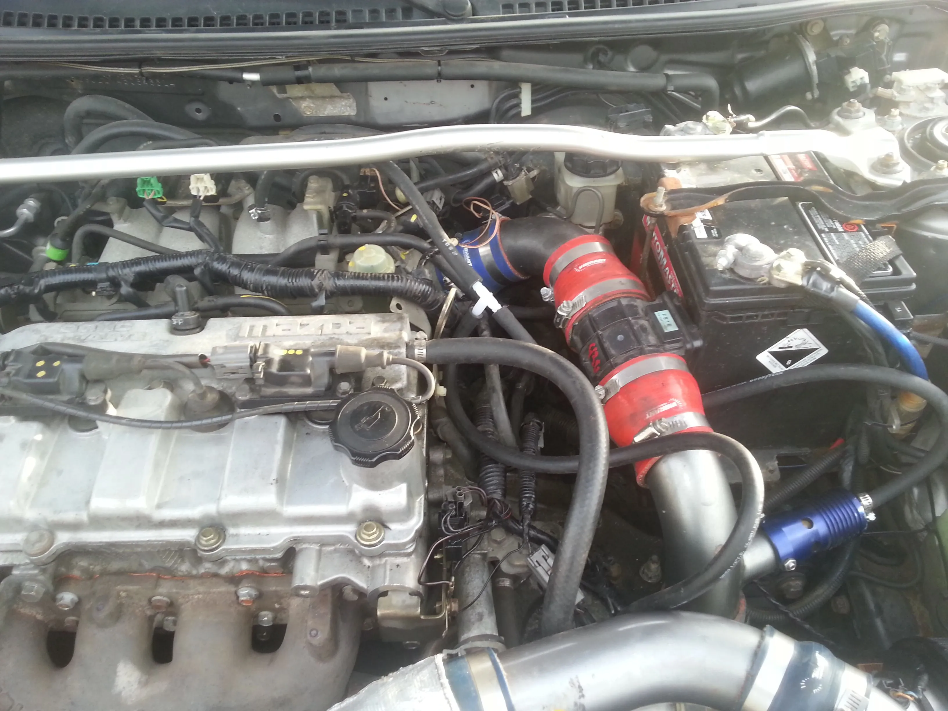

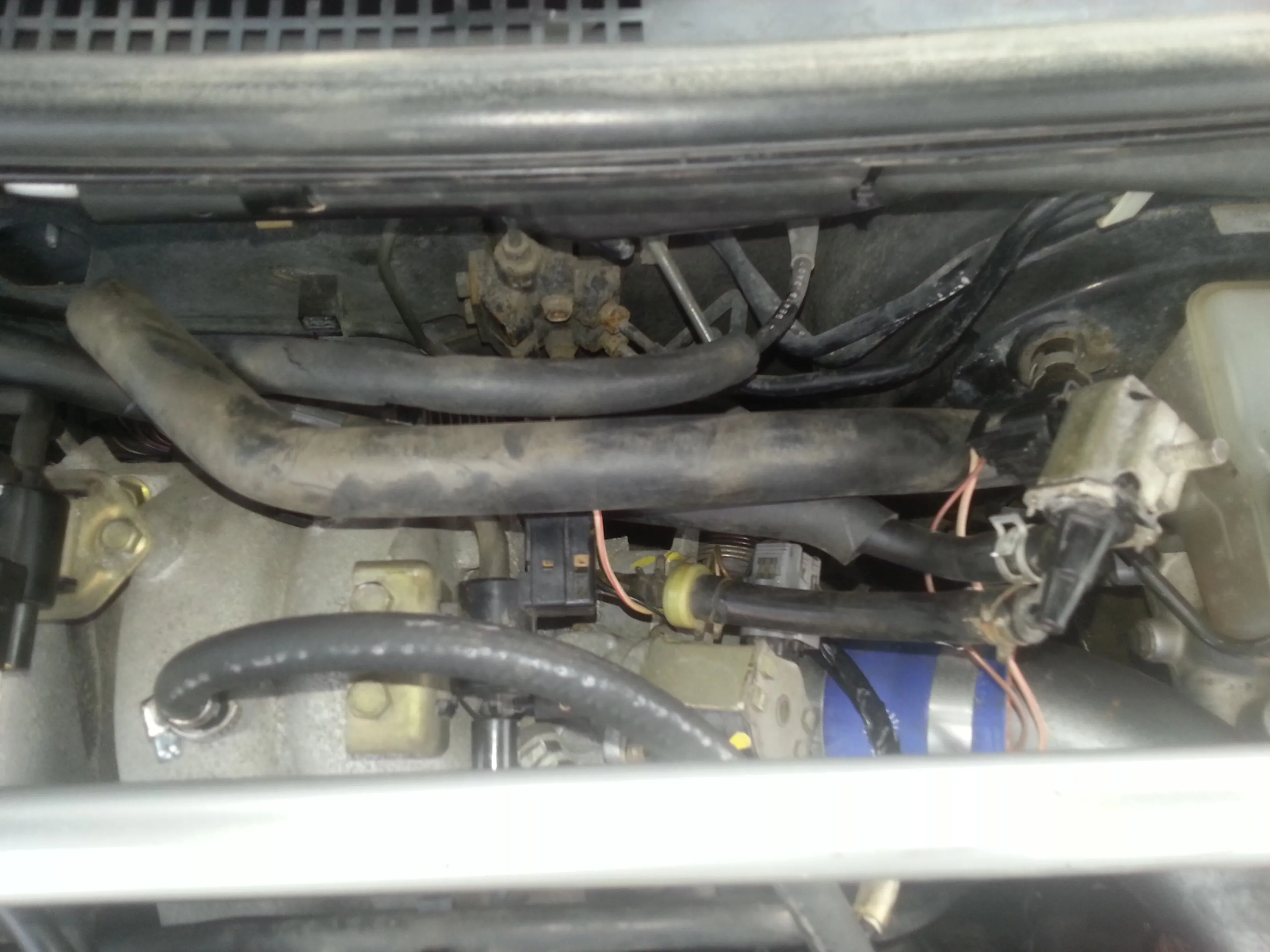

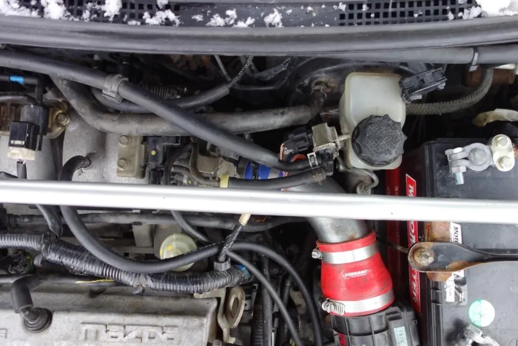

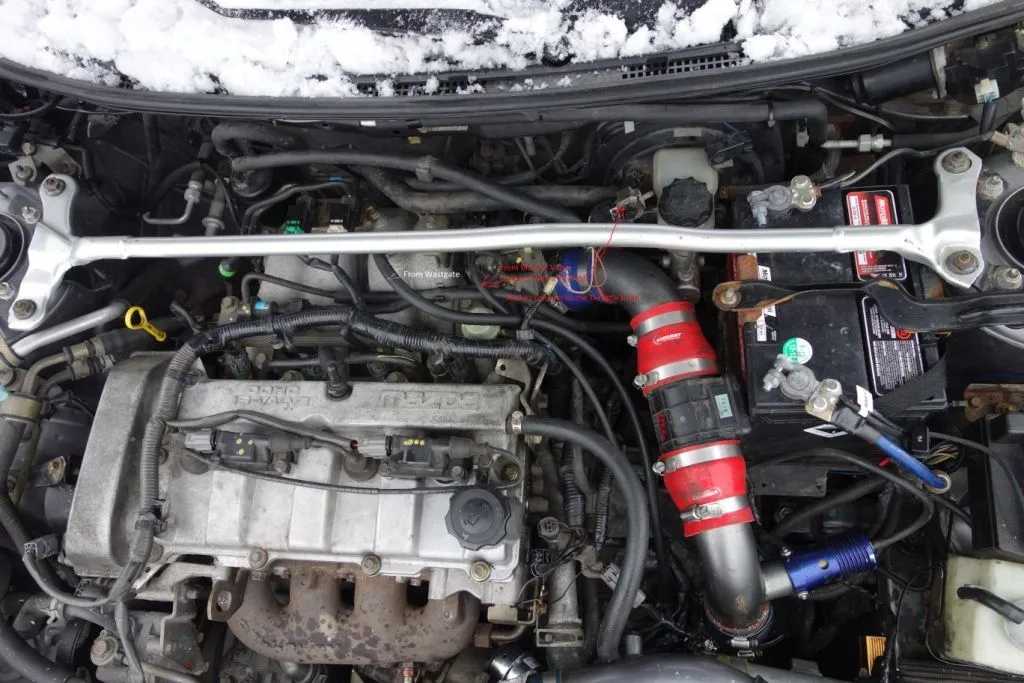

i got an inercoolor and a blow off valve but the waste-gate i don't know where it goes do any have any pictures of the car engine bay it will be easier that way
There is a vacuum routing diagram under the hood but if you have an MP3 it won't have the turbo setup on it. The stock Wategate actuator (WGA) vacuum line T's off the stock Bypass Valve (BPV) line and runs to a nipple on the top of the intake manifold.
Here is Two Pictures
