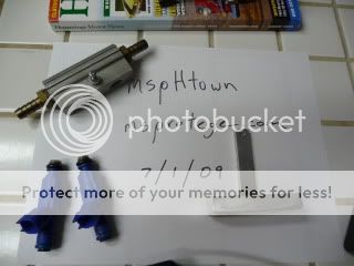

Piggyback engine management setup (The Preferred MPI Setup): 575 shipped
-MPI auxiliary fuel rail (2- 42 lb/hr cobra injectors included)
-MPI Tuner (smt-6 unit) w/ heat sink
-Flyin’ Miata o2 clamp
-JoeP Fuel cut defenser
-GM 3 bar map sensor
-Turbo module (keeps the coils from overheating)
-Project box (cleaner install)

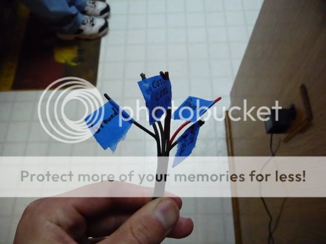

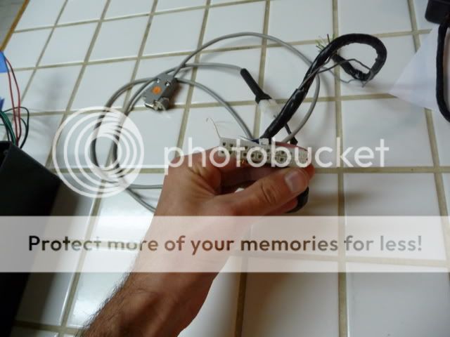

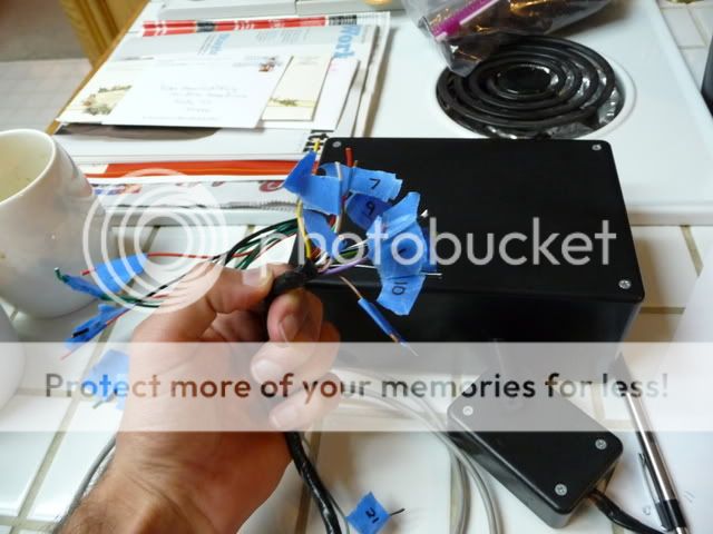

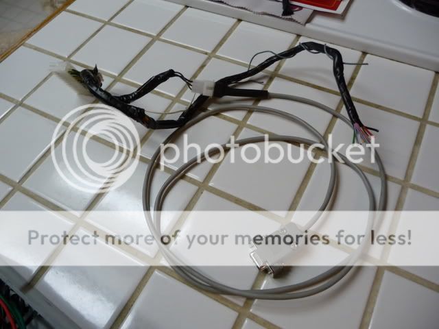

All wires have been taped and labeled for an easier install.

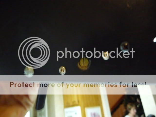

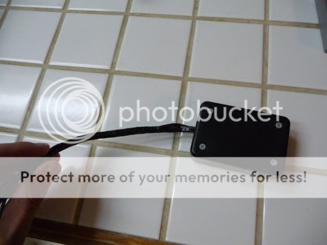

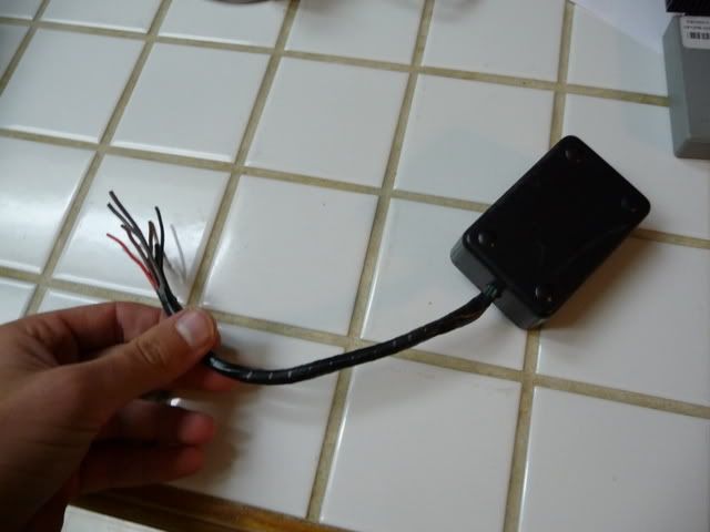

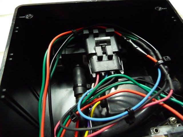

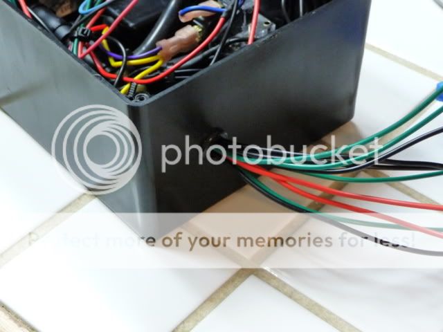

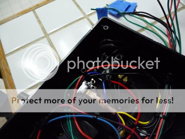

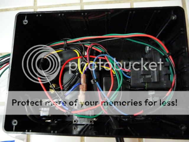

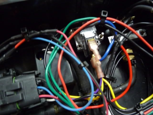

The project box allows for the absolute cleanest way to install the additional components. The o2 clamp, fuel cut defenser, and map sensor are all mounted inside the project box. Holes have been drilled for the wires, vacuum line, and access to adjustment screws. The project box fits nicely under the MSP passenger seat. Further information about the project box, complete install directions, and a detailed outline for this form of tuning is in my tuning thread.

-MPI auxiliary fuel rail (2- 42 lb/hr cobra injectors included): 250 shipped
The auxiliary fuel rail has served me well and has been leak free. The rail holds two 42 lb/hr cobra injectors (“blue giants”) that have a wide cone spray pattern, which is great for pre-throttle body setups.

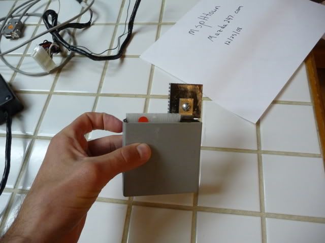

-MPI Tuner (smt-6 unit and turbo module) w/ heat sink: 375 shipped
Again, I recommend running the “preferred setup.”
-Flyin’ Miata o2 clamp: 100 shipped
-JoeP Fuel cut defenser: 65 shipped
-GM 3 bar map sensor w/ connector plug: 70 shipped

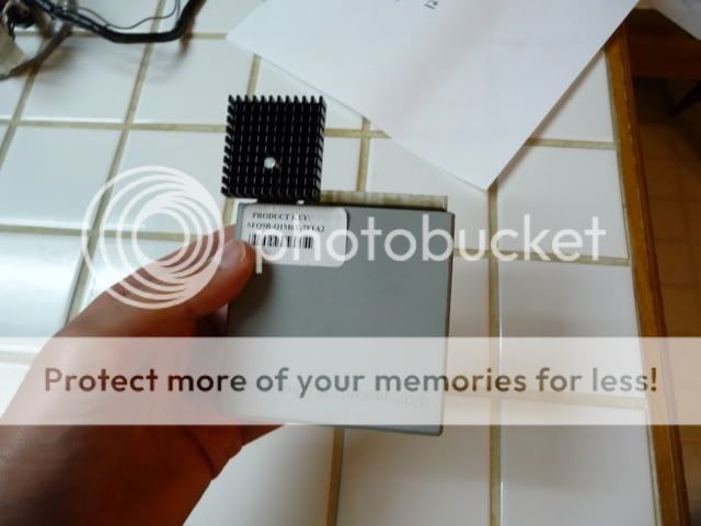

I took several pictures awhile ago, but the first two have updated dates to comply with the forum rules:

The mpi tuner is a rebadeged SMT-6 ecu made by Perfect Power. Modern performance inc, MPI, added a "turbo module" to the setup. The turbo module has changed several times and i cannot tell you which one is newest. One turbo module contains an o2 clamp, another turbo module contains just relays, etc...
I do not recommend running the MPI TUNER in the fashion that MPI would recommend. Look up Kooldino (owner of speedcircuit.net) and admin on this forum. MPI is located near Kooldinos shop and he would have to fix all of the issues that MPI users had coming out of MPI's shop. Kooldino would change the MPI setup to the "preferred" setup.
With the "preferred" setup, you do not control the stock injectors. You can adjust the o2 clamp so a different amount of fuel is sprayed when it is triggered, but that is all of the control you will have on the stock injectors. When the o2 clamp triggers, it does not "dump max fuel." You trigger the o2 clamp right before you leave vacuum and enter positive pressure. You then add fuel with the extra injectors.
With this setup, the car has stock drivability everywhere its important. You dont have cold start up issues, you dont have emissions issues, you dont have to retune all of the vacuum maps, you dont have to worry about the stock injectors.
Please make sure you read the the thread i wrote up to make sure this is what you want. For a piggyback, i believe this is the best solution. But to each their own. If you have any more questions just let me know.
