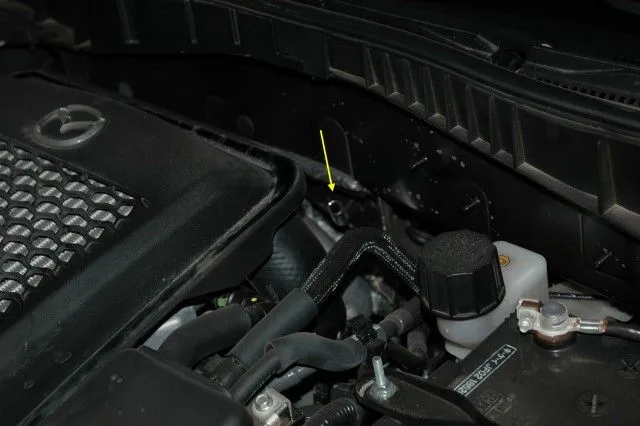

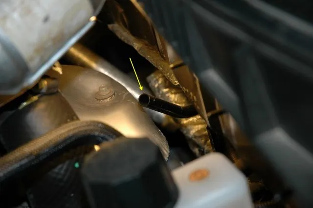

The bad news is that in doing my quickie engine bay review when I got home, I see what appears to be a dipstick tube without a dipstick in it (see pictures, yellow arrow pointing at empty tube). The manuals don't seem to address this tube (at least I haven't found a reference to it yet).
Can somebody review these two pix (one general and one zoomed in) and the n check their 2007 MSM6 6-speed manual trans model and let me know if this tube is supposed to be empty (I doubt it, but what do I know).

Well, the good news is the dealer didn't just confirm my diagnostic assessment as they said they wanted to do, they actually fixed the cause of the CEL by replacing P/N L3Y2-20-170 "Runner Control Actuator" at no charge. The CEL hasn't lit up since I got the car back Thursday night, and its been through enough start/stop cycles now that it would have if it were still an issue.
I don't know what that is, but it should be empty. Mine never had anything in it either. The dipstick for your oil is in front of the TMIC. Oh and all Mazdaspeed 6s are 6 speed manuals.
Thanks for the comments, Hate.
Yup, I know the oil dipstick is at the front of the engine (kind of hard to miss with its canary yellow handle in the midst of all that black stuff)... because the tube sort of heads down into the transmission tunnel, I thought it might be something to do with the wet transaxle or something.
And I only stated "6 speed manual" to make it unmistakably clear that I don't have a one-off custom automatic MS6, or anything weird like that, 'cause it does sort of look like an auto-trans fluid dipstick tube.
If that tube is supposed to be open like it is, it could be a breather pipe or pressure equalizer tube for something. Its hard to believe a tube like that is to be left open for crap and dust and dirt and misguided bumblebees to get into, tho.
Anyway, I sent the two pictures to the service manager at my dealer's and asked him the same questions - I'll post what he tells me just to close off my part of this thread.
The service manager at my dealer's called back to say (as you stated, Hate) that the tube is designed to be left empty and unplugged, as pictured.
Apparently its purpose is to provide an access route for a tiny camera on a flexible stalk down into the workings of something in the transmission tunnel. How high tech can you get? :D
