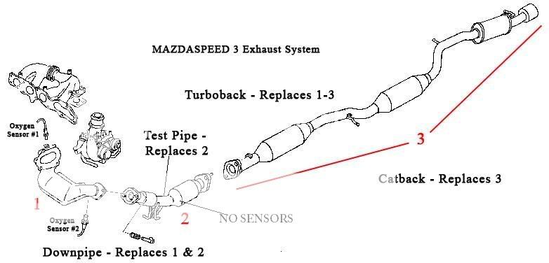

Looks like there are many cheap testpipes out there on eBay.. My question is if i were to slap one on, removing the second cat, what issues will occure? I'm not too familier with this car's electronics/emessions/sensors etc. Could someone enlighten me? I know the catless DP will throw CELs and im not lookin for any headache like that at the moment.
As far as i know there no sensors on the second cat. So installing a test pipe will not through any CEL. The install will have to be a good fit if not it will leak. This pic is also for the MS6
Test pipe will not throw any CELs. All it will do is make your exhaust a bit louder.
The 2nd cat has no o2 sensor in it so it will not throw a code. Issues you need to look out for is fittament and what its made of... Not worth it to save a few bucks and it rusts out in a year... Also keep in mind the smoking turbo issue usally rears its ugly head after you do the test pipe mod....

Hey thanks guys! Im gonna snatch up a test pipe then and see how it goes. Ill report back in this thread with results! What do you guys think for gains? Obviously minimal but 1-2hp? Nicer revs?

A lot of test pipe fabricators will tell you "20whp gain". You should note that this is at most a 20whp peak gain. The gains across the rev band will probably be between 8-14whp. It is a noticeable difference, but not groundbreaking.
Not to mention the improvement in spool up of the turbo due to the reduced back pressure.
can you just slap a down pipe on a stock MS6 or are there other mods required before doing this??
You can, but I would recommend getting a catted one. The turbo seems to like it more with a little bit of back pressure, and it helps cut the noise down.
