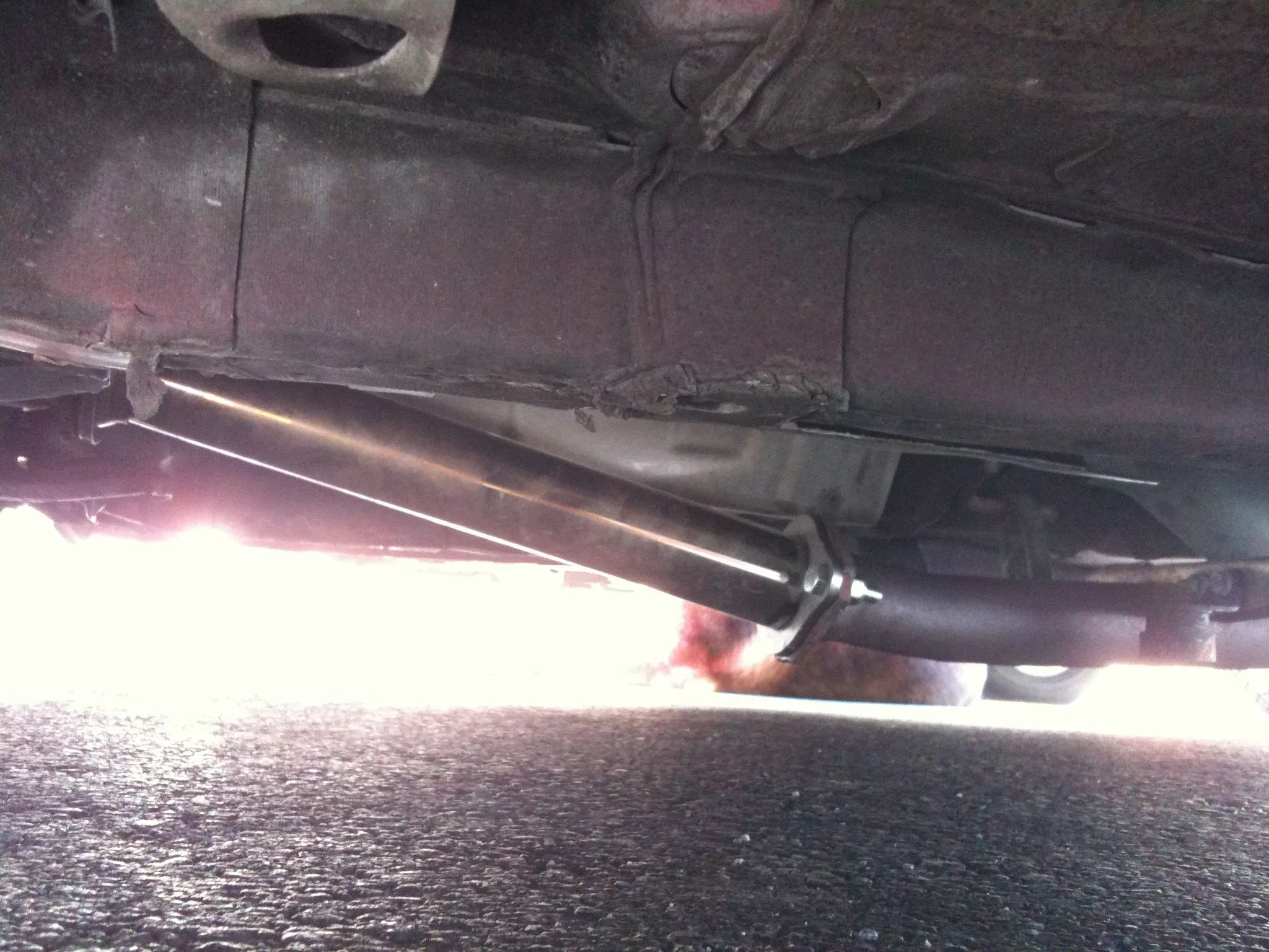

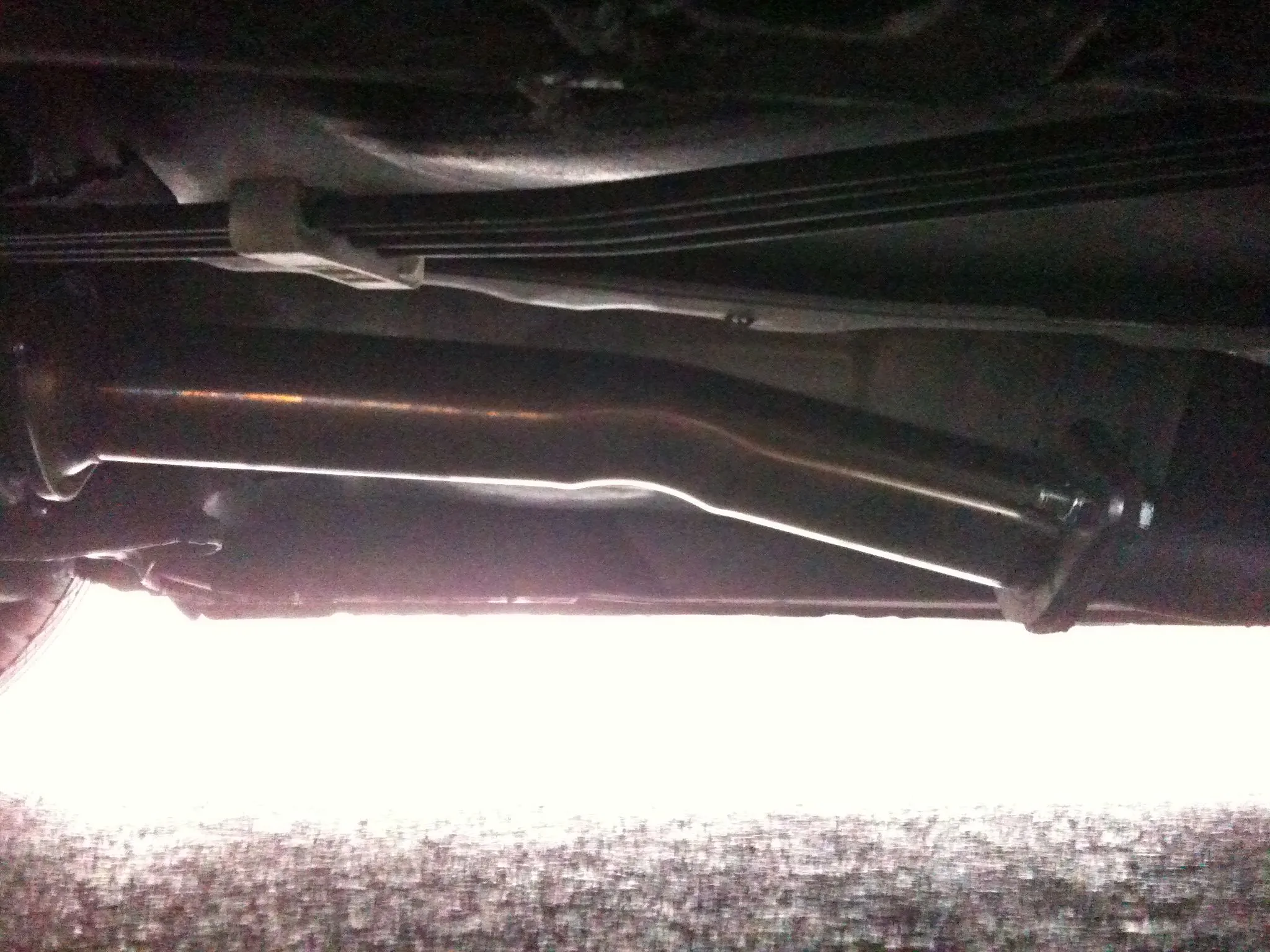

You could always do what I did.
I bought a Street Unit pipe and had to get it custom bent.
Check it out.
Here is a before and after.
Before: IMG_0330.webp
After: IMG_0339.webp
