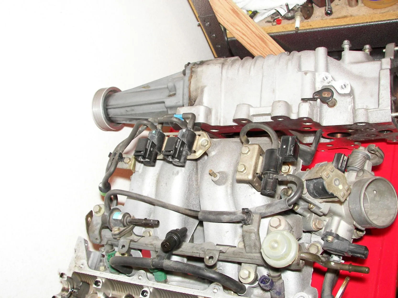

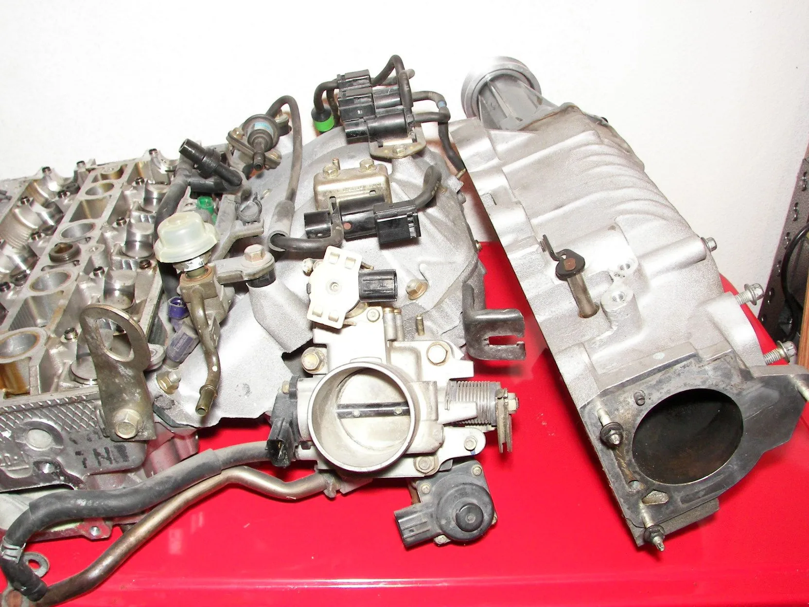

I took a couple of pics with an M90 from a GM L67 next to an FS intake manifold. The height the width would make a good fit, but it's too long. The M62 is a bit shorter, so that'd work better.
There are a variety of M62 input and output configurations. Having the output on top like the t-bird it nice for air-air intercooling. The output on the bottom, like pictured, a liquid-air intercooler would have to be sandwiched in between and there's not much space for that. Intercooling isn't necessary at low boost, but low boost gets old quick, so it's nice to be prepared

Mp90 is a big blower capable of alot of power but also since its so big causes alot of power loss to run it. I have a Mp62 on my tib currently and there is a Mp90 kit for the tib at makes over 300 whp but like I said might not be the best choice for an I4 set up such as the FSDE. Mp90 lets out a sweet loud whine though http://www.youtube.com/watch?v=bqIWJTFB5eE I don't know how much power you are looking for but if it's not too extreme there is always and Mp45 blower which is tiny and easy to run and they are designed for 2.0 cars. http://www.capa.com.au/eaton_mp45_4th.htm
MMM, i like that m90 and i would like it even more if it would fit!, and i think it would if you changed the shaft/belt part of it with a shorter one like the gm3800 nose, i think it might cut it, oh yes that would be oh so tight
wait a tic, after having a second look at the m45 i like it even more!!! that would be much easier to fit and you could still make stupid #s if you did your internals
