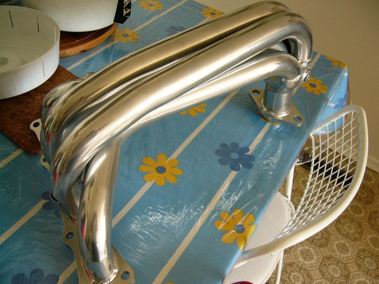

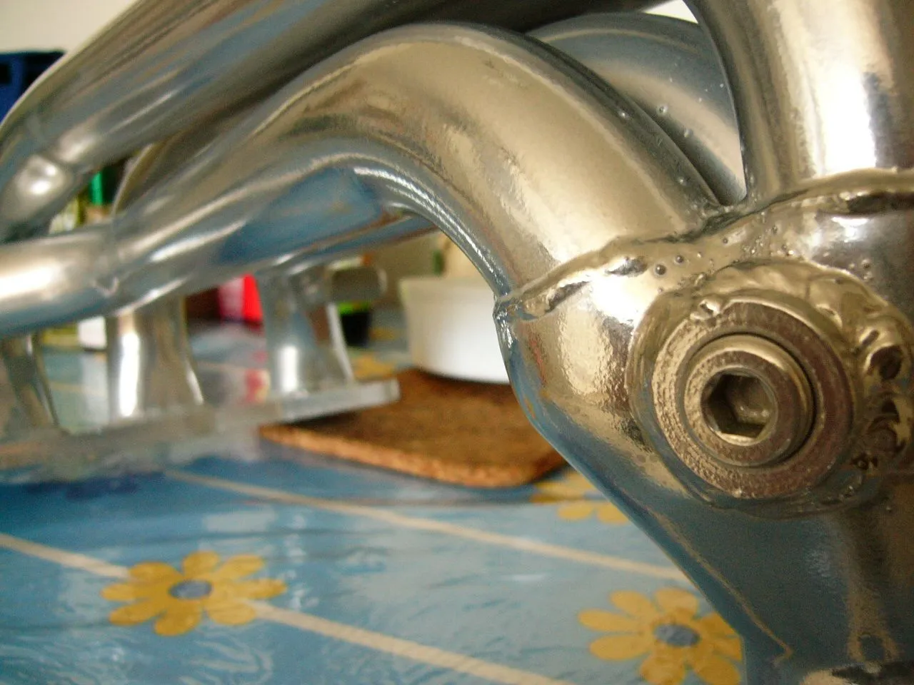

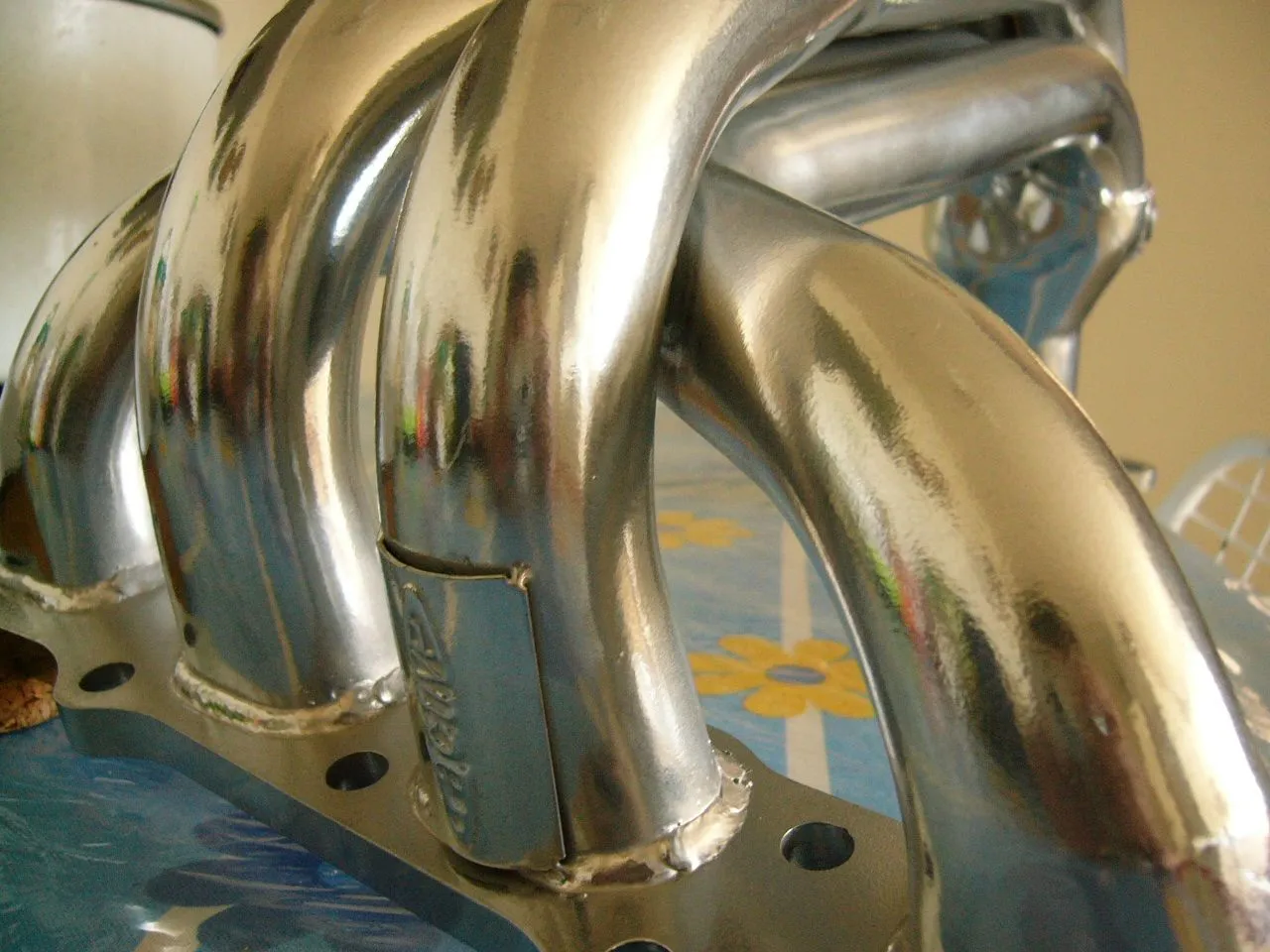

Got my header back this morning! Ceramic coated inside and out too! Paid 160bux. 2nd o2 sensor bung has been welded in as well. :)
Now who wants to help me install this puppy since I don't got a driveway :)
