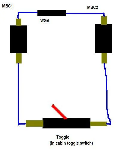

A dual stage MBC is basically 2 MBC, but not configured in this way. A dual stage is just 2 separate MBC's that you can switch between. Paint diagram on the way...
Essentially what a dual stage MBC is
Basically it will be like this for a dual stage MBC made of 2 MBCs (which is probably not a cost effective way of doing things btw)

well from what I've read i thought a dual mbc was sort of like the ebc's that have different boosts for different shifts so that you could get better traction in the first and second gears for things such as drag racing. Basically off the line you would hit about 7psi and then by 2nd gear you'd hit like 15 psi and then not just spin out. no??
no, the dual mbc is controlled by an electronic switch, you'd have to flip a switch in 3rd gear to get the higher boost levels.
You can flip the switch in any gear to activate the second stage of boost. I like my TXS unit. Making sure that your pressure and wastegate lines are free of kinks and as short as necessary can lessen the spike. My boost goes right to were I have it set at in each stage and holds it. Look at the tuning with Unichip, its got a built in spike. My point being that a spike is not necessarily bad. You just don't want any crazy spikes that will cause excessive force on the rods and bolts.
