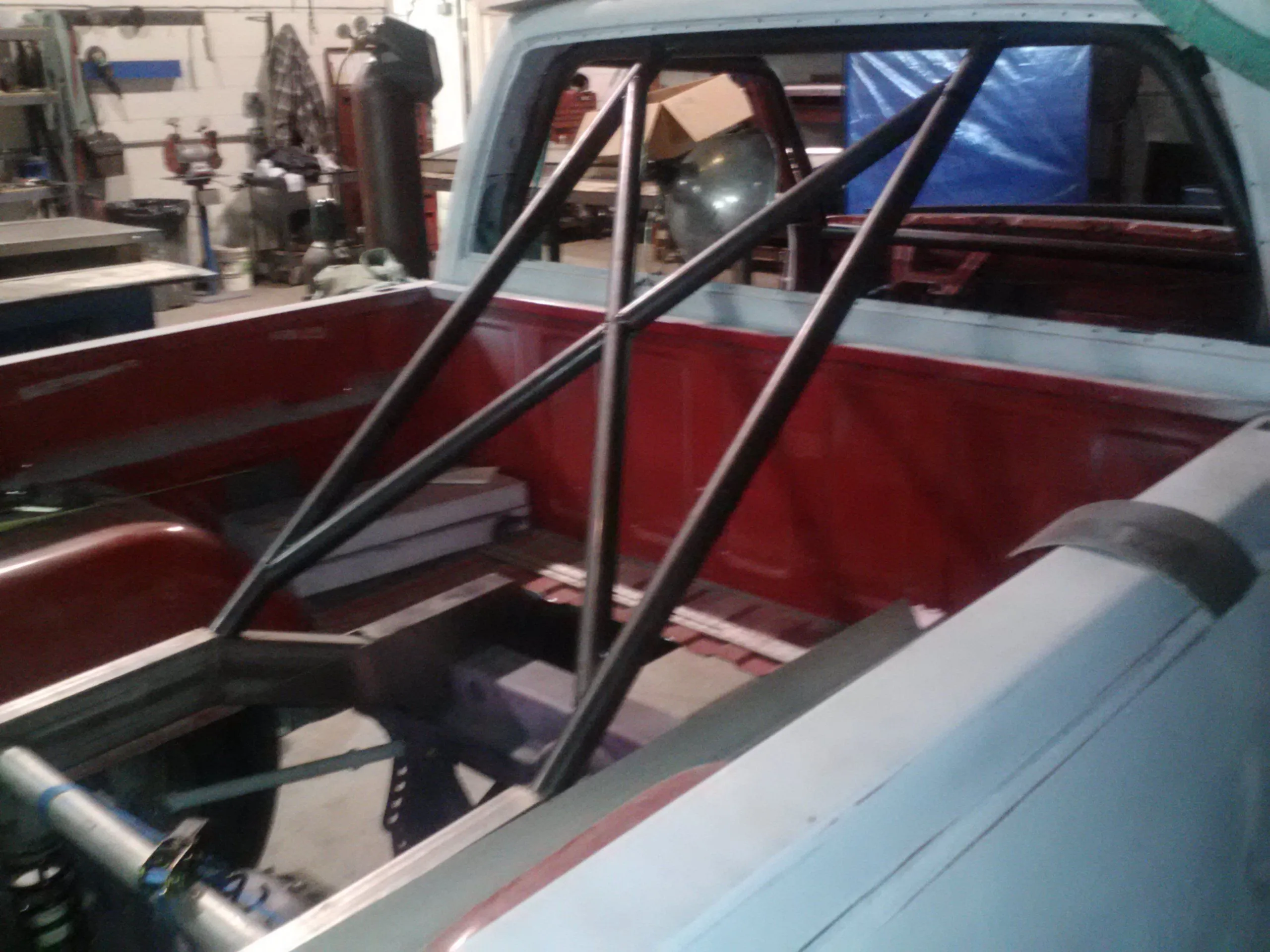

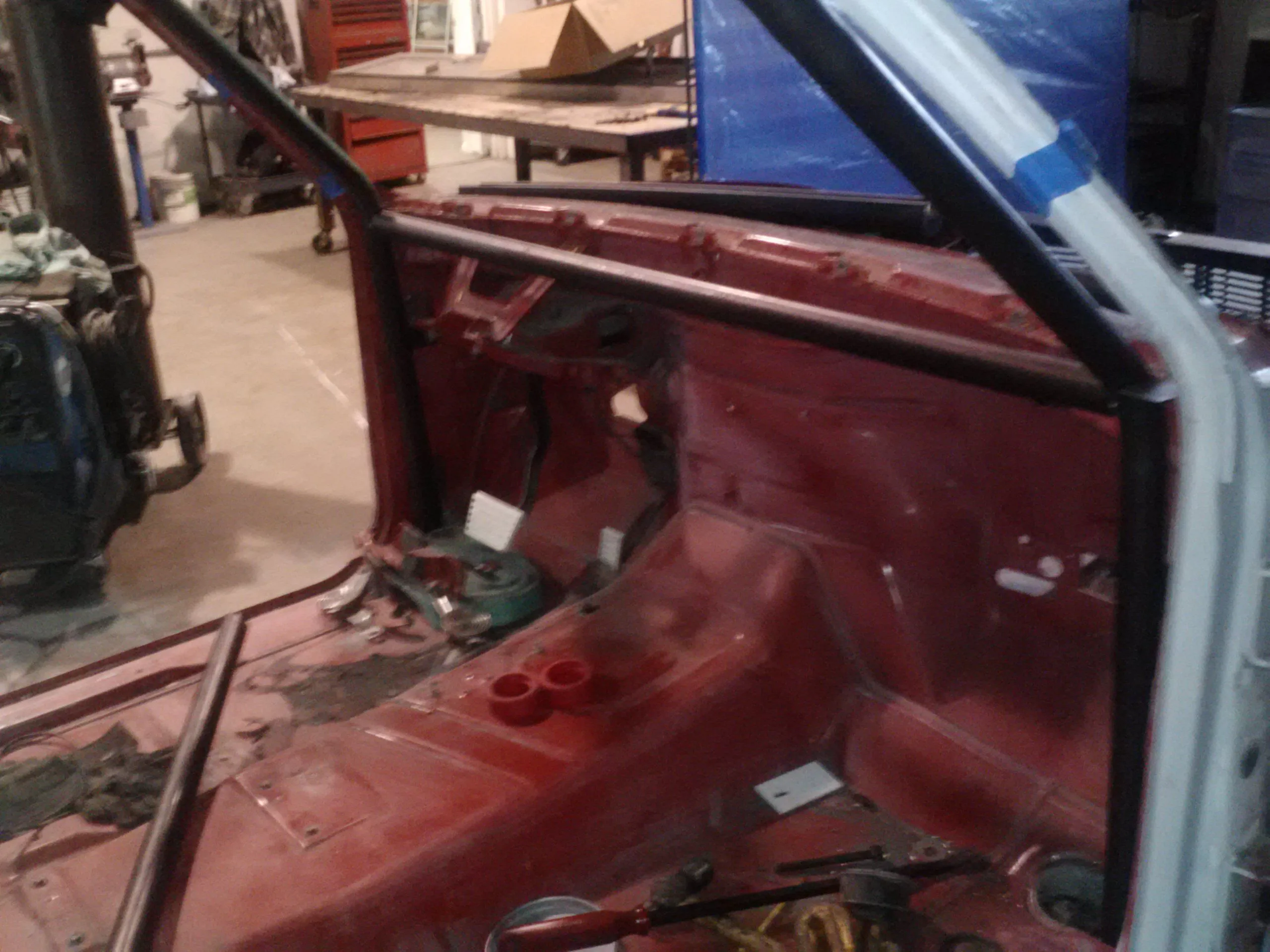

Some roll cage pics. I can tell you that there is no way I'm getting in that truck now. I'm pretty sure the bends will not clear inspection.
Does not look properly built... at all... going to bend and fold up if that thing flips unless they redo it or add more bracing.
I guess that's good. They need to connect the roof-line bars to the main roll bar braces directly.
Honestly I've given up on trying to advise/ help them with this project. More stubborn than a mule. I know there are creases in some of the "mandrel" bends and that it will not pass any inspection with those. I'm just documenting now.
Man, this sort of turned into a fail-thread. I hope they pull their heads out of their asses and fix what needs fixing.
I mean I have faith that my boss will tell the guy that bent them to redo it but still. I can tell you that that chromoly tubing isn't cheap that's for sure. (yes I used two thats)
