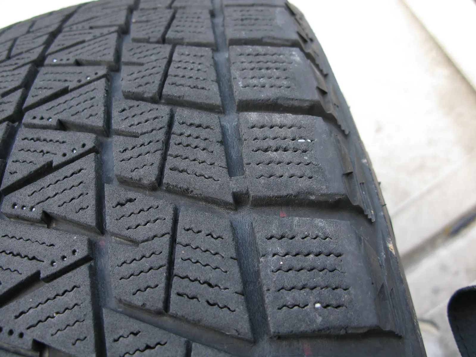

I've been running Blizzak DMV1 winter tires for the last 4 years for a total of 25000 miles. This tire has a softer rubber compound on the outer 55% of their tread for good traction on ice and snow and when this compound is gone it renders a wear bar to show you that you basically now have an all-season tire with a noisy aggressive tread. As you can see, I'm down to that wear bar with about 6/32 of evenly worn tread. I don't know if I'll be running these next season or buying new snows. That special rubber compound makes all the difference in the world between traction and sliding on the ice. Maybe I'll use them on the beach!

This is why I now run Micheline X-Ice 3's.
The Blizzak's have **excellent** ice and wet ice traction, but suffer everywhere else. With 'glow-ball worming' changing weather patterns, I spent most of the last 5 years on cold, clear blacktop.
Not all winter tires are made with dual compounds. One reason I don't run Blizzaks. True, they work great until that first layer is gone, then you might as well run them for summer to get your moneys worth.
EDIT: I did pull them off pretty quick after snow went away since everyone says these tires melt away pretty quick when the temp goes up.
I'm so sold on the Blizzak DM V2s I ran this past winter on the CX-5. It did so well and will now run them every winter. I'm now considering running them on my GX. I could probably turn that thing into a snow plow itself :-)

How old are the tires in the pictures? OP says they ran for 4 years but the DOT would determine when they were made.
I see a lot of cracks in the rubber that signals these tires are basically done.
Perhaps they were old stock to begin with before the OP drove for 4 years?
Where you store them in the off season also makes a difference with the rubber. They recommend a cool place away from any motors or ozone.

My Nokian WRG3 SUV's met their "no longer suitable for snow" criteria (4mm tread remaining, I believe) at just under 20K miles. Absolute trash.

I just checked for the wear bar as shown in your image and my treads are almost down to the wear bar, about 1/32 - 2/32 to go. I can still see the tiny ribs on top of the wear bar so I'm hoping I can get well over 300 miles on them before I have to get a new set of Blizzak's.
That worn blizzak will still do far better on snow or ice than any new all season imo. Michelin x-ice does seem like a sweet spot for me very minimal mpg hit and great wear @6k mark. No issues in wet conditions either, put fiddy on em uno.

I read that Blizzak's may wear a bit faster than some but I have had my WS70's for 4 winters so far and they will certainly last me the rest of this winter!! NOW, I don't put my winter tires on until the temperatures are consistently close to freezing(usually Nov. or early Dec.) and the first snow has fallen and stays on the ground. Then in the spring I get them off before the snow has all gone and the first spring rains arrive. I think this is the trick to making those softer compound winter tires last.
