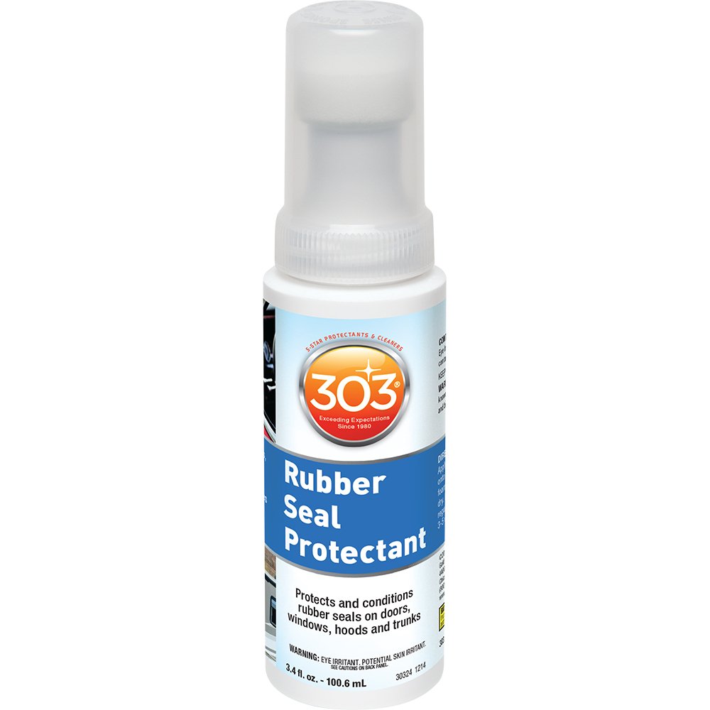

The wax is a good idea and I have another.
This stuff works great, it's a bit pricey but the convenience is worth it IMO.
https://www.amazon.com (commissions earned)
Been there, done that especially after car washes before the night of a flash freeze. Some silicone spray around the rubber seal will prevent this. Spray onto a rag then wipe on. Congrats on the new car and hope this will be the biggest issue that you will have.
Use this thing that the German cars use on the rubber weather strip on your car doors and windows and it will never freeze on you. This is part of the winter ritual if you live in cold climate as I do. The other bits are the blue minus degree wind shield fluid (in USA they seemm to be yellow) and a graphite dust car key hole spray. That way your car doors always open, the windshield gets a god clean spray and the key slot never freezes on you during harshest of winters.
