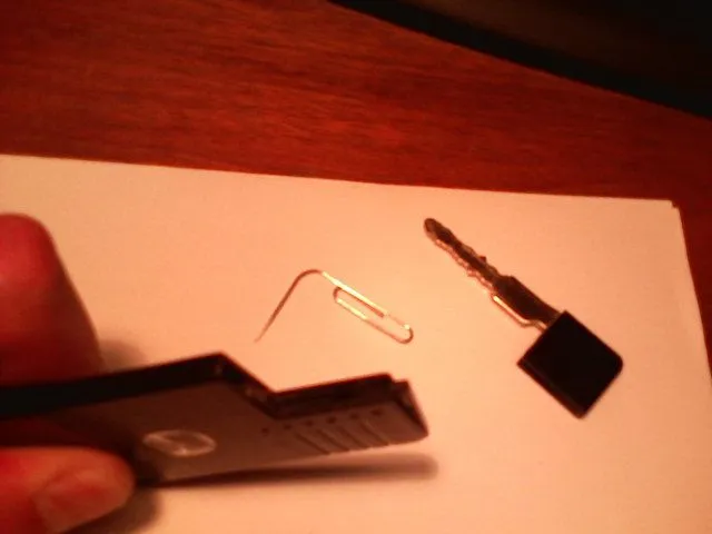

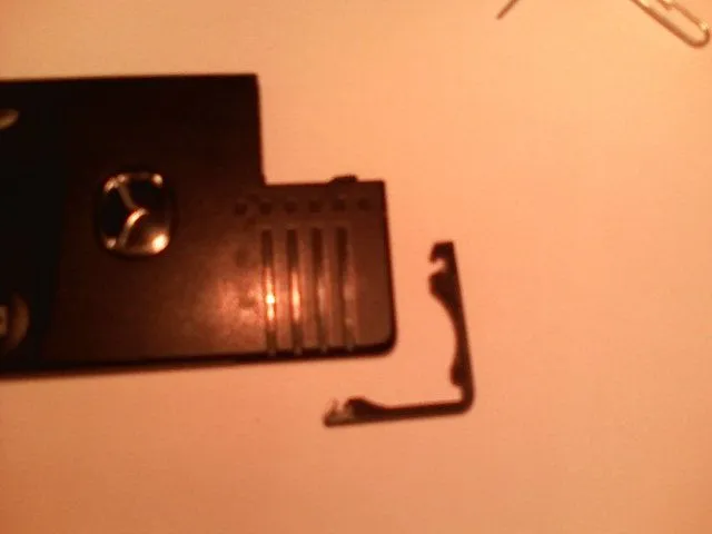

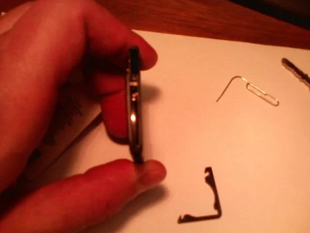

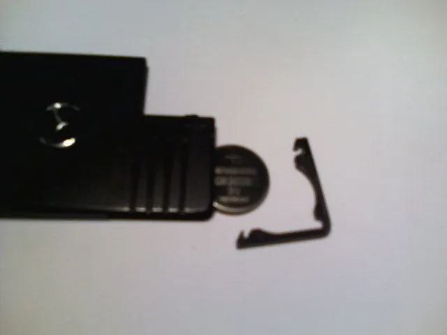

Are you talking about the one that's the shape of a credit card?
If so, all you need to do is slide out the hidden key. Right next to where the key was you'll see a small rubber-like piece. After popping that piece out of place, you'll find the battery.
Just changed mine. Hope that helps.
^ Like he said. I used a paper clip to pop the corner piece out, then use it on the side to pop the battery out.
Some pics...
Battery is Panasonic CR2025 3V
