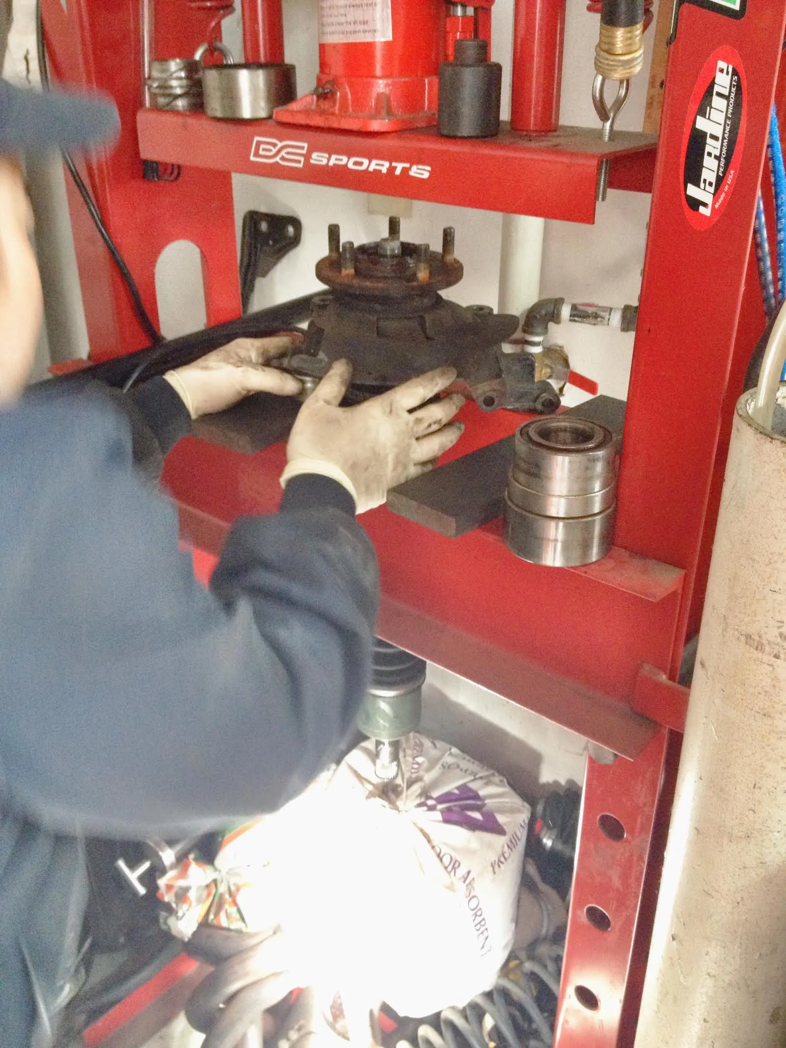

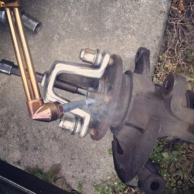

so my mechanic friend working on the car said the axle is seized onto the hub. they couldn't press it out and even if they could with a bigger press, both piece would be ruined. they also tried torching it.
great.. guess i'll be buying another hub and axle.
I know it's not recommended but when I did both my front wheel bearings on my '02 ES, the passenger side axle was royally seized into the hub. tried for hours to get it out the right way but ended up just pulling the bottom of the knuckle towards me while smacking the axle with the nut threaded flush with the end until it finally popped loose. I did ruin the axle nut and mushroomed the very tip of the axle but instead of buying a new axle I just verified the threads were not damaged and took a grinder ever so slightly to the mushroomed end so that a new nut would slide right on. all is good. but yes, that sounds just like my bearings when they were bad.
Angle grind the hub till it is close to the axle and then use a cold chisel to break the hub off the axle.
i got it all taken care of. knuckle is still seized to the hub but a hydraulic press got the axle out without much damage. will be returning that one for core.
