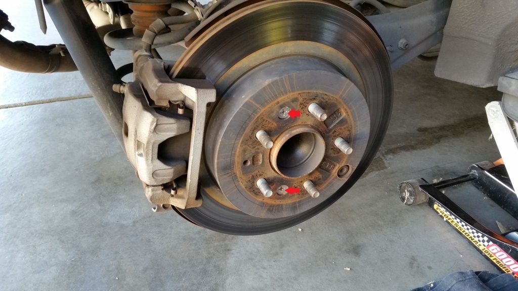

3. Undo the two phillips screws holding the rear rotor to the rear wheel hub (red arrows). These screws won't be needed with the new wheel hub as they don't come with any holes to accommodate the screws.

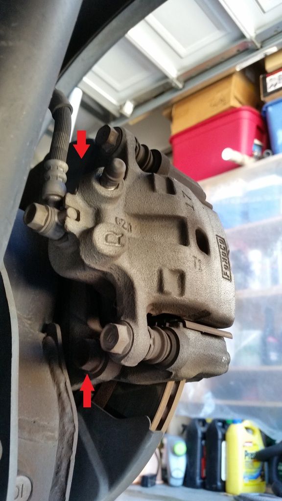

4. Undo the two 17mm brake caliper screws on the back of the rear brake caplipers (red arrows). Once the screws are removed, flip the caliper to the top of the rotor and zip-tie it up and out of the way.

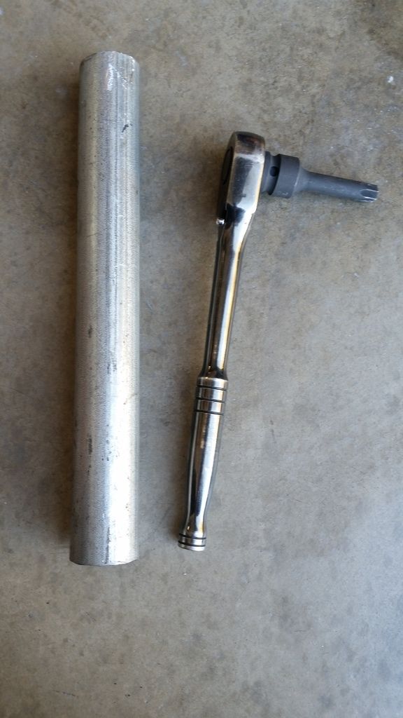

9. Using a "long" Torx 55 on a ratchet with extensions (when needed) along with a DIY 12" breaker bar (when needed), reach into the back of the hub to remove the 4 torx bolts. You can remove the 4 bolt by positioning yourself underneath the car or by kneeling from underneath the wheel wheel (both worked for me). **Hint - Have the new wheel hub near you. Remove bottom 2 torx bolts first and 1 top bolt. While removing the last top 1 bolt slowly out, simultaneously hold the back plate. Once the old hub is off, put on new hub on (while still holding the back plate) right away and screw back in with the 1 bolt. This way, the back plate with the ebrake won't fall off/left hanging when you remove all four bolts.

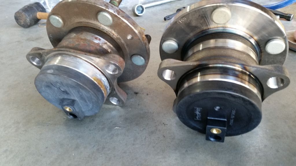

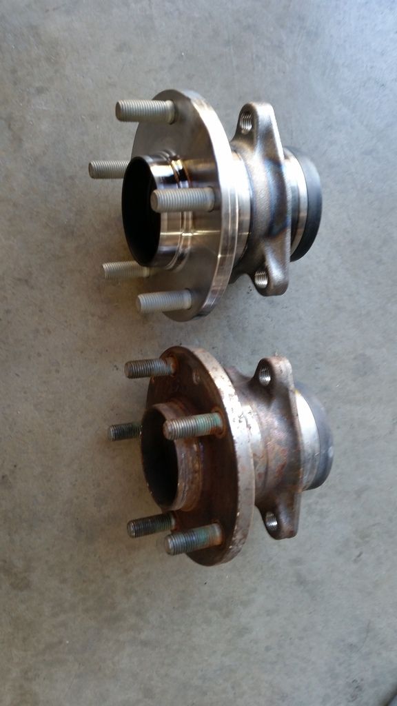

Old vs New
