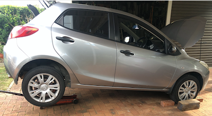

[1] Park car on flat surface & chock front wheels with 2 x house bricks either side

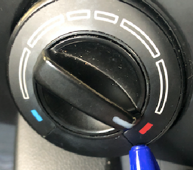

[2] Heater Knob to Hot & Also Fan Speed control on 2
Fig3 Heater Control to Hot

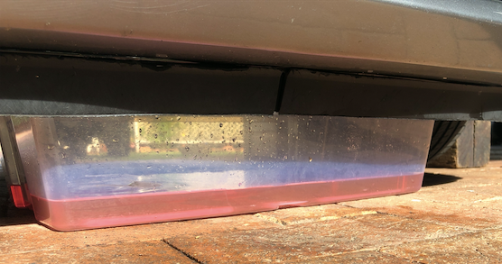

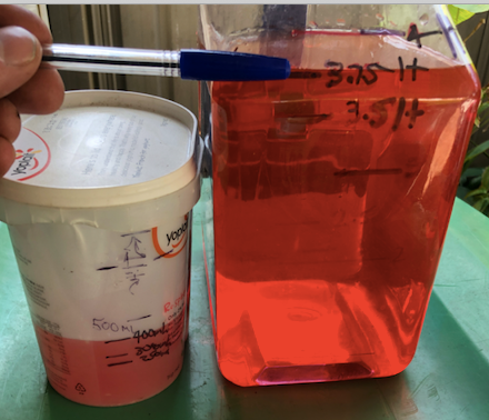

[6] Nominal 3.5lt drains out of Radiator & Block
Fig4 3_5lt into 20lt Container

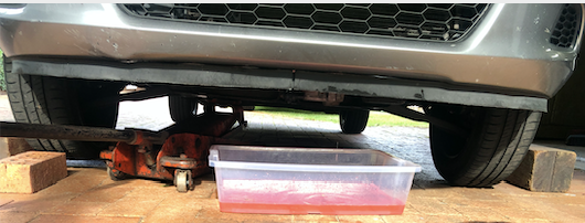

[7] Jack up the rear of the car using mechanics jack to Full Height, an Additional nominal 200ml will drain out
Fig5 Jack up rear of car
[8] Lower rear of car
[9] Jack Front RHS of car & slope to LHS an Additional nominal 50ml will drain out
06_jack_up_rhs_of_front_slope_to_lhs_radiator_drain__71b48e7606f3007bececc3b0a4eedeb39eff2944.png
Fig6 Jack Front RHS of Car to slope car to Radiator Drainage Point

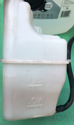

[13] Put a “mixed handful of nuts” into the Coolant Reservoir along with some clean water, shake around to clean the old coolant scum out.
09_a_few_nuts_used_to_facilitate_internal_cleaning_of_resevior_8f5aeb978c865ce14acf4e6f5c991b7c3f2f66c3.png
Fig9 A Few Nuts used to facilitate Internal Cleaning of Resevoir
[14] Drain water out of the Coolant Reservoir & repeat the cleaning process with new fresh clean water
10_reservoir_following_cleaning_with_nuts_side_view_bcb800c915347f1397ab2c534975c6860b06b419.png
Fig10 Clean Reservoir Side View
11_reservoir_following_cleaning_with_nuts_internal_view_c02cb40e937699769dbcbbe93a5fce5bfa461721.png
Fig11 Reservoir Following Cleaning with Nuts Internal View

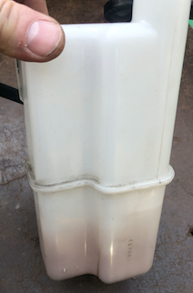

[15] Reinstall Coolant Reservoir & M10 Bolt, refit reservoir hose to side of radiator cap receptacle, put bottom radiator hose back on & close the LHS bottom of Radiator Drain
(Noted The Mazda 2 Coolant Reservoir is not as good as a Toyota Corolla one, it is not sealed & the Coolant Reservoir does not breathe through the coolant in the reservoir allowing minor pressurisation of the Coolant Reservoir & the Vapours in the Coolant Reservoir to condense without loss of fluid volume due to evaporation)
Fig12 Total Coolant Removed 3.75lt from Radiator & Block plus 400ml from Reservoir
3.75lt/4.6lt = 81.52% from the Radiator, Block, Heater Core & Hoses

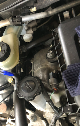

Doing [16], [17] & [18]....enables access from the Brake Booster Side along the rear of the engine to the the Top of Coolant System EGR Bleed Point.
[16] UnClip Brake Booster Vacuum Line
Fig 13 Unclip Brake Booster Vacuum Line
[17] Move Brake Booster Vacuum Line out of the Way
13_move_brake_booster_vacuum_line_out_of_the_way_7848ecb554d29f78e3005bdcfb323bbc5d4b2923.png
Fig 14 Move Brake Booster Vacuum Line out of the Way

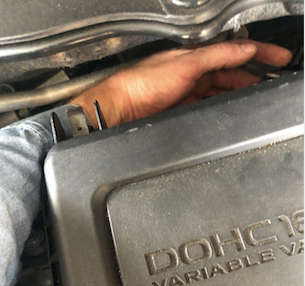

[18] Rotate the Brake Booster Vacuum Line Clip 90 Degrees towards the Brake Booster Side out of the Way.
fig14_rotate_the_brake_booster_vacuum_line_clip_90_degrees_out_of_the_way_70f94dac8df536e31353208bc98460031720085c.png
Fig15 Rotate the Brake Booster Vacuum Line Clip 90 Degrees out of the Way
With [16], [17] & [18] done....you can now access from the Brake Booster Side along the rear of the engine to the the Top of Coolant System EGR Bleed Point. NOTED you do not need to take the Battery Out MAZDA.

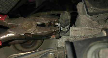

[19] Using “Small Bent Needle Nose Pliers” to Rotate the Top of Coolant System EGR Bleed Point “Constant Pressure Clamp” 180 Degrees
Fig16 Small Bent Needle Nose Pliers
[20] Access to Top of Coolant System EGR Bleed Point Constant Pressure Clamp with Small Bent Needle Nose Pliers is from Brake Booster side of Motor
16_access_to_constant_pressure_clamp_on_bleed_point_b43fce7bba4cce8a70dbd9f725ca0cb421b88594.png
Fig17 Access to Constant Pressure Clamp
[21] 180 Degree Rotated Constant Pressure Clamp to allow Easy Access & Removal from the Brake Booster Side.
[22] Using Small Standard Pliers Remove the Top of Coolant System EGR Bleed Point Constant Pressure Clamp.
17_remove_the_coolant_bleed_point_constant_pressure_clamp_f11018e75d13ab803865a88b2ce44080b8affc6a.png
Fig18 Remove the Coolant Bleed Point Constant Pressure Clamp

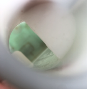

[23] Carefully remove the Top of Coolant System EGR Bleed Point Rubber Cap, make sure the Rubber Cap is not damaged or perished
[24] Replace the Top of Coolant System EGR Bleed Point Rubber Cap “partially on” so its easy to remove & facilitate bleeding & place a piece of rag under the bleed point
Fig19 Rubber cap partially on & rag in place

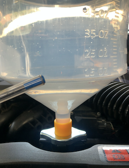

[25] Fit the “Cooling System Filler Funnel” & Refill with Demin Water it will take a nominal 3lt Demin Water until Water & bubbles come out of the Top of Coolant System EGR Bleed Point
19_sedy_97764s_no_spill_coolant_system_filling_funnel_kit_x002jp1m4n_2801d5890036450c8964797d1ad5a75b4fc13a68.png
Fig20 Sedy 97764S No Spill Coolant System Filling Funnel Kit X002JP1M4N

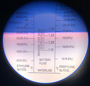

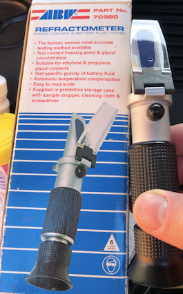

Use a Refractometer in my case:
Fig22a Coolant Refractometer ABV Part 70980
22_refractometer_40perc_incar_replacement_coolant_after_flush_fba34ed448ddc0a40281bd291dfa44ada85c6bb3.png
Fig22b Refractometer 40.8Perc Incar Replacement Coolant After DemIn Water Flushes

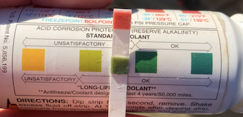

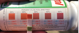

Also Check % Ethyl Glycol with test strip
Fig23 Coolant Test Strip Perc Ethyl Glycol
Check coolant corrosion protection with test strip (pH & Reserve Alkalinity)
Fig24 Coolant Test Strip Corrosion Protn

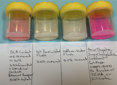

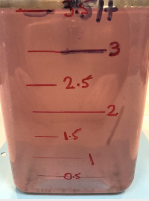

Fig25 Coolant & Demin Flush Drained Samples
L to R a) Drained Existing Coolant, b) 1st Demin Water Flush Drained, c) 2nd Demin Water Flush Drained, d) New Toyota SLLC
26_2nd_demin_flush_looks_clear_in_the_sample_jar_but_not_in_a_3_5lt_container_c26627b5b275171acc647acb6476b29fb3dc0838.png
Fig26 2nd Demin Flush Drained Fluid Looks Clear in the Sample Jar But not in a 3_5lt Container
