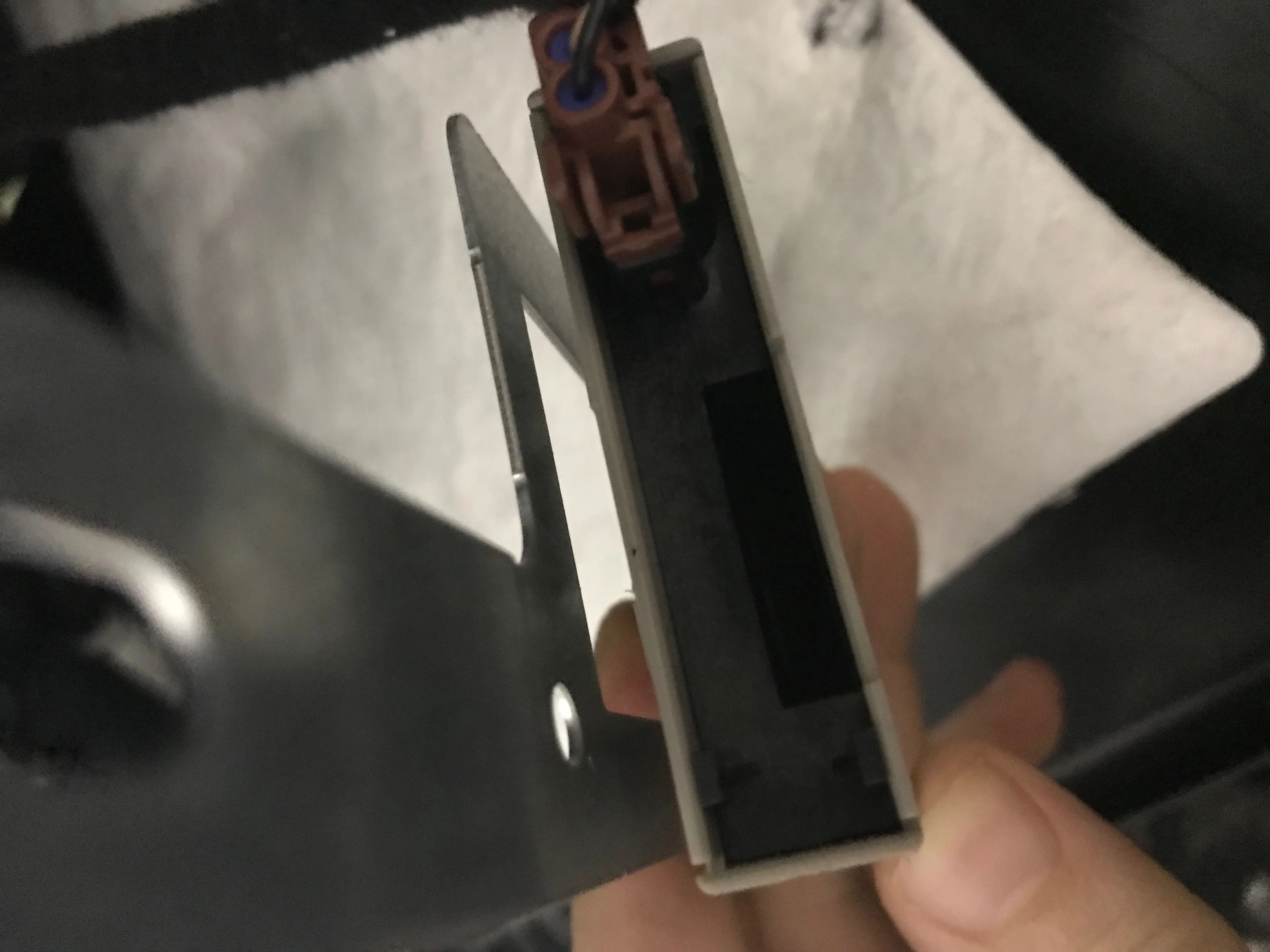

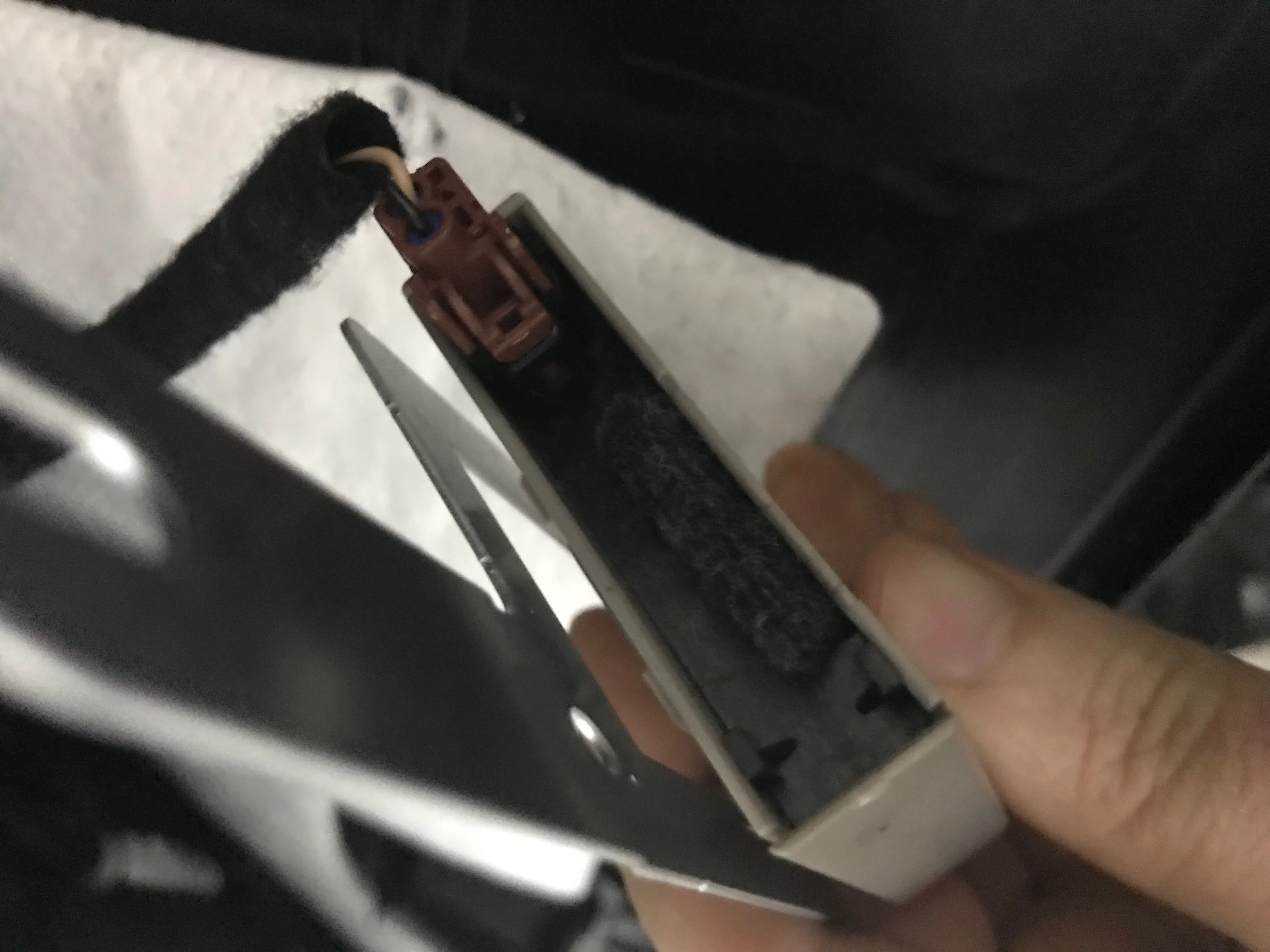

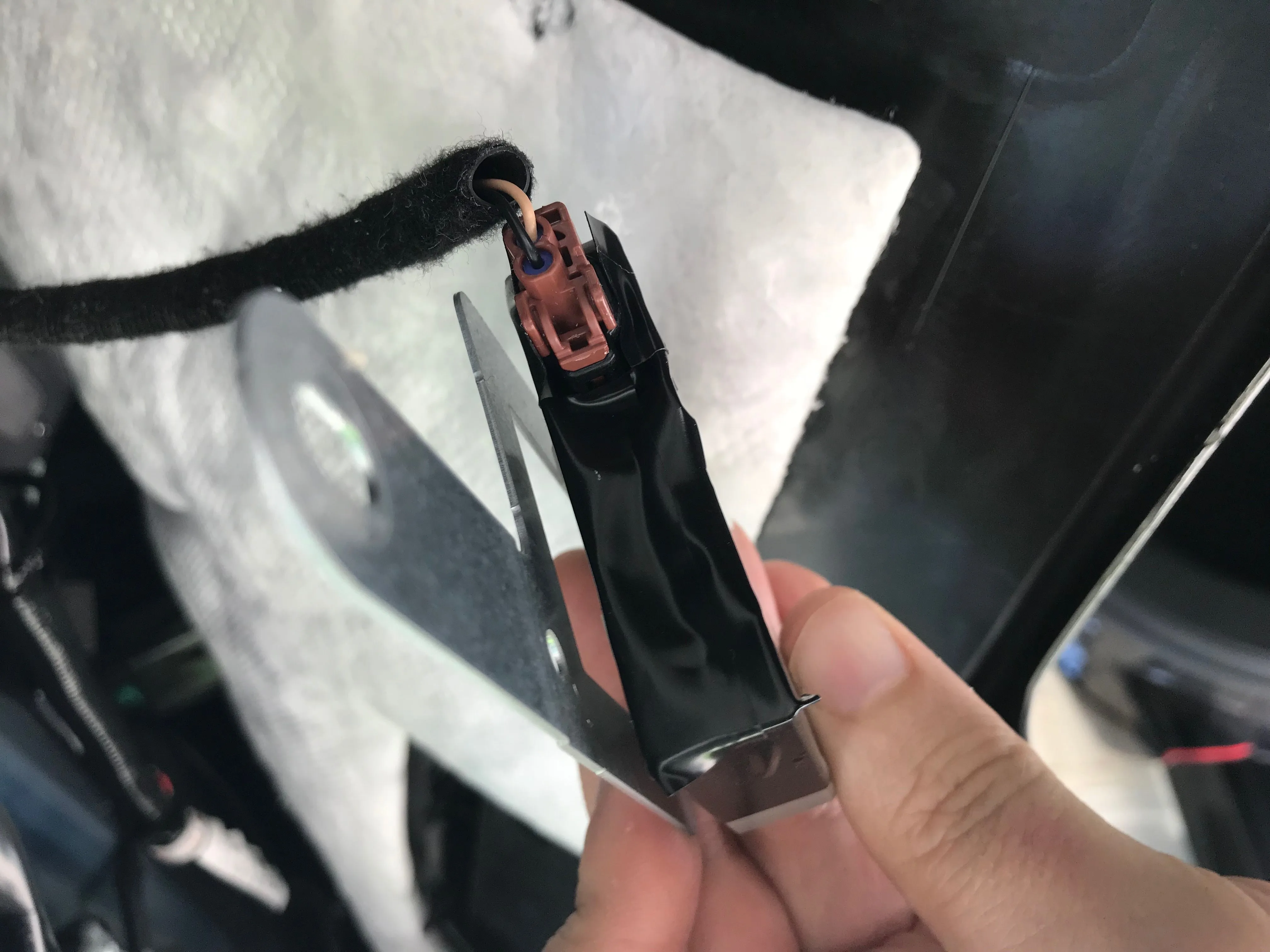

The buzzer has a rectangular shaped "horn" opening that I stuffed with some 5 mil thick heavy felt and then taped over it. Measured decibels of the beep went from 89 to 59 measured at head height about 2 foot from door, which is the same decibel level of the door closing itself. Much more tolerable and less harsh now when you hit the open or close button but still plenty to let someone know. Sorry for huge pics, I can never figure out how to adjust image sizes.

Aye, that*s it. It will always make some noise left connected because it resonates through the bracket.
