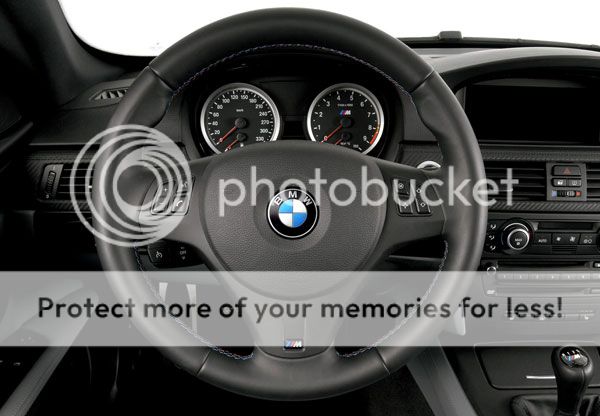

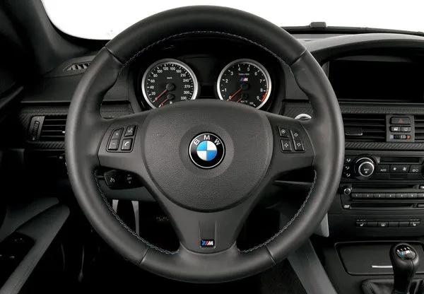

Anyone ever think of changing their steering wheel? I have a sport model 2. The wheel is ok, but it's soft plastic and is pretty thin. I know the touring models have the nicer leather steering wheel but doesn't have "sport grips". Does any newer Mazda have a steering wheel with "grips"? Everyone I've seen has none at all. I drove my buddies BMW M3 and I fell in love with the steering wheel. I'd like something like that in my 2. Is it even possible to switch them?

I mean the buldges, but honestly either would be nice.

If only I could put that in the M2.
