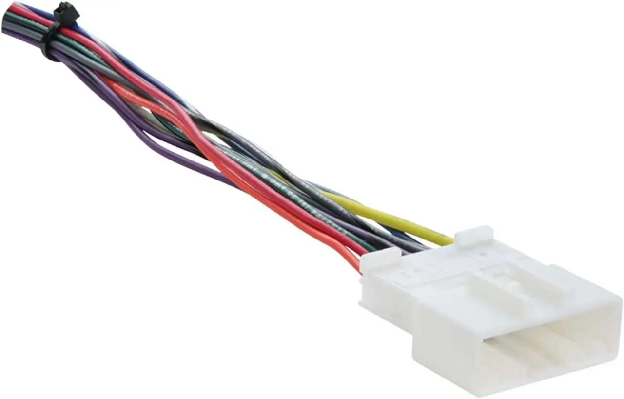

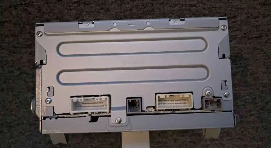

I would like to replace the radio unit that I have in my CX-5. It is Mazda 2.0 2015, and my audio unit is a simple one, without color LCD and w/o navi. It is panasonic KA1F. But it seems that there is something different/wrong with connectors that the radio is connected to my car. It is a shape of the connectors. Anywhere where I was looking for radio replacement, I found out that the shape of the connector is like on attached pic#1 (I took the photo somewhere from the internet)

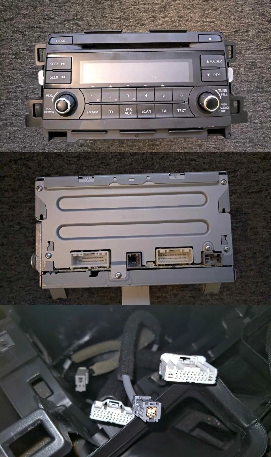

But I have totally different plugs. Take a look at this two white connectors (3 photos below, from my car):
- one is 24-pin connector (2 rows, 12 pins in each row) and
- the second is 20-pin (2 rows, 9 pins plus 1 additional on each side).
I guess that one is for power cord and the second is AUX. My car cables do not fit to the connectors above (I bought Android radio and they sent me cables that have similar shapes to above)

All that looks to be factory (no funny dealer business). What region of the world are you in?
I suggest taking a look at Metra

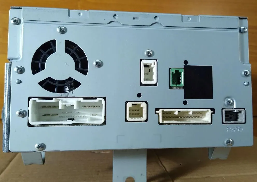

Meanwhile I have found an interesting information, where @guy989 says something about CX5 "2017+ TAU with the new small 20 pin connection".
Looks like connector I have. guy989 points out that he used NN04RB connector which is for...Nissan. This hint led me to the Qashqai site, https://www.qashqaiforums.co.uk/viewtopic.php?t=8074. Over there is a photo of Nissan radio with quite similar connectors. Not 100% sure if it the same size but the rest looks the same.

@Jacek I wouldn't put too much thought into the TAU connectors being the same for Nissan / Mazda -- there are only so many connectors to use without re-inventing the wheel.. and just like airbags .. no one makes their own audio solutions.. the car manufacture sends the specification to another vendor and that vendor sends back a solution.

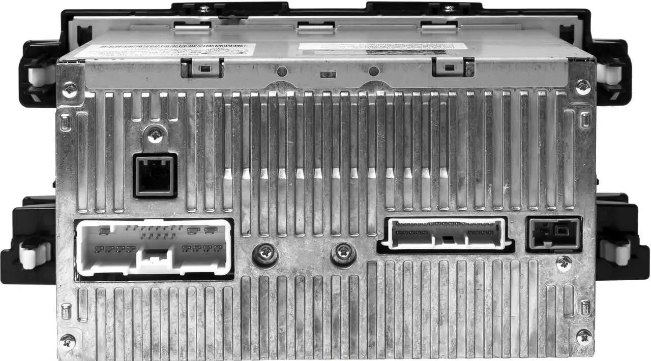

From what I understand, the CX-5 used the following connectors on their Basic Headhunt from 2012 to 2015 :
Then they change for 2016 to this :
And I read that for the 2016 version I need this harness (Metra 70-7552) that is also working with Nissan and Subaru :
Can someone confirm that to me?
