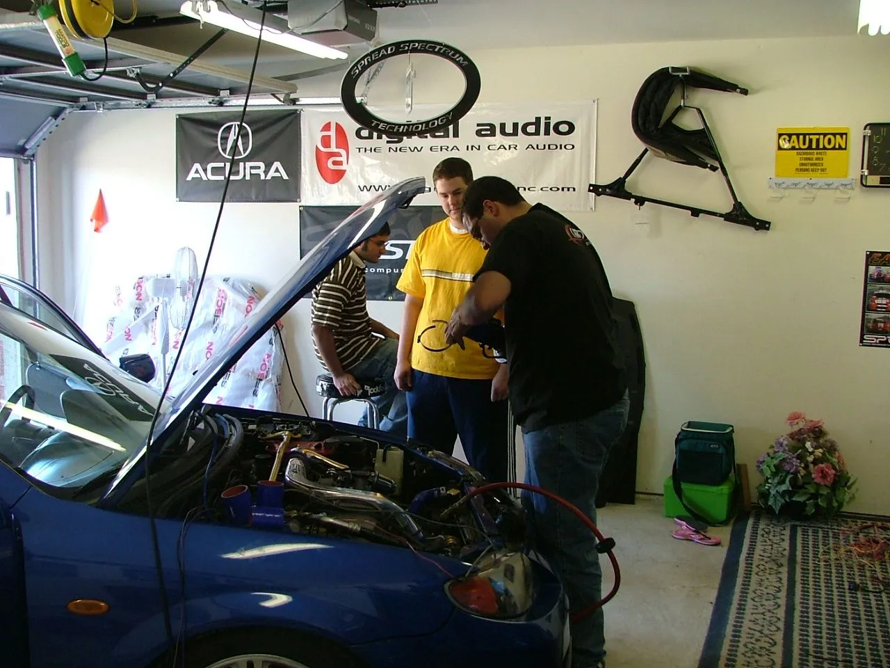

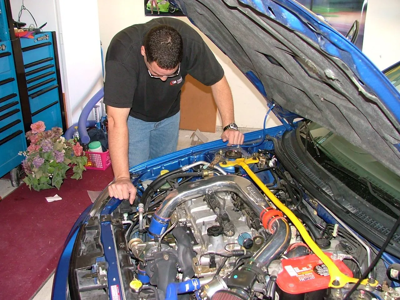

I almost forgot to post the pictures of Pirana's install of the Haltech E6X in Matt's car. Check it out..not one, but TWO BOOSTED MP3'S!!!!:

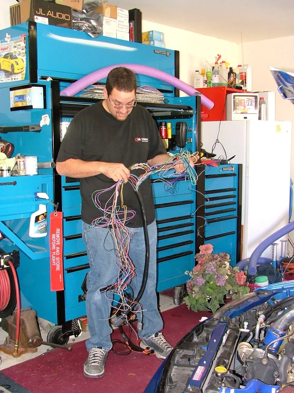

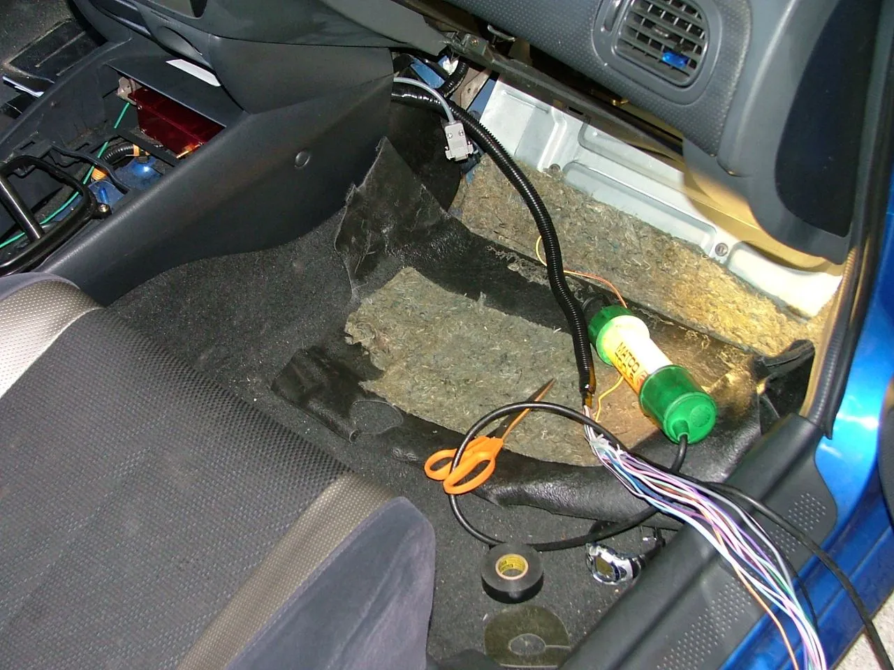

The wiring:
haha. looks like you guys had a great time. i finally met matt saturday night, he is a cool dude.
yea that spinny chair was teh s***, oh yea and the qt milkshakes.

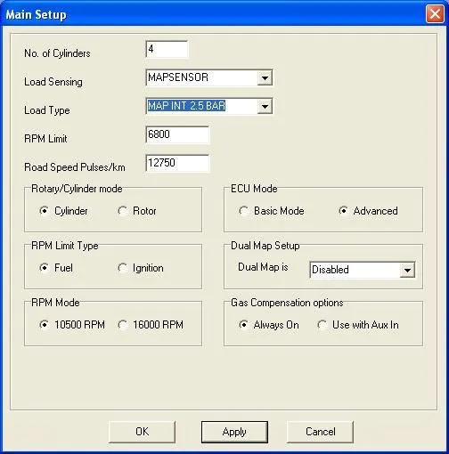

Chiming in with an update. I talked to Juan today about a possible map for the 280cc injectors, but he does not have one. The reason is that with the E6X he was aiming for higher boost from the get go, so he has the 440cc map only for the E6X. The solution was for me to get a F10 map (thanks NIV) and import in into the E6X map. It worked like a charm. Now we need to test this map on Matt's car. Victor, give me a call when you see this. I want to come load this map. See attachment:
Ok, for some reason when I imported the fuel map from the F10, the ignition map got clobered. :wtf: It had to be recreated by hand from scratch by copying Juan's ignition map for the 440 cc injector map. I then went in and varified that the setup was done correctly. Since the new E6X ECU's use an internal MAP sensor, I had to change the settings to use an internal MAP sensor. This may explain why Matt's car was running rich when it was first started up with the 440cc map instead of running leaner. Check my post above for the updated E6X map for the 280cc (stock) injectors.

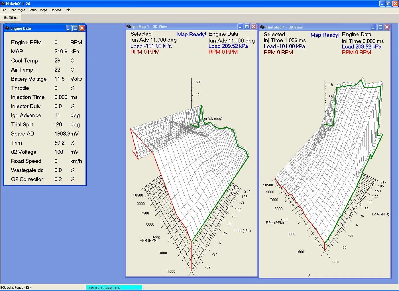

Well it seems we ran into a problem last night. Appearently, Matt's car likes to hit 30 PSI of boost!!
......When not even started!!! (eek2) This made the car rich as hell. If you see the first attachment, you will see his map going to 30 PSI (209.52 kPa) at 0 RPM!! We found this a "little" strange... This morning, I did some investigating, because Victor and I had eliminated this being an ignition problem (when we saw it reading 30 PSI). I found my possible answer here:
http://p210.ezboard.com/fhaltechdiscussionforumfrm1.showMessage?topicID=1425.topic
It seems that the Map sensor was still set to 3BAR instead of MAP INT 2.5BAR. I have made the changes, and have updated the map in the previous post. We will test this out to day, and it should work.
