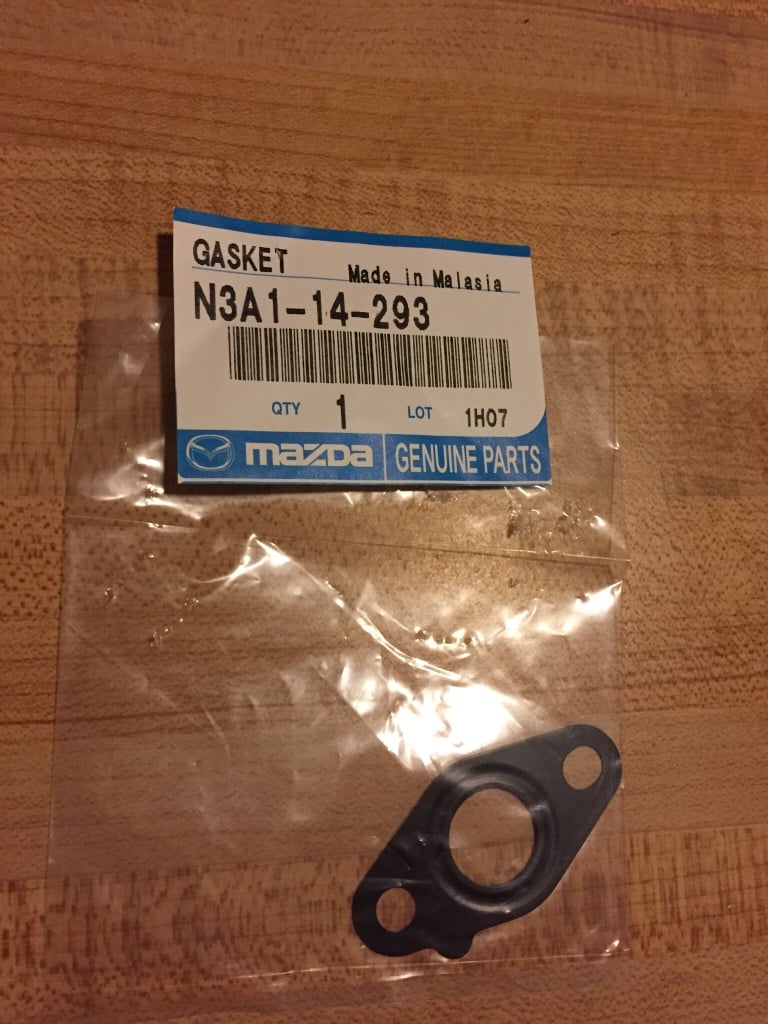

got my turbo oil line gasket in today as well.

Swapped bulbs and still have the same issue really not sure what's going on, going to possibly pick up a turn signal relay from the junkyard before I dive into all the wiring. Then another one of the previous owners genius ideas surfaced again...
can't find a 6x1.00 bolt? Let's just throw a self tapping screw in there! Dink. Anyway got that tapped and good to go so I started working on the turbo oil line leak...
not sure there is supposed to be rubber fuel line on my turbo oil line...so looks like I'm buying a new line! Anyone know of a site that sells a factory replacement? Or even a stainless steel line? All the lines I'm finding are for a gt turbo and they seem to be a mile long.

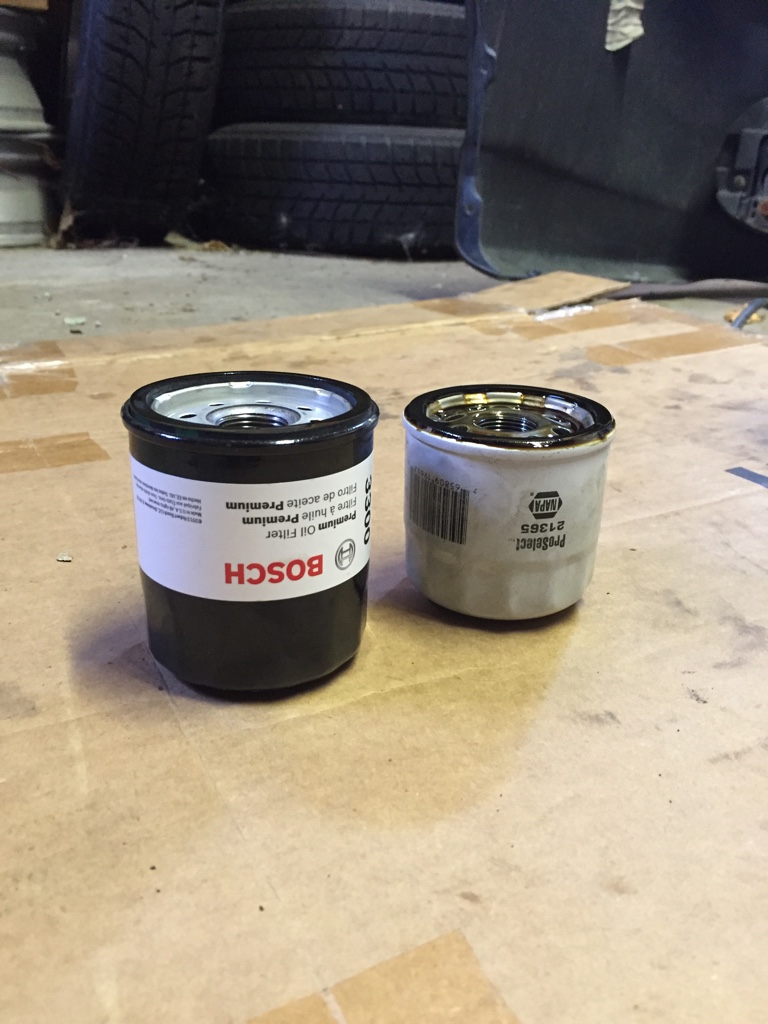

Did an oil change and found that the Bosch filters are the biggest ones the parts catalogue lists for our cars. Always good to have a little extra oil filtration for the car.
Why not take the old one to a hydraulic line shop so they can replace the hose on your fittings?
The return line probably started leaking, the factory line is silicone but they fail eventually. Nothing wrong with running a rubber line but a braided or silicone line would be ideal. I run the 626 V6 oil filter, it's probably the one you bought.
