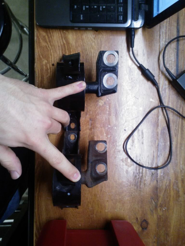

Just an FYI...
The passenger side mount is different for the MT and AT.
The pin is a different length and some mounts don't come with the pin and you are expected to reuse the old one
If what you might want to buy doesn't say whether or not it's for AT or MT, then it's probably best to avoid it.
