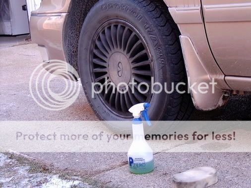

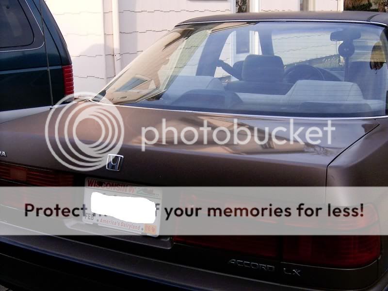

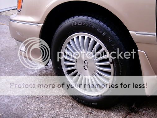

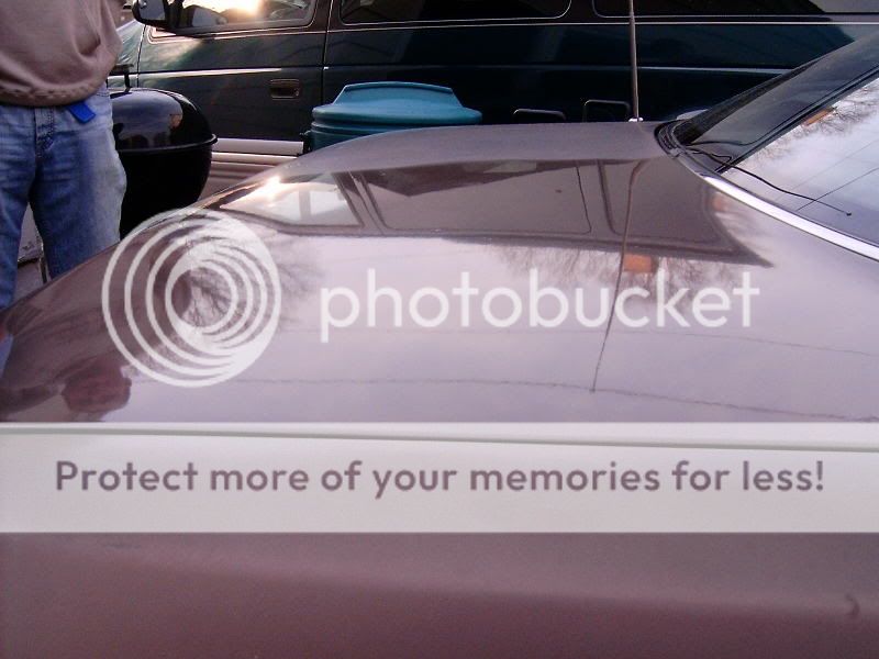

What's the problem that you need a repaint? Often, things can be restored even when you may think it's gone for good.
Examples...
