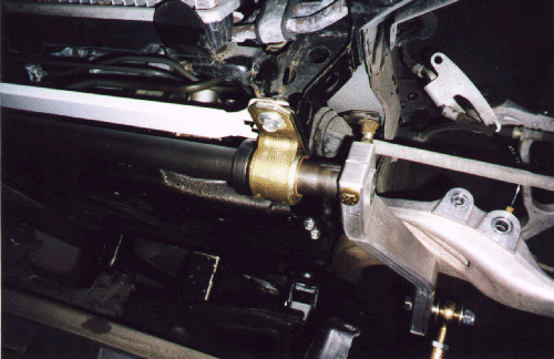

I dont know what they look like, but its probably the bushing in the clamps that hold the sway bar in place. I have replaced sway bars in my '03 CLs, and it was no big deal. just climb under and have a look.
This is a pic of the front sway on an RX-7. The gold part is the clamp. Usually the aftermarket bars come with polyurethane bushings, but they cost more, so OEM is probably just rubber.
pic taken from http://www.fd3s.net/anti-sway_bars.html
