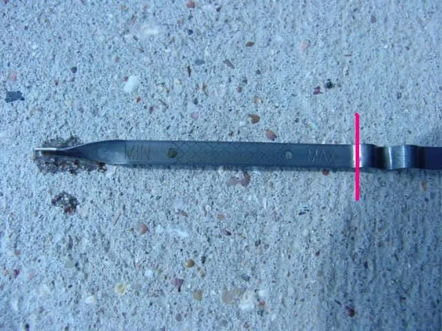

I took my car in for my "first free oil change" yesterday. I got it home and checked it after sitting a couple of hours.
The first pic is where the oil was, almost 1/2" over the "MAX" mark. I didn't like how they overfilled it, so I jacked it up, and drained oil until it was at the top of the "MAX" line.

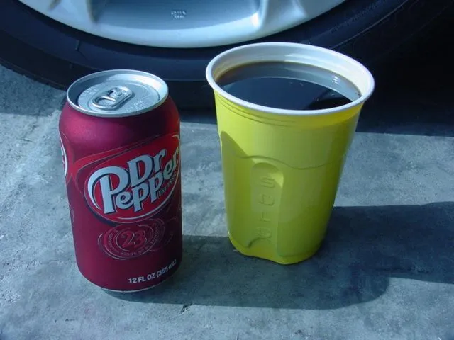

When I drained the pan, there was enough to fill an 18 oz SOLO cup. I could have just overflowed the cup, but didn't feel like getting every last drop out of the drain pan.

Don't worry on that small amount of overfill. I run with 1/2 qt + all the time on a fresh oil change so I don't have to check the oil for some time. I also did this with my race cars so I had less chance of grabbing air in the oil pickup in the corners.
Don't worry about that "small" amount? Geez, I'd hate to wonder what you consider a "large" amount of overfill(omg)
I remember seeing that engine damage was possible overfilling the oil.
That was about 19 ounces, and a quart is only 32 ounces.
Matt
I overfilled my oil by about half a quart and asked a bunch of people about it, and the concensus was that it would be fine. I drove around on that for a couple weeks and nothing happened, and then I had some free time and drained it down to the F mark.
Clearance between the rod ends and oil in the pan is really the only issue with overfilling. If the rod ends dip into the oil it will:
a - Induce drag on the moving parts and create undue heat.
b - inject air into the oil causing frothing and rapid brake-down of the oil and additives due to oxidation.
Most stock engines have sufficient clearance for a couple of extra quarts, but I have zero solid data on how much extra room is in the 2.3 litre's pan. Also if you do hard cornering/acceleration you could slosh the oil around enough to get some slap from the rod ands and induce some frothing.
