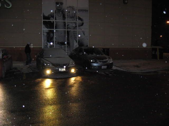

I wired my own sort of DRL with my lower fog lights. It's really up to you how you want to go about making it work if you want to do something different.
This is what my car looks like when I'm driving during the car or rather anytime.

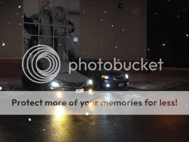

Here is a photo with the lowbeams on.
I still have independent control of both at any time.
The lower fogs are just regular H3 bulbs in Ion Yellow.
