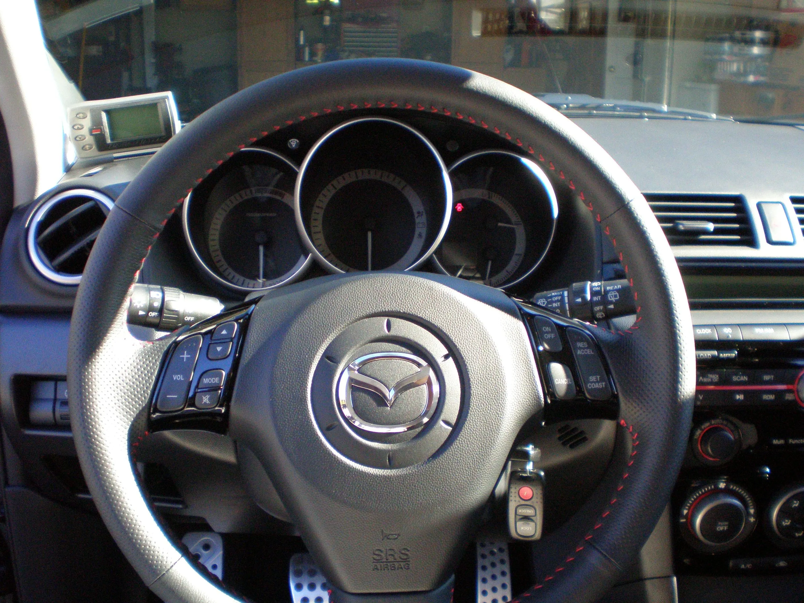

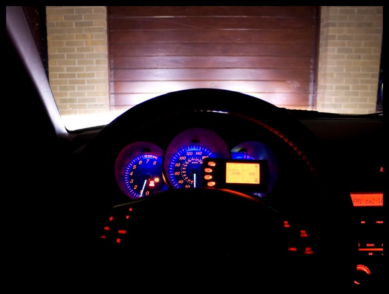

this is how I have it:

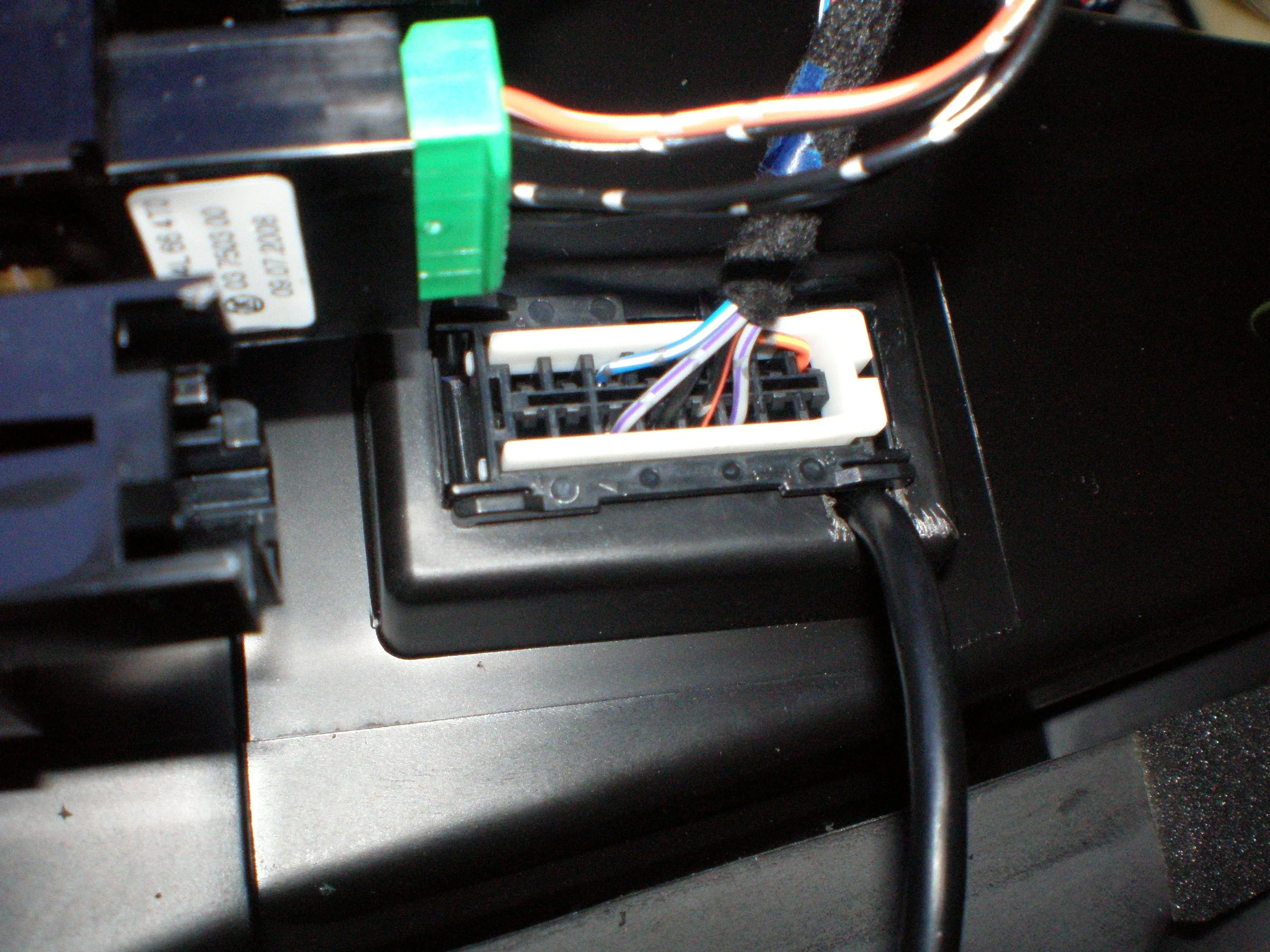

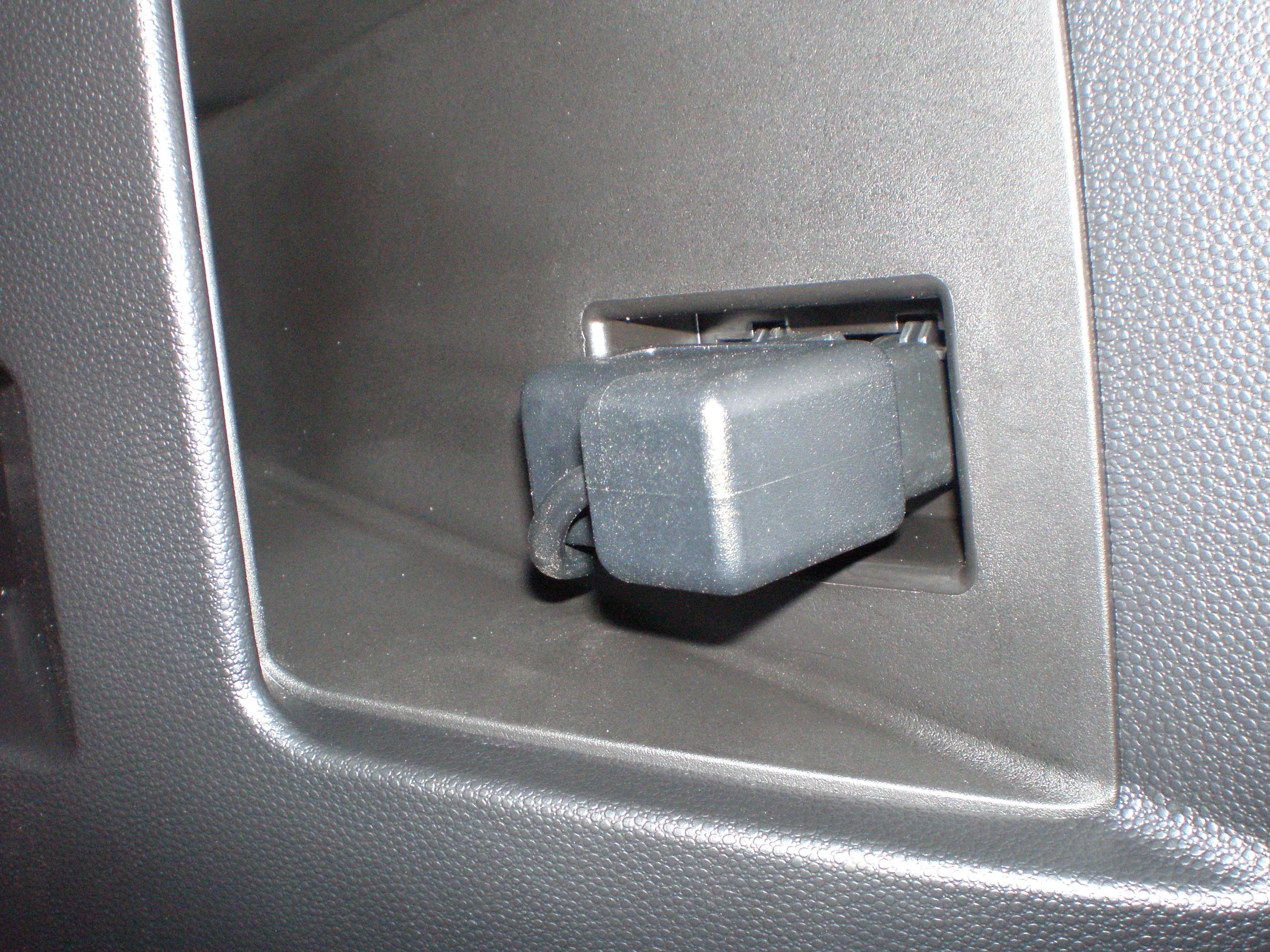

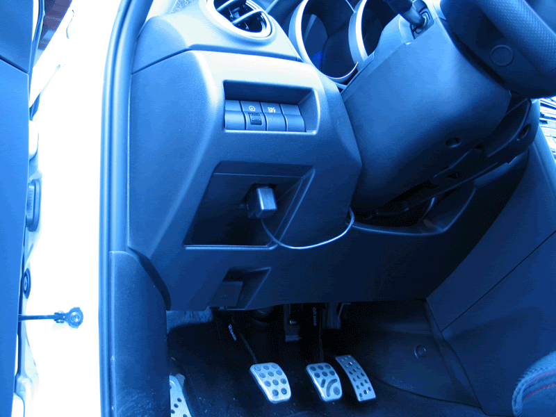

I was wondering where the OBDII port is located on the MS3? Or is a picture included when you purchase?
I made this GIF to show the difference between the Cobb AP plug and the DH plug, but it shows where it plugs in, anyway.
I have mine mounted similarly, but to the left so it only covers below 2k rpm on the tach. Of course, RPM is one of things I usually have up on the dashhawk anyway. It sits just high enough to read all the display and no higher. I just custom cut something to mount the dashhawk to that wedges inbetween the part of the steering wheel pod that sitcks up and the dash. It stays put just fine - sorry, no picture.

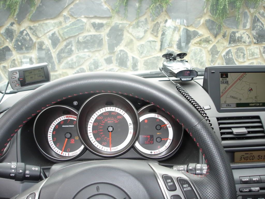

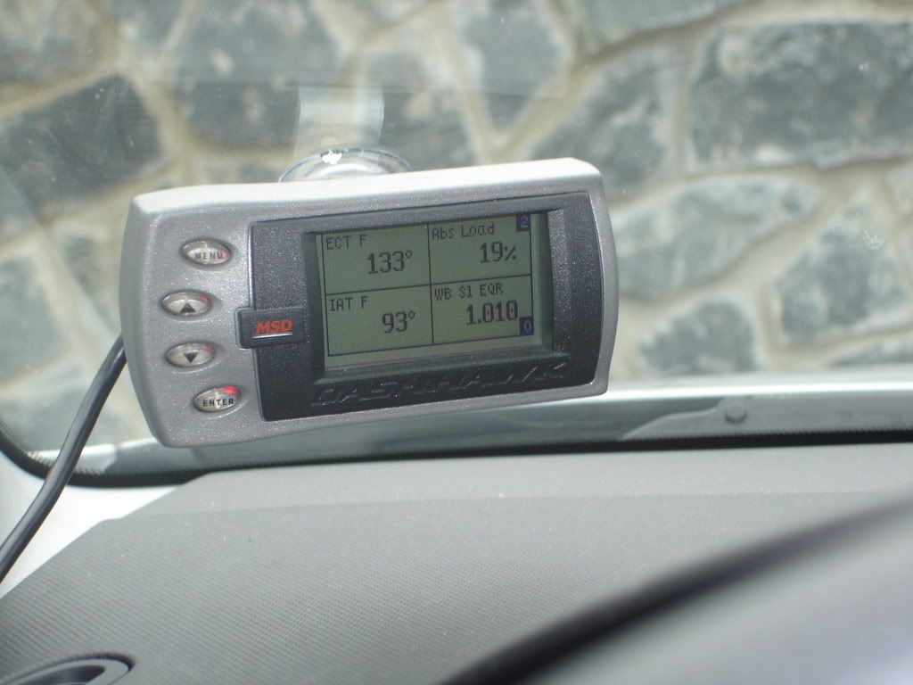

I have my DH mounted in front of the fuel gauge, and I display fuel level on Screen #1 of the DH to make up for it. It does not block my speedo or tach at all. I'll see if I can remember to snap a pic of it before I leave work in the morning.

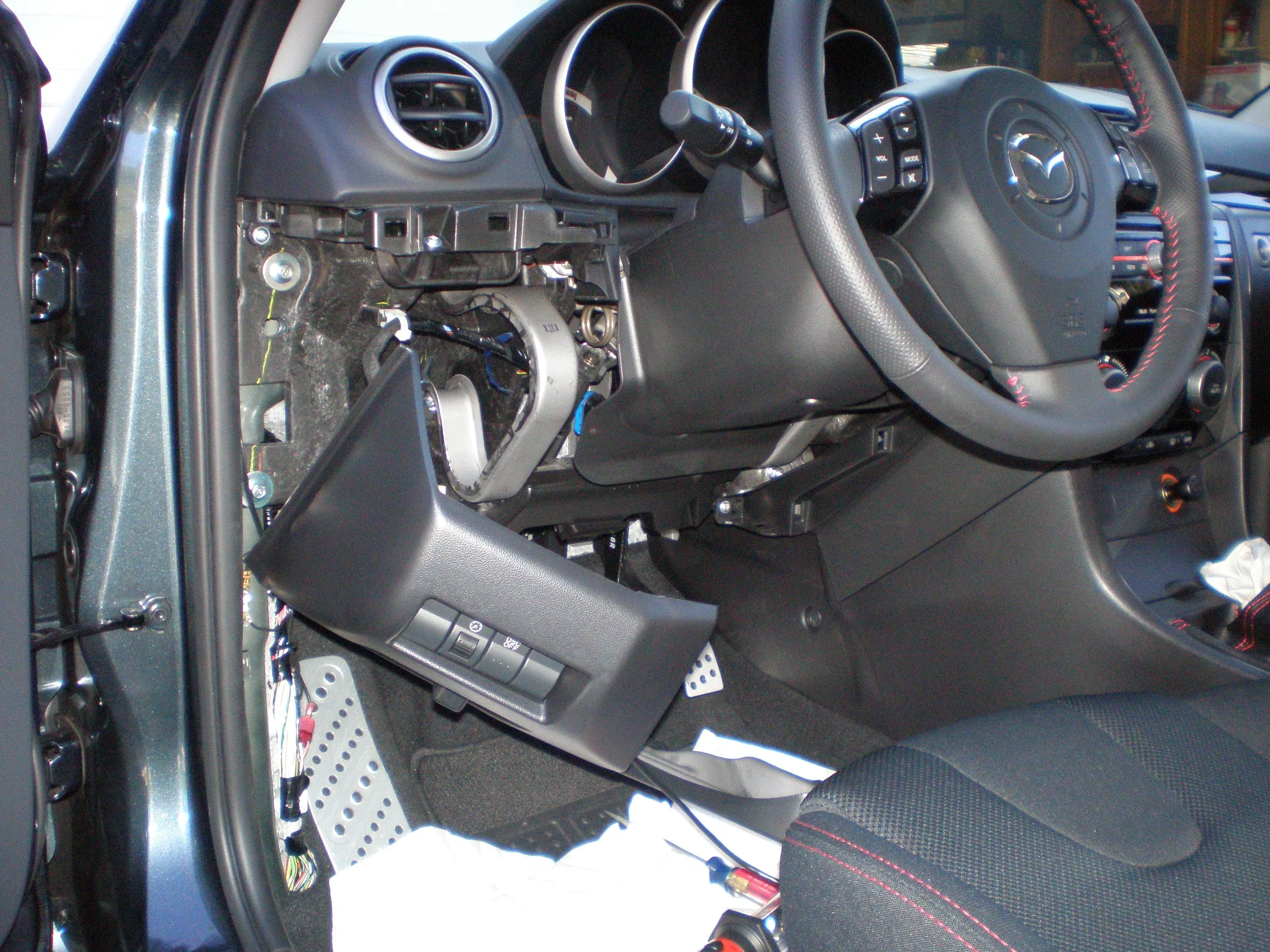

i ran the cord through the dash so i wouldnt see much of it then mounted in the corner. right in sight.

I like that idea, too. You definitely want to mount it in a place that is easily seen at a glance (which is why down by the airbag light isn't such a great idea).

thanks guys, i do like the idea of running the cord back thru the dash. They all look good. If and when i get mine and the time to do that, ill post up some pics.

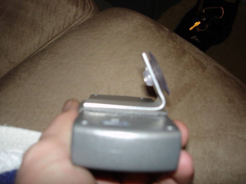

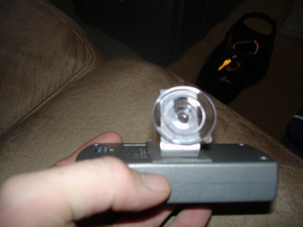

dkswim: Does your dashhawk ever fall off from vibrations or with temperature change?

That's why you attach it with velcro. Disconnect wire from the back of the unit and remove from the mount. Hide in glove box or take it with you (that's what I did when my car was at the airport for a week)
dosn't fall off. it gets removed every now and then... so its on fresh every now and then. if im leaving my car in a bad part ill take everything with me...
