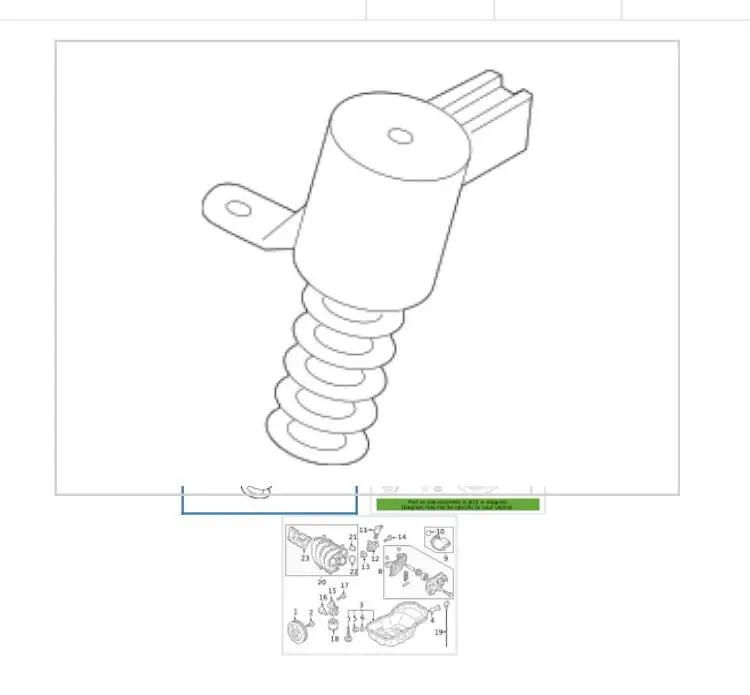

The oil pressure solenoid valve PYFA-14-440C the dealer replaced is the correct OCV. It located on the side of the engine and controlling the oil pressure by the pump in two stages.
The OCV related to VVT, part no. PE01-14-420A, is located on the engine top and that’s the one prone to leak.
See post #817 and #819 above for more details.

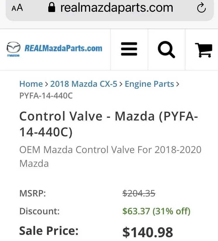

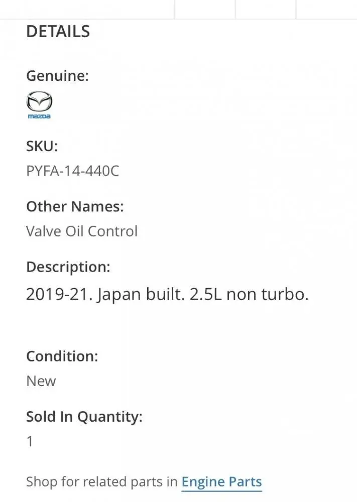

I was being sent down the wrong road by this Mazda online parts site, which incorrectly included 'VVT' in the description for PYFA-14-440C.
https://www.jimellismazdaparts.com/productSearch.aspx?searchTerm=PYFA-14-440C
So, yes I agree with you that they did replace the solenoid that does participate in controlling oil pressure for the entire vehicle, and the subsequent improved oil pressure that they found does make sense.
Looks like the info on that particular Mazda online parts website is not trustworthy.
