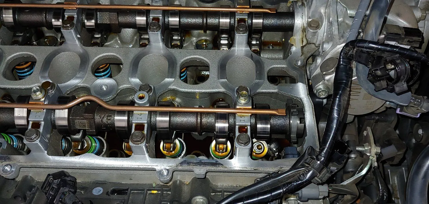

Bozmanx, the only symptom that the guys had who had a thrown rocker was the car going into limp mode once in a while. It is a long read, but start from the first post. In the beginning there was little understanding of the issue. This is one of the pictures with the rocker out of place:

I agree with edmaz here. Based on those experienced the fallen rocker arm, especially the OP Go Hawks who almost involved an accident while passing, there’s not any symptoms including misfire CEL until you go for very high rpm and the engine falls into the limp mode. There’re other victims also said the same thing, which made them hard to get any dealer service until the whole thing exposed by the effort of those such as Go Hawks. Apparently one intake valve instead of two is sufficient enough to make regular engine operation in low rpm’s smoothly without triggering any CELs.

Honestly most of us were stunned when OP described his experience at beginning, especially with no symptoms with a fallen rocker arm on cylinder #4 until he was trying to pass with full throttle. If you read the entire thread, and other threads at the same time for the same issue, you should know where are edmas and I coming from. We said that based on people’s actual experience, not based on theory. Yes you should be able to tell a rocker arm has fallen with some sophisticated equipment, but not from most drivers.
For years engines operated with one intake and one exhaust valve per cylinder effectively but at lower rpms and many still do. At high rpms there is less time for the air to move and thus the design with multiple valves so as to get high power with high rpms out of smaller lighter engines even though it is less efficient. Highly efficient engines turn over slower and most are 2 valves per cylinder. My experience is that less than 3000 rpms with less than heavy load on a CX-5 it is difficult to detect one intake valve not opening, now if it did not close that would be a different matter.
184789 I thought the exact same thing. I thought if I was driving and suddenly the rocker came off and shot to the corner of the upper end and then an intake valve stayed closed that I would imediately hear and feel it. But two members on this board described their symtems and neither noticed anything irregular except when accelerating in high rpms when their cars went into limp mode. I even questioned GoHawk's account because his car went into limp mode, he turned his car off and back on, and then drove like a maniac to pass a truck that was going too slow for him :-). If my car went into limp mode I would stop and call Mazda to see if I needed to be towed in.

Unfortunately the cylinder deactivation recall by Mazda doesn’t include ANY verification of fallen rocker arms. And there’s no symptons of fallen rocker arms until you need engine power the most and that coukd put you in very dangerous situation like Go Hawks experienced. You should do some WOT test described in this thread on the highway making sure the CX-5 won’t get into the limp mode.
