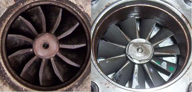

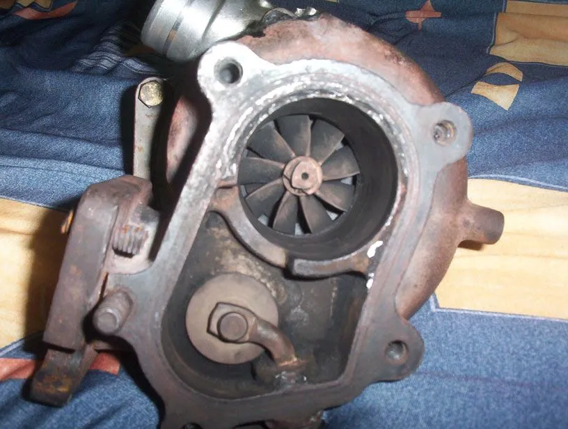

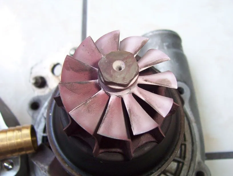

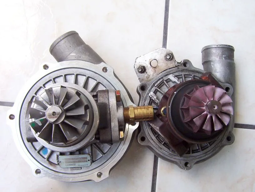

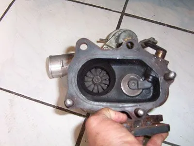

what stage is your turbine wheel and a/r?
i suppose its standard
check the difference in stages, and other turbine wheels like the WRX and a T28:
