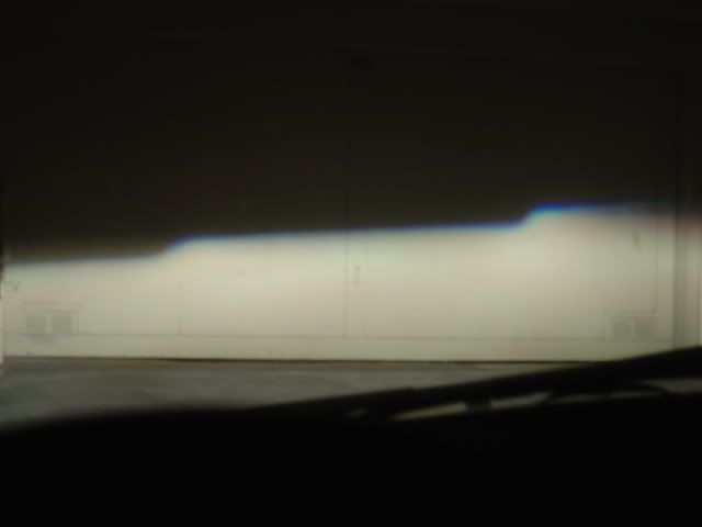

Does your dads allroad flicker blue? Its because of the cutoff on the lense not because fo the bulbs. If you look from inside onto the road the color is white. But if you look at it directly you'll see the blue flicker.

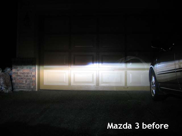

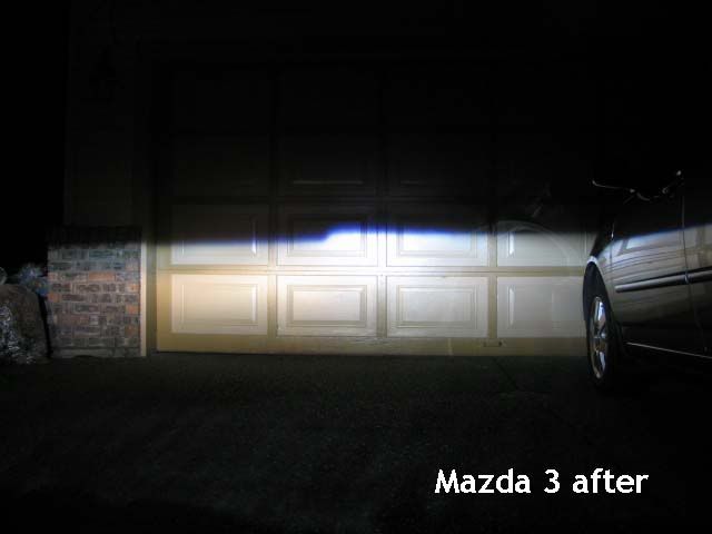

Mazda 3 hid projectors dont' give the best color on the cutoff but a couple peeps have swaped out their lense with clear lenses and used washers to modify the sheild to give alot more color at the cutoff.

Heres OEM Mazda 3 projectors with washer mod for more color:
OEM lens with washer mod and lens spacing done the sharpen the cutoff:
Valeo fresnel lens on the Mazda 3 HID projector with washer mod and lens spacing:
I borrowed those from Ruff so don't get mad if you see that man!
Heres a Evo8 lense swap on OEM Mazda 3 projectors borrowed from Say Chi Sin Lo.
Now heres mine i have s2000 projectors retrofitted onto my housings.
See you can have the best of both worlds best light output with 4100-4300k bulbs as well as plenty of color.
Anything else let me know.

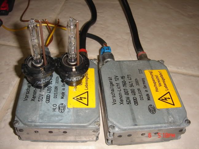

Problem is you don't have a D2S connector. Yes its a D2S bulb but the base is an H7 base to fit your projector. Real HID projectors have D2S holders yours has an H7.
You see the red thing in the picture below. Thats a connector to a true D2S bulb. Way different then yours.
Look at the bulbs below those are D2S bulbs theres no wires coming out to plug into your ballast.

actually i understand what you are saying now, i just had never seen an actual D2S bulb, and thew pictures on websites look the same as the ones i got on my car right now. I see what you are saying now.
Now, if it wasnt for the wires, the base of the D2S looks a lot like the H7 one, cause it fits just fine in my housing,, except to power it i need the cables in the back.
Well, now that i know what im looking for, i just need to find some bulbs. It maybe a good idea to just get the H7 to D2s converter (I assume is just a little piece that connects the loose wires from the ballast and onto which you plug the D2S bulbs). In the long run it would make it easier to just buy D2S Bulbs.
