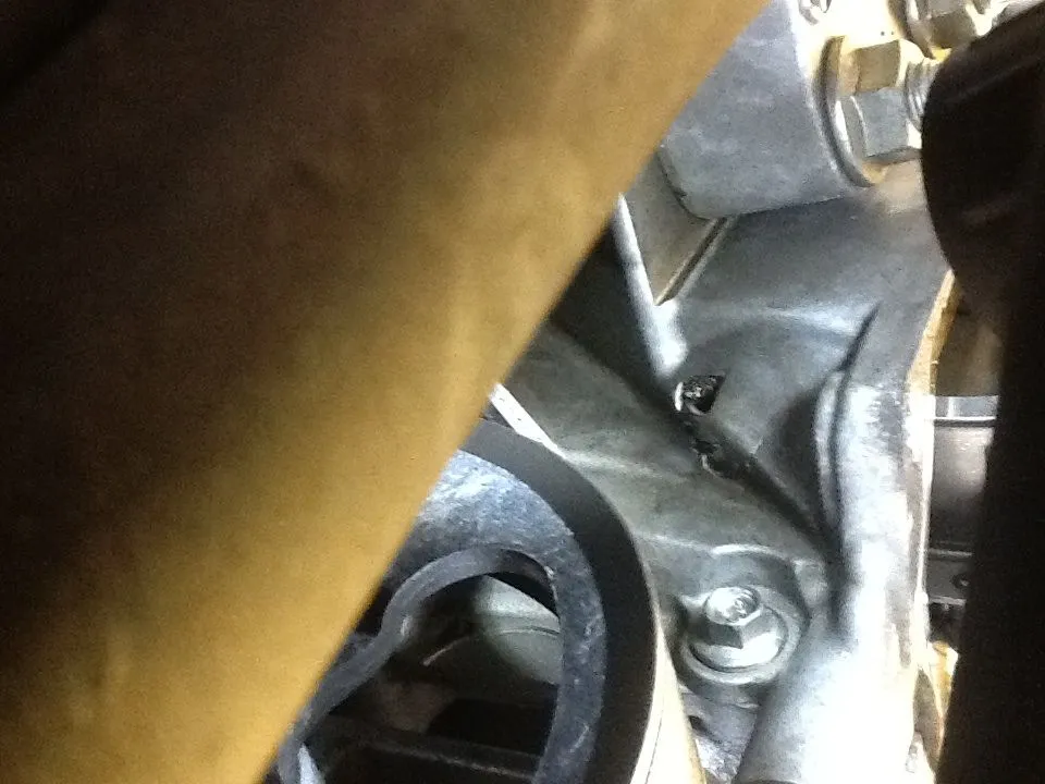

Hello everybody! I have a huge problem! My VVT pin feel out, which caused the bolt to dig into the side of the cylinder head of my engine. The car has 96,000 miles on it, so it's way out of warranty. I was wondering if anyone had a how-to full pulling the head off? Thanks for any help provided!

I have a how to on installing stuff, but removing the head.............removing timing cover, unbolt cams per fsm, unbolt head per fsm, etc.
good time to replace vvt, timing chain and tensioner. you'll need a new crank pulley bolt and all the timing tools to reset everything.
