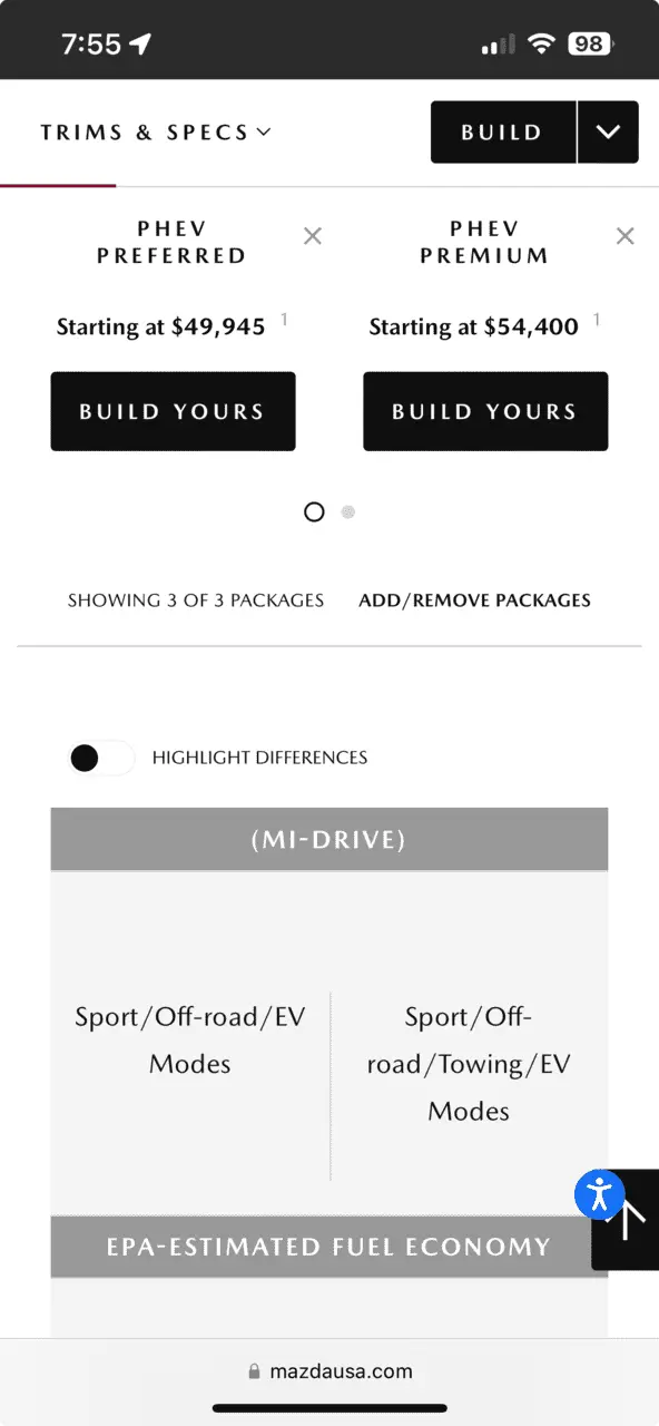

According to the Mazda USA webpage, Tow mode is not available on the preferred trim.

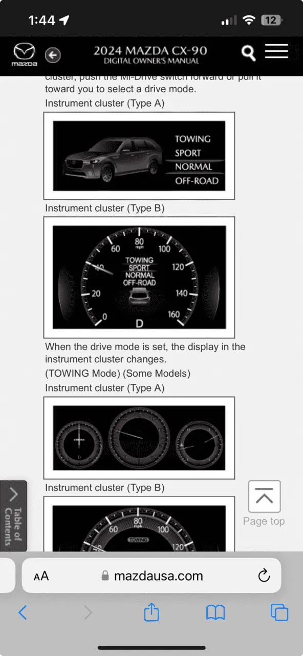

Yes. That is where I turned first, then contacted Mazda customer support assuming that they would tell me since tow mode doesn't show as a option on the Preferred I should use Sport/Normal modes when towing. Their answer was since I got the factory tow package with the harness, that it should show tow mode. https://www.mazdausa.com/static/manuals/2024/cx-90/contents/67220100.html
This is what they referenced, yet they and I were still puzzled as to why it doesn't show up in the Mi-Drive.
Mazda manuals are pretty bad when it comes to model specific features, because they write a single manual with no reference to which vehicle trim as it or not. Also, is the referenced manual from a PHEV ? It looks like it is from the inline 6 version since i don’t see EV mode on the Mi-drive menu.
You can see on the Mi-Drive page refered in the link that it says (Towing mode) (Some models). This means that some models would not have it, but doesn’t really say which ones. Based on my experience with Mazda manual I would lean towards the preferred trim not having it. But it does also say that it only show up with a trailer connected and that it can takes time to show up. So maybe it is there and not showing up.

i checked and the manual referenced is the wrong manual. But the PHEV manual says the same thing, so no harm done there.
Yeah. Just checked the PHEV manual and same info. There's no physical issues towing yet, but if I am supposed to have a feature for towing that would interfere with a weight distribution hitch or should be towing in a specific non tow mode Mi Drive setting it would be nice to know.
Tow mode is only on Preferred Plus and higher. Adding the hitch won't activate the option in the software.

Yeah, I believe that even though I added the hitch and the harness from the factory order an not at the dealership. My issue is that the manual is incorrect for the PHEV preferred trim, and Mazda support says it should be there because of the factory harness. Finally leading to the question of OK if it's not supposed to be there what Mi drive mode am I supposed to tow in? Or does it not really matter what mode. The irony is there's no drivetrain difference in the trim levels to prevent them from adding it. Probably just software markup.

Spent some time with the vehicle at the dealership on this. Official answer from Mazda technicians on this is: Yes there is not a Mi Drive setting for towing available on the preferred trim level, however as you stated all the important trailer safety features from the TSC are automatically enabled as soon as you plug in a trailer to the harness. They said it doesn't matter what drive mode to put it in other than if you need more power during a hill climb or highway on-ramping you can use sport mode. On a related topic the Mazda brake controller has a flaw in that it is always on causing a parasitic draw on the battery. Right now we just unplug it and then plug it in when we need it.
