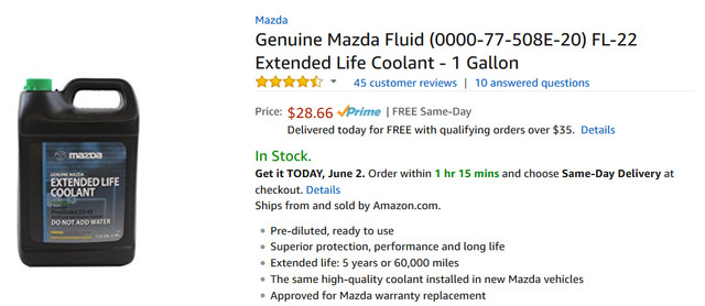

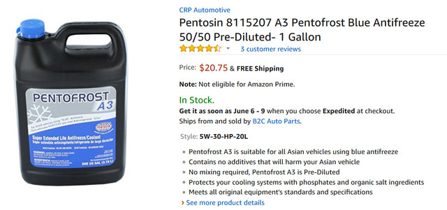

I have a question for the op. I went to rock auto and under the pentosin A2 coolant it says for vehicles that don't use FL-22 coolant. They also have a pentosin A3 coolant which is premixed but the color is blue and it says for vehicles using FL-22 Coolant. Which is the correct one?
just a suggestion.... why not just stick with Mazda brand (no mixing) no guesswork......
costs a little more, but at least you have peace of mind that it's the same fluid Mazda designed for....also, same color if that matters...
for $8 more, I think it's worth getting OEM
Why is it more expensive from amazon. I called the dealer an hour ago and he quoted me 26 dollars for the pre-mixed. I thought it would be cheaper through amazon.

In short, buy Motorcraft Specialty Green VC-10-A2 from Ford or Mazda F22 Long Life. You can also find Beck Arnley or Zerex products with F22 on the label.
You want to use P-OAT non-silicated green formulations. I don't believe there's any issue with Pentofrost A2, but I will research it further to be certain.
Pentosin Antifreeze Update
Kornholio and Rock Auto are correct!
I spoke with Pentosin tech support today (very nice folks BTW) and they confirmed that the FL22-compatible product to use is the Blue A3. It must be used only after a complete flush. They apologized for the lousy info on their bottles and website.
Pentosin A2 is indeed for older Mazdas NOT using FL22.
Since my water pump project is only a couple weeks old, and there was precious little original coolant left in the system, I am not too concerned with gunk buildup or seal damage.
Looks like I will be flushing and replacing my coolant today with a F22 product. Yay! I will now have one heck of a clean coolant system.
