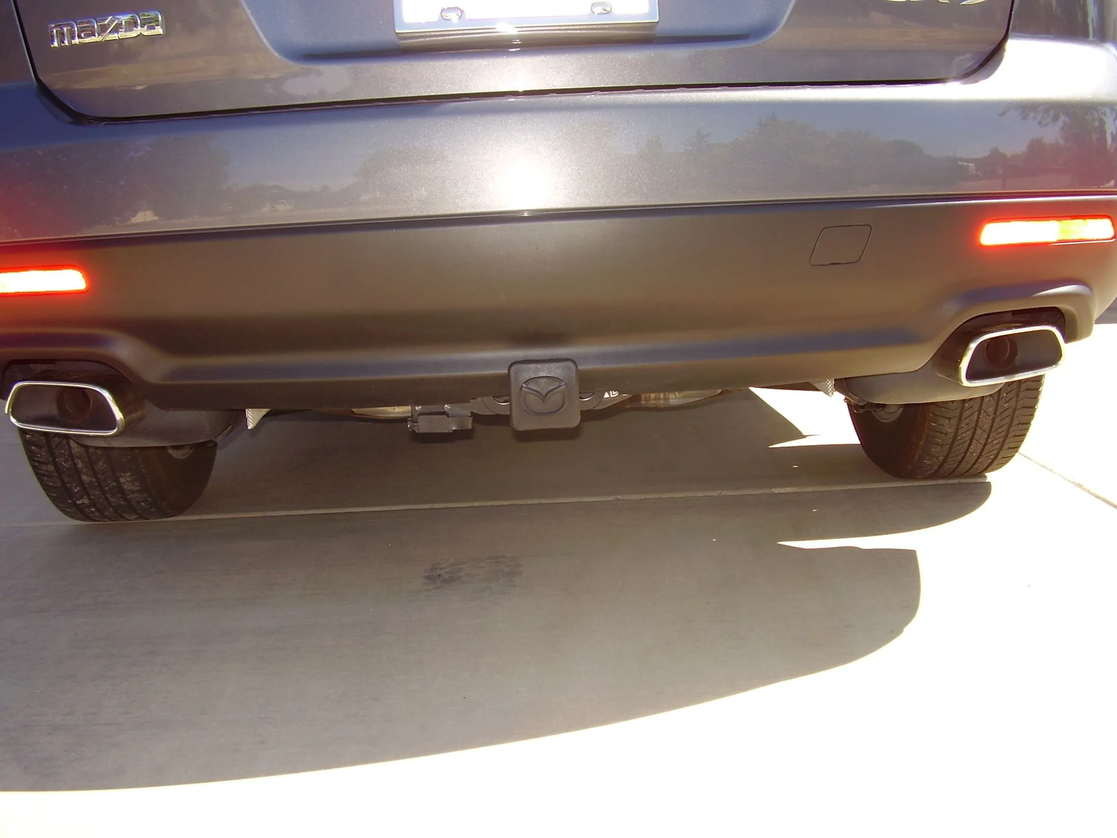

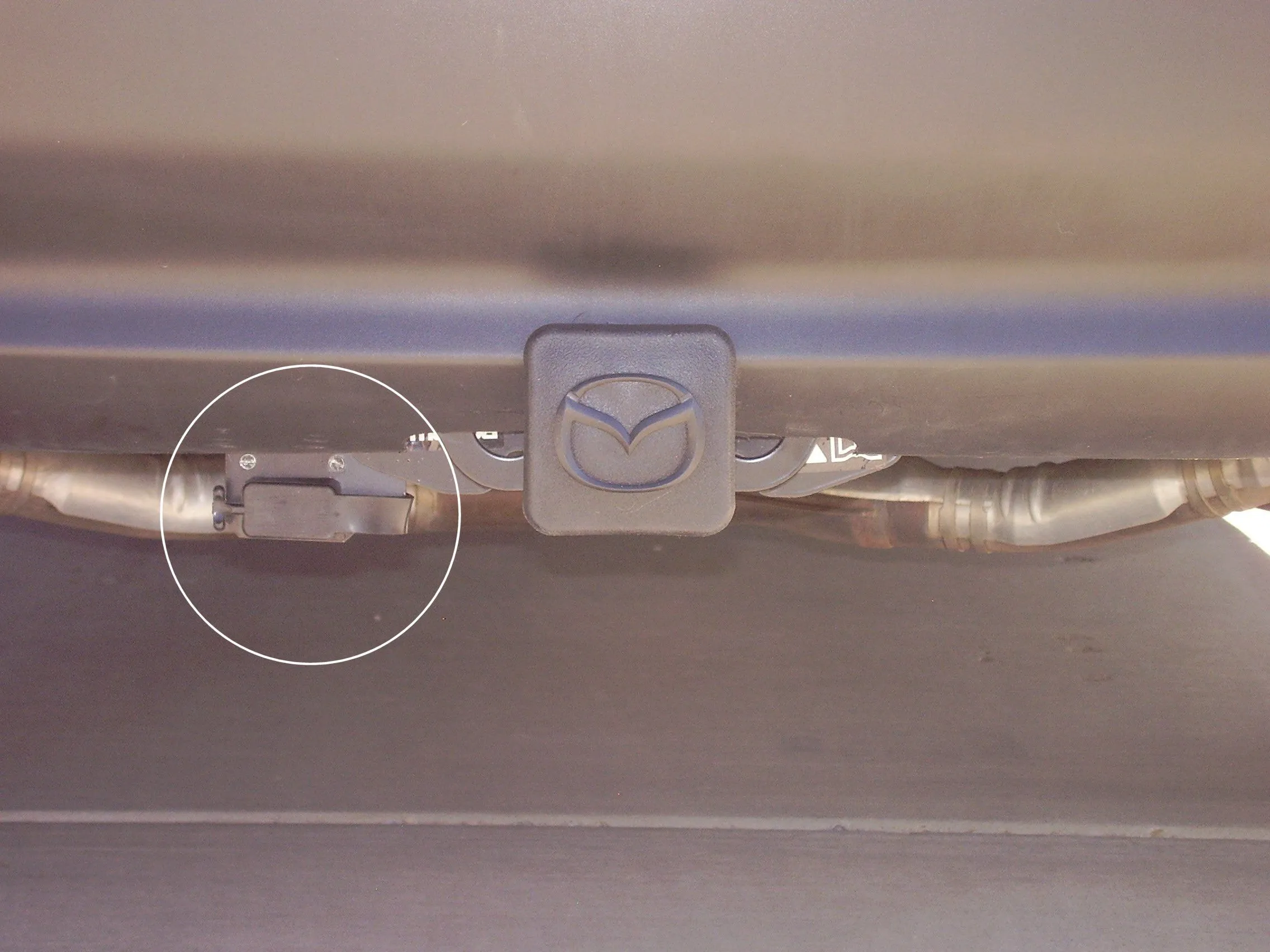

It was surprising easy to install a wiring kit. I also added a factory receiver since it's the only 1 1/4" for the CX9, and fits all of my accessories.
