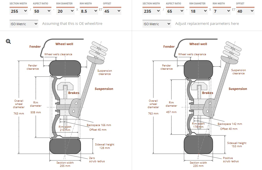

I find a set of winter tires which is 235/65R18 with offset 40. The tire size and PCD, and Hub bore are perfect. However I don't know if the offset 40 is ok for my 2022 CX-9 GT, anyone has experience about 18'' tires offset? Thanks!
Feedback: 235/65R18 with offset 40, rim 7J*18, work perfectly with my car. BTW, this web is very helpful to change tire or rim: www.wheel-size.com
Generally, you do not want offset to be more than +-2mm. Some sources state a max. of +-5mm.
While the wheels and tires you describe will fit with no issues, I would suggest to stay in the range of 43-47mm, 8" wide wheel.
While the offset is pushing it, it's still acceptable. While it fits no problem, 235 is a bit large for a 7" wheel.
The set will work, but it's not ideal.
Thanks for your advice. Yes, it's closer to the brake and disc, and 7 rim is a little narrow for 235 tire. I brought this set of tires from market place from a owner of 2022 Pathfinder, and I didn't have much choices becasue the specs of cx-9's tire is too big to find a perfect one.
