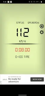

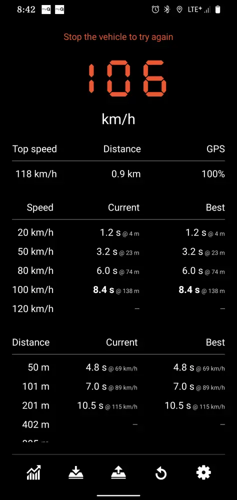

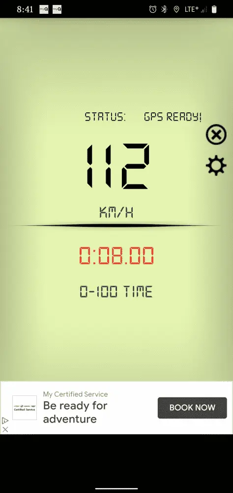

So I've been really looking to figure this out, maybe some input.
I have a 2018 cx9 GT-- lovely vehicle.
When I just got it, I was so surprised by the torque and it's ability to put you on your seat at nearly any speed.
After breaking in the engine, I did a few 0-60 pulls and got between 6.9-7.2 seconds consistently! Right on the reported speed of this vehicle.
About a year after getting the car ,(brand new) I carried it to Mazda for an oil change. The took it upon themselves to update the PCM (engine computer).
I noticed immediately the car felt different and underpowered driving home from the dealer.
Did a few pulls 0-60 using the same app, same roads and using 94 gas.
I'm now getting at best 7.9-8.5 seconds 0-60.
Gas is 94 octane and I just did a fresh oil change to Castrol edge.
Just last week another pcm update was available to I carried it in thinking maybe it'll be better-- nope, still feels sluggish. Car has 68k kms now with newly installed plugs from the dealer, OEM.
New pulls reveal the same numbers to 60.
Tried sports mode, traction off etc and various combinations-- still feels slower than when I just got it.
Note, I tried to keep an variables the same to repeat it he results fairly.
Exact same result, 7.99-8.5 seconds to l from 0-60, a full second more than what I recall when now getting it.
Any ideas?

Just spitballing here, but have you checked the engine air filter? I'm guessing no CELs, but are you able to check for trouble codes with an OBD2 reader?
The engine air filter is a reach because normally, if it's the cause of the problem, it's because it gradually gets clogged and restricts air flow. But if if happened right after the PCM update, I would also see if it is possible for the dealer to "roll back" the PCM's firmware to the version you originally had.
I was not aware of any PCM updates and to my knowledge, my car (also a 2018) is still on the original version it came with.
Something else to check is the tire PSI. Higher PSI results in better fuel economy but worse traction. Maybe the dealer over-inflated the tires when they gave the car back to you?

So who have you talked to about this issue so far? Sounds like you've already brought this up with the dealer, who seemed to write it off as normal (it definitely isn't). Have you spoken with another dealer and escalated to Mazda Canada?
At first I thought that the dealer just did an oil change and a PCM update. But then you mentioned that they changed the engine air filter too? Or did they do that during the second visit, when they updated the PCM again?
Do you have a copy of the invoice(s) to show what version of the PCM they updated it to?
Check your car for trouble codes (or bring it to a shop that can read the codes for you for free). Then I'd suggest checking the engine air filter yourself, to make sure that it is installed correctly. I'd also check your tire PSI.
It’s a long shot but you could check for this issue.
Someone with the turbo engine had a low compression issue as well (I think on the mazda 6 forums). This could be worth looking into.
Hard to pinpoint a single cause. It could be awd being slower to react, it could be brake drag, it could be carbon build up, etc.
Also the car would have better 0-60 time on winter rims in theory, (those 20” are heavy) but I assume your previous runs were in summer as well since you said you kept conditions the same.
What app are you using for your 0-60 runs? I have a 2018 as well but don’t fill up with 94 so I can’t really compare.

I have THE EXACT SAME ISSUE with my 2018 cx9 (70k). After a dealer visit for a routine oil change, where they overfilled my oil, the car was rougher and slower. After they fix the oil level, the performance improved a little bit but the car is not the same as before. It has lost its agility and responsiveness, the engine is definitely rougher, noisier, there are times it feels like it's straining, the turbo noise seems to be louder, cold performances even worse.
When I show it to the dealer they say that they can't feel anything is wrong with it. But the car does not feel and does not drive the way like it used to, I'm kind of at my wits and as to what to do.
Did you notice that they overfilled the oil immediately after the oil change? It's possible that it could have done some damage. If the dealer is absolutely unwilling to help, your next course of action should be to contact Mazda Corporate to open a case. Ensure that you have all of your maintenance records and document everything. See what they think about changing spark plugs (I believe you're due for your 2nd set of spark plugs at 80k mi), and maybe a compression test?
Immediately after I drove home, I noticed a serious drop in performance. I googled and they said to check oil level, it was way over and right then I called to book follow up. I have changed the plugs myself, drove a weak on premium, asked them to test everything. They said they updated firmware as well and checked all sensors. I will get all the documents and proceed to file a case.
The main issue is that it is all subjective, I feel a noticable difference, dealer says 'looks fine'. I wish there was some sort of conclusive measurable proof. Should I do a 0-60 test? Dyno test? I wish I had 2 2018 cx9s side by side to show them.
