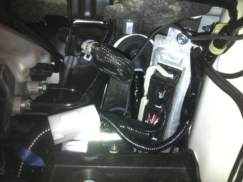

If you want to check out that wire, it should be tapped under the hood at the ECM. Below are a few pics. It's a white wire with a black stripe. You will probably need to pull the battery to gain access.
Here is the ECM and harness. The tap might have some silicone sealant around it and will probably be taped up and have some wire loom around it. So you will need to untape and dig it out.

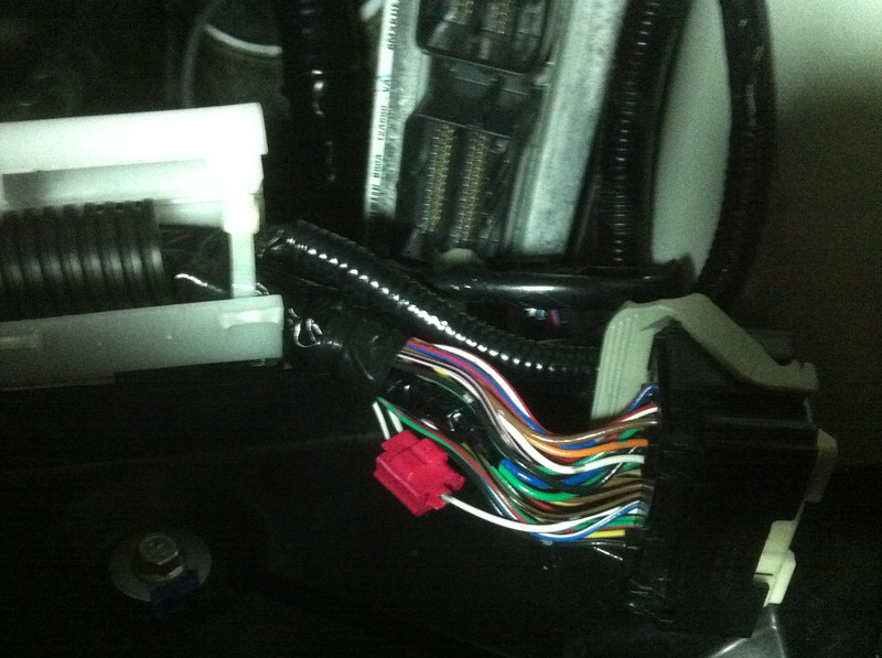

And here is the wire tap on it....
