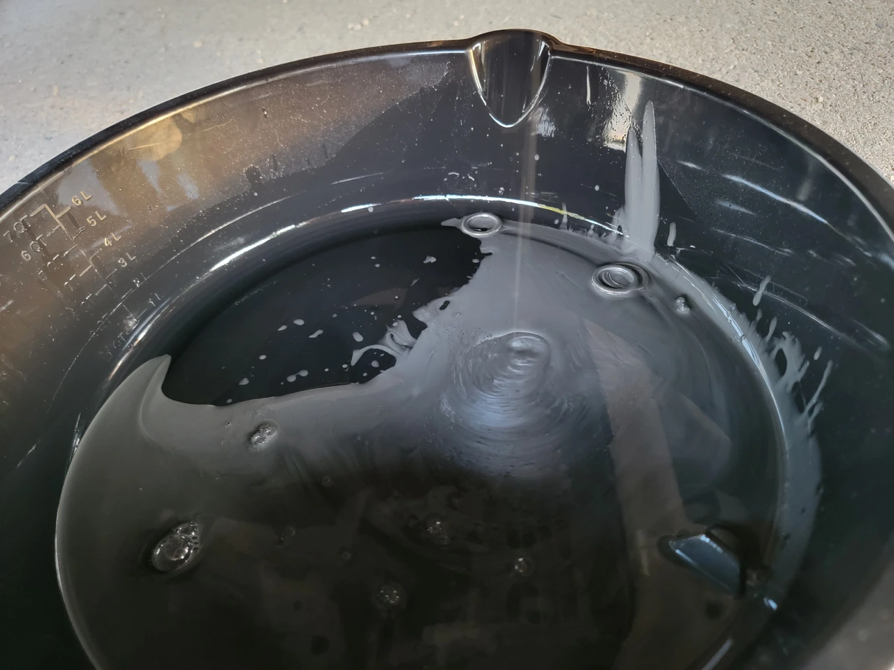

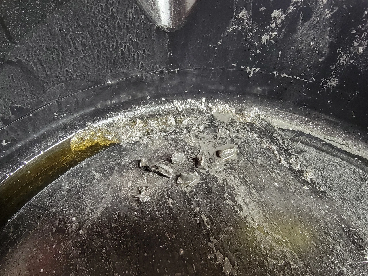

Update: I haven't let this go just yet. Since late Nov I've been going back and forth with the one representative I was able to get a hold of via email. In early Dec the rep told me that Mazda Canada would not be assisting with any goodwill coverage as my vehicle was out of warranty. Despite this, I continued to make my argument that the differential failed prematurely, responding to each email politely arguing my point, despite numerous attempts from the rep to get me to give up. I would estimate that we exchanged emails maybe 2-3 times a week, excluding the holidays.
After a few requests, the representative finally agreed to forward my case to their management team for review. I got an email today saying that they will be contacting the dealership to set up an appointment where I can present my CX-9, my service logs, receipts for parts, and the differential fluid and metal chunks for inspection. I will have to pay for the diagnosis/inspection, but I'll happily pay if it means them taking my concerns seriously.

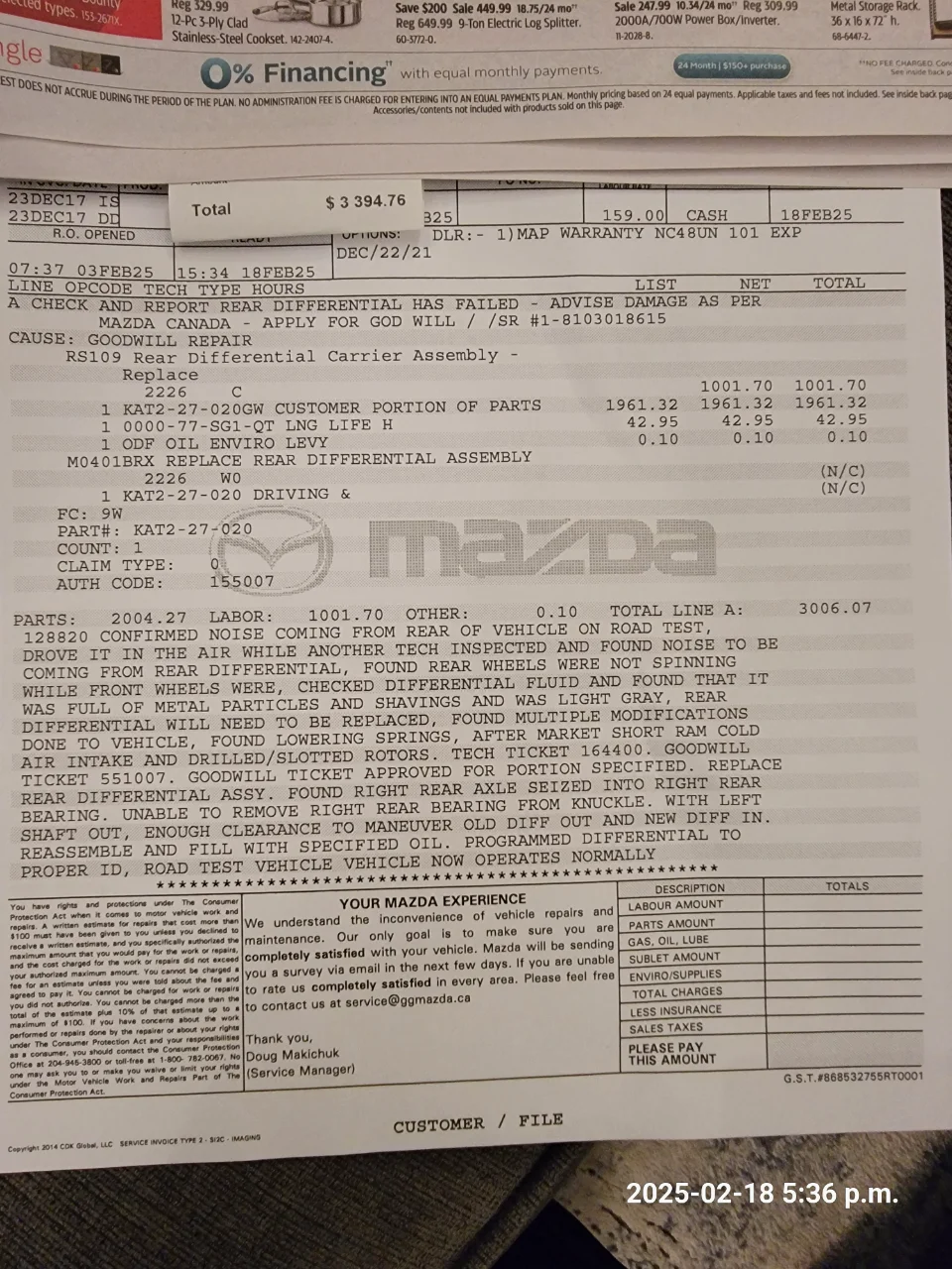

Rear diff replaced. They got it done in about 6-7 hours yesterday. Here's a picture of the invoice I received. They showed me a printout of the $2650 CDN goodwill coverage that was authorized by Mazda Canada, but I didn't get a copy of that. It appears that the $2650 was discounted from the list price of the rear differential assembly, and I paid the remainder, plus labour.

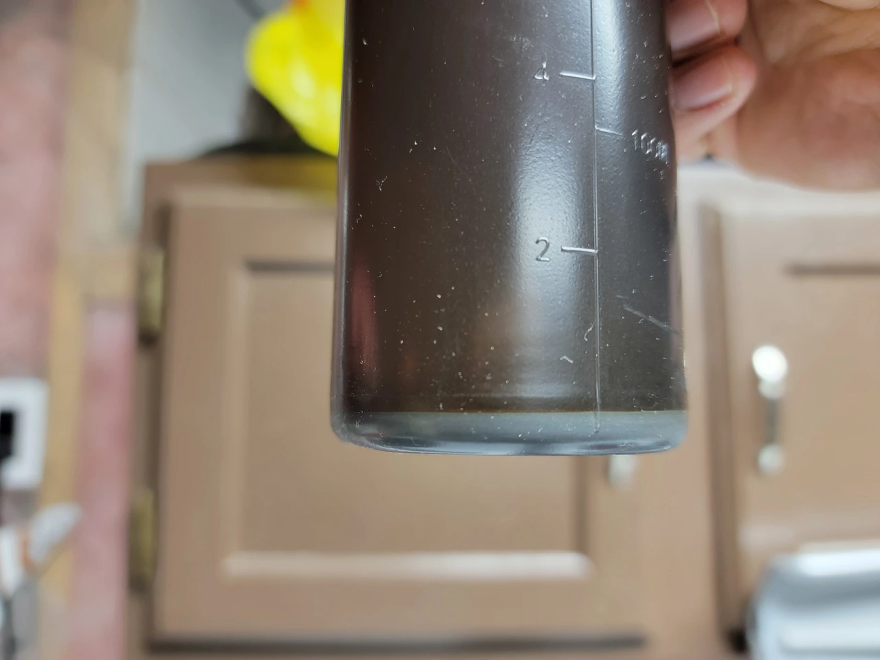

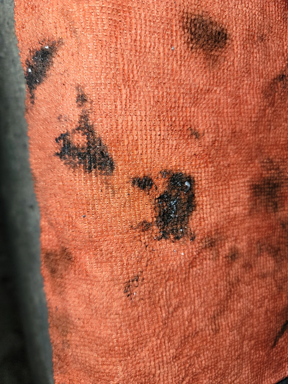

Mazda Canada (and the manual) says that the differential fluid should only be replaced if the rear diff is submerged. However, they also say that rear diff fluid should be inspected at every service interval (every 8k km/6 months) and changed as the fluid "becomes dirty". They say that dealers inspect the rear diff fluid at each service.. but I'd bet money that they don't.
I take this to mean that the fluid is definitely not a lifetime fluid. I was advised to drain a bit of fluid to inspect at each oil change, which is annoying because I'd have to change the washers and top up the fluid every time. But there you go. According to Mazda Canada, there is no specific change interval for diff oil, but we're expected to check it periodically and replace as needed, even though the manual says nothing about inspecting the fluid.
