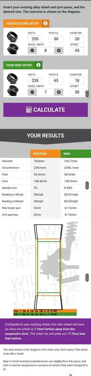

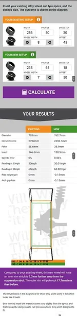

Hi all! I recently purchased smaller tires for winter 235/65/18, 7" width. Based on wheel-size.com they will fit no problem. The issue I have is rims offset. I purchased a second hand alloy wheels that came from Mazda3 - 18x7J 5x114.3, hub bore 67.1. So those numbers are fine, the only difference is offset - OG 45mm, the new rims are 50mm.
I'm not sure if it's safe to put them on. Will those 5mm make a huge difference? Anyone who faced similar issue?

From your screenshot i think you should be fine. The different offset pushes the rim away from the car suspension components and the narrower wheel offsets it and prevents it from sticking out.
