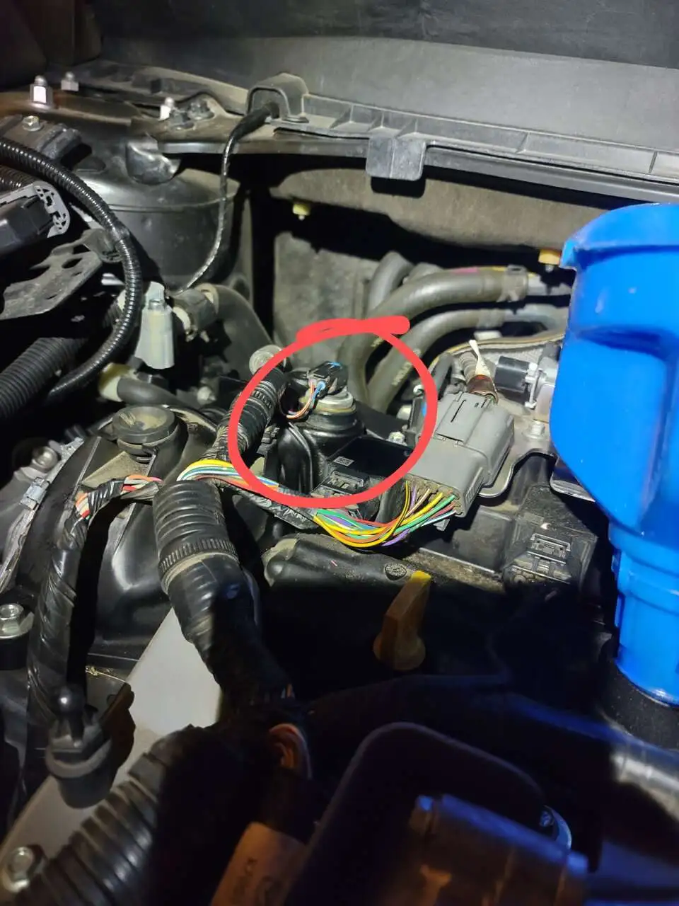

Changed the oil tonight and noticed a small amount of oil on the front of the engine. Traced it to a sensor going into the valve cover. Going to order a new grommet, and replace it. Engine has 116k miles on it. Change the oil every 3k miles due to consumption from the turbo.

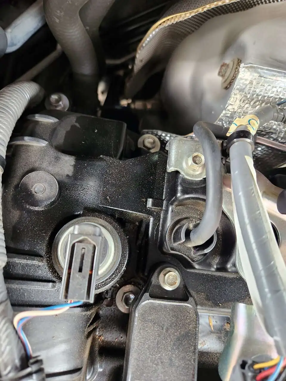

Currenty have a big leak from that on my 2020 GT and a smaller leak on my 2021 Sig. That is NOT just seepage. At the dealer for this and 10 other issues right now.
Let me know what they do for that. See if you can get part numbers. I'll do this myself. Side effects of turbos. Lots of pressure it's gotta go somewhere. Had a turbo Miata for a long time. Had similar issues.
"known" issue. My original engine seeped. Same issue with my new replacement engine. Just wipe it down every oil change.
If you want to change it, the cover needs to come off.
Will do and let everyone know.
MAHLE B33646. Mine is moist too. 2022, 12K Miles. If it gets worse I will dyi it with a non mazda gasket because we know those leak almost immediately. Will also put a THIN film of Toyota FIPG 103 on it
Just an update on my oil control vvt solenoid leak. Dealer replaced the entire valve cover for the repair, not just gaskets. Here is the part number on my invoice:
PY8W-10-210B

PY8W-10-210B. Yea, that looks like the entire valve cover..... gaskets too. My guess is the B on the end indicates a revision
