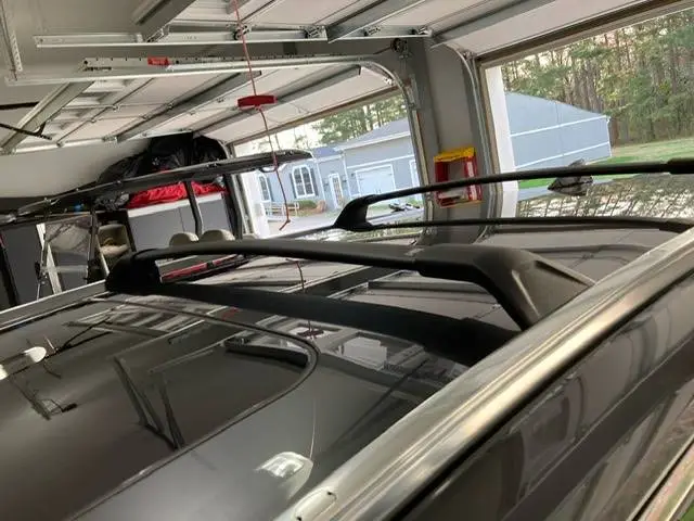

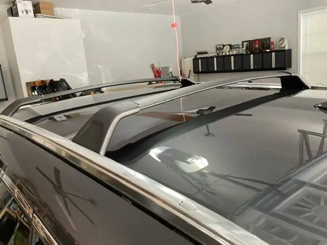

Installed the OEM cross rails this past weekend. I purchase them through Mazda Swag online. They’ve been great to deal with. Even with shipping they were cheaper than picking up locally. My dealership is hit or miss on discounting accessories.
Installation wasn’t difficult but tightening the Torx screws was tedious because they’re tucked down low. Of course I didn’t fully read the instructions and if I did, I would have seen they recommended using a swivel socket with a Torx bit. That would have made things much easier.

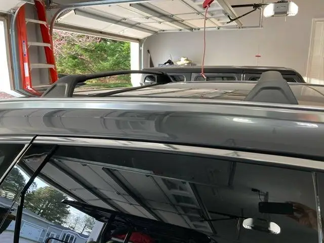

Posted an extra pic here from the rear. You can see that the rear bar is a little taller than the front. Because of the sloping roofline, it needs to be so anything mounted is level.
The bars are solid, look good, and the instructions said they’re rated for 209 lbs combined weight, evenly distributed. They’re mounted roughly before and aft of the rear doors so they’re not far apart. With the CX-9’s raked windshield, sloping roofline, and hatchback-esque rear lift gate, theres’s not much roof up there I can see how some people would have trouble with long items up there. We’ll mostly use it for a smaller basket and a soft cargo carrier for extra luggage room so hopefully it won’t be a problem for us.

Looks good. I installed mine this weekend also. Interesting to see that yours appear warped as well in the picture. Some kind of optical illusion. (I looked at mine from several angles and finally decided they were fine. Mine looked twisted.)
I actually did try to use the torque wrench and swivel socket thing, but it didn't work. The adapters are too fat. You'd have to have a T-30 adapter that was almost as long as the provided wrench.

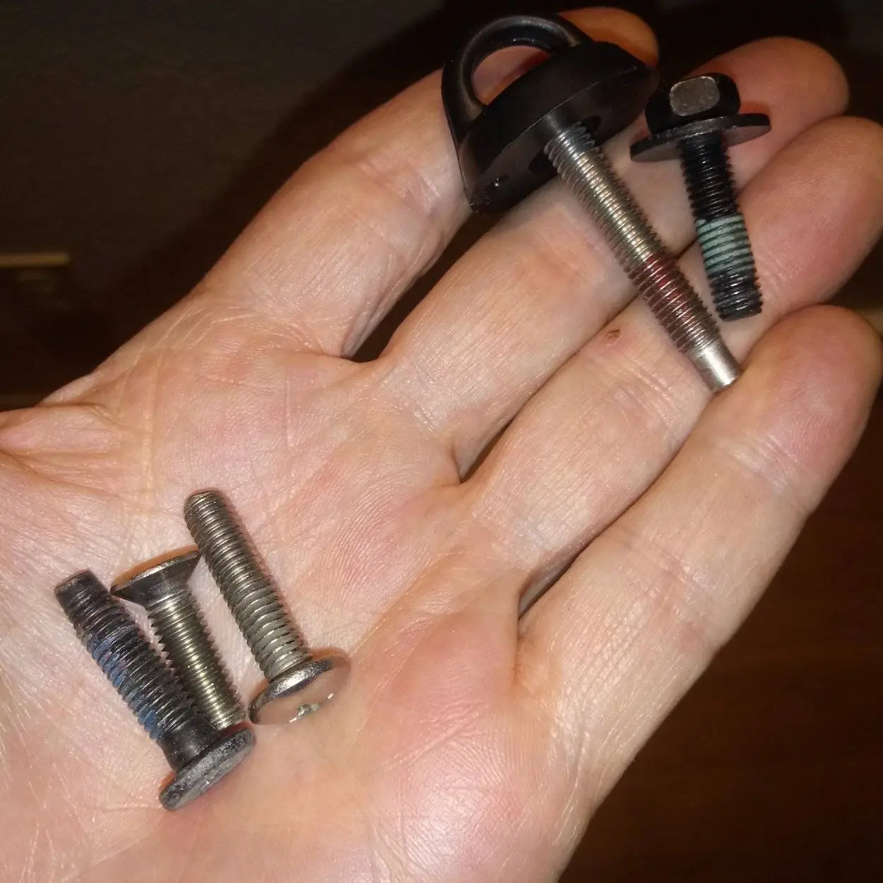

Try to get the unique bolts from a Mazda parts counter. The bolts have an M6-1.0 thread, but they're big head shoulder bolts. The head is 16mm diameter. The shoulder is 9 mm diameter x 4mm long (it might need this shoulder to fit snuggly into the feet of the crossbars), and the threaded shank is 14mm long with a 3mm long unthreaded tip to guide the bolt into place.
These are all 6M and can fit the holes in my roof.
The two odd ones came with my 16.5 cx5 -- the loop top is for the adjustable crossbars.
The other three either came with another car or the hardware store. They have stainless steel at some stores.
The other three either came with another car or the hardware store. They have stainless steel at some stores.View attachment 298485
FYI ... The very bottom screw looks a lot like the ones that came with the hardware for my cross bars.
I am pretty sure I could get the roundhead Phillips stainless screw to work with the addition of a washer. The black oxide screw might work, too.
