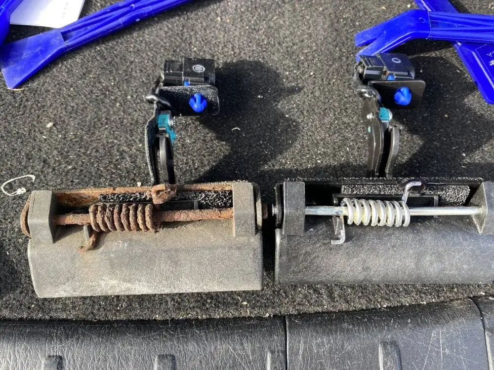

I have a 2012 C2X-9. Lift gate handle got sticky. I took the trim off of the inside of the hatch to get to the latch and found the latch axel all rusted. I took it apart which required cutting the head off of the axel, slide it out and lubed it up. Worked for a year and happened again. Took it all apart and replaced the axel with 5/32” drill rod and two speed nuts from hardware store. Gave it some lube and I think it will now last another 100 k miles. The damn latch is like 150 bucks. Poorly designed and very overpriced.

So I guess this is why my old liftgate handle wasn't working :) I have the power liftgate. Replacement handle from realmazdaparts.com
Wasn't too bad, the hardest part is finding suitable replacement for broken clips.
