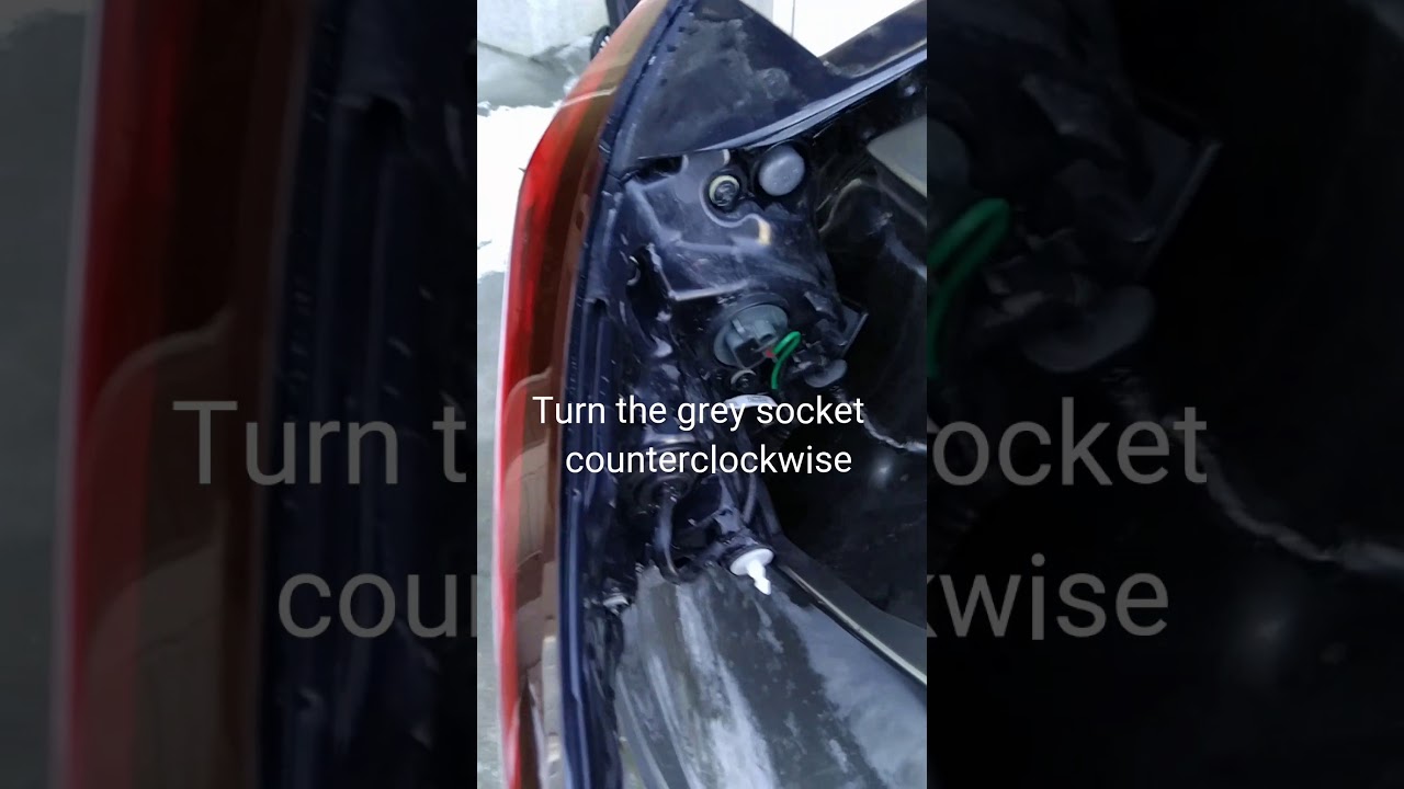

Here's a link to a resource I wrote for replacing the rear turn signal bulbs.
And a quick 2 min video showing the process.
The steps include how to remove the tail light (partially). It looks like along with removing the turn signal bulb harness, you'd need to remove the harness for the LED halo/parking lights, and I'm not sure how that comes out. Worst case scenario, you cut open the harness and splice the wires from the old harness into the harness of the replacement lamp.

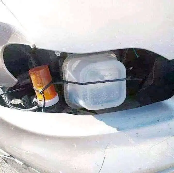

Seems like I rushed a bit... just got a lead for a better fix :)
